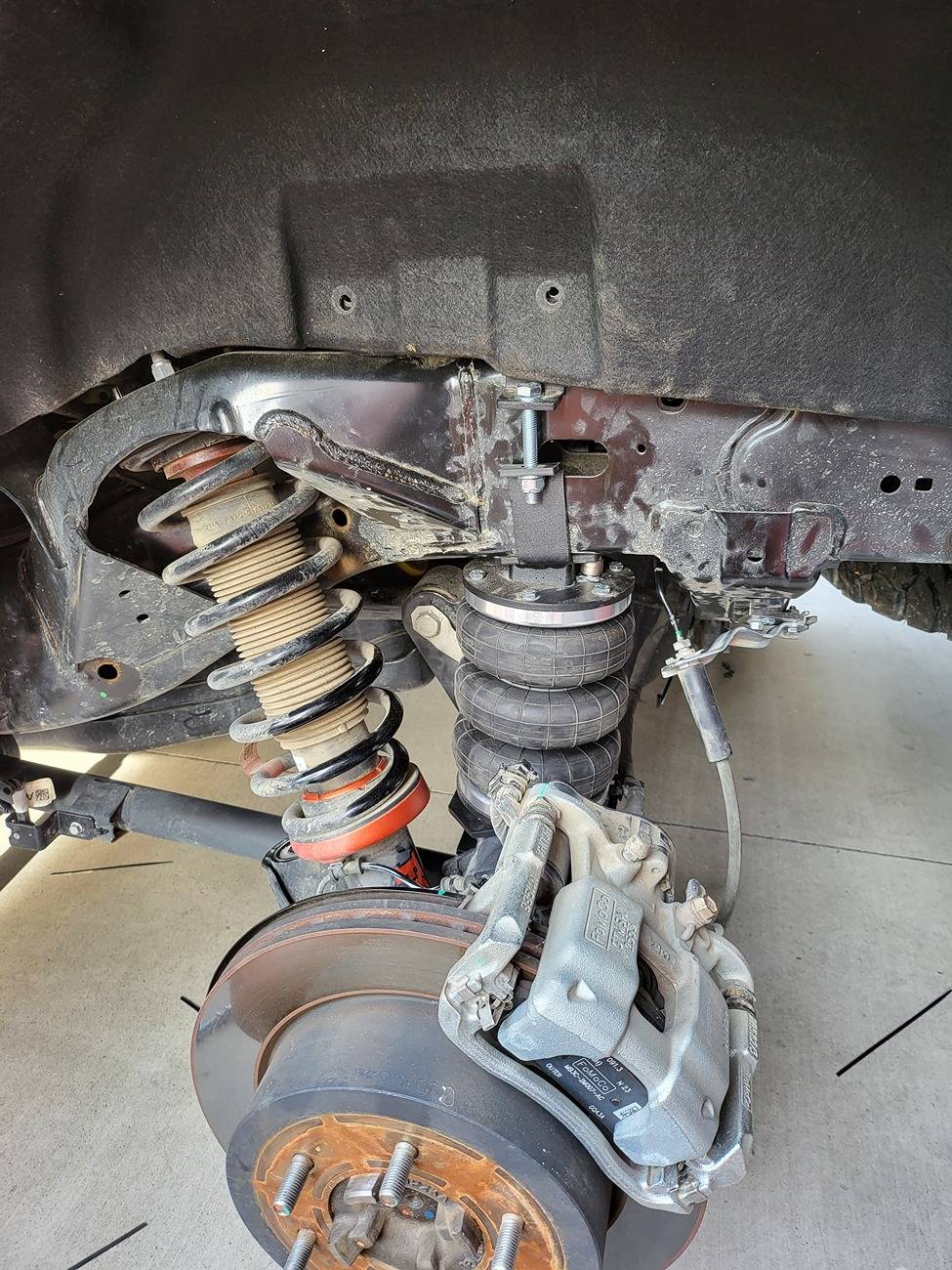

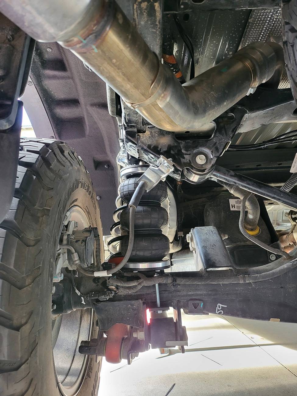

Added some airbags from AAA Suspension and also installed the included equalizing switch.

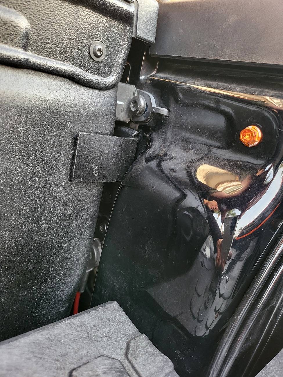

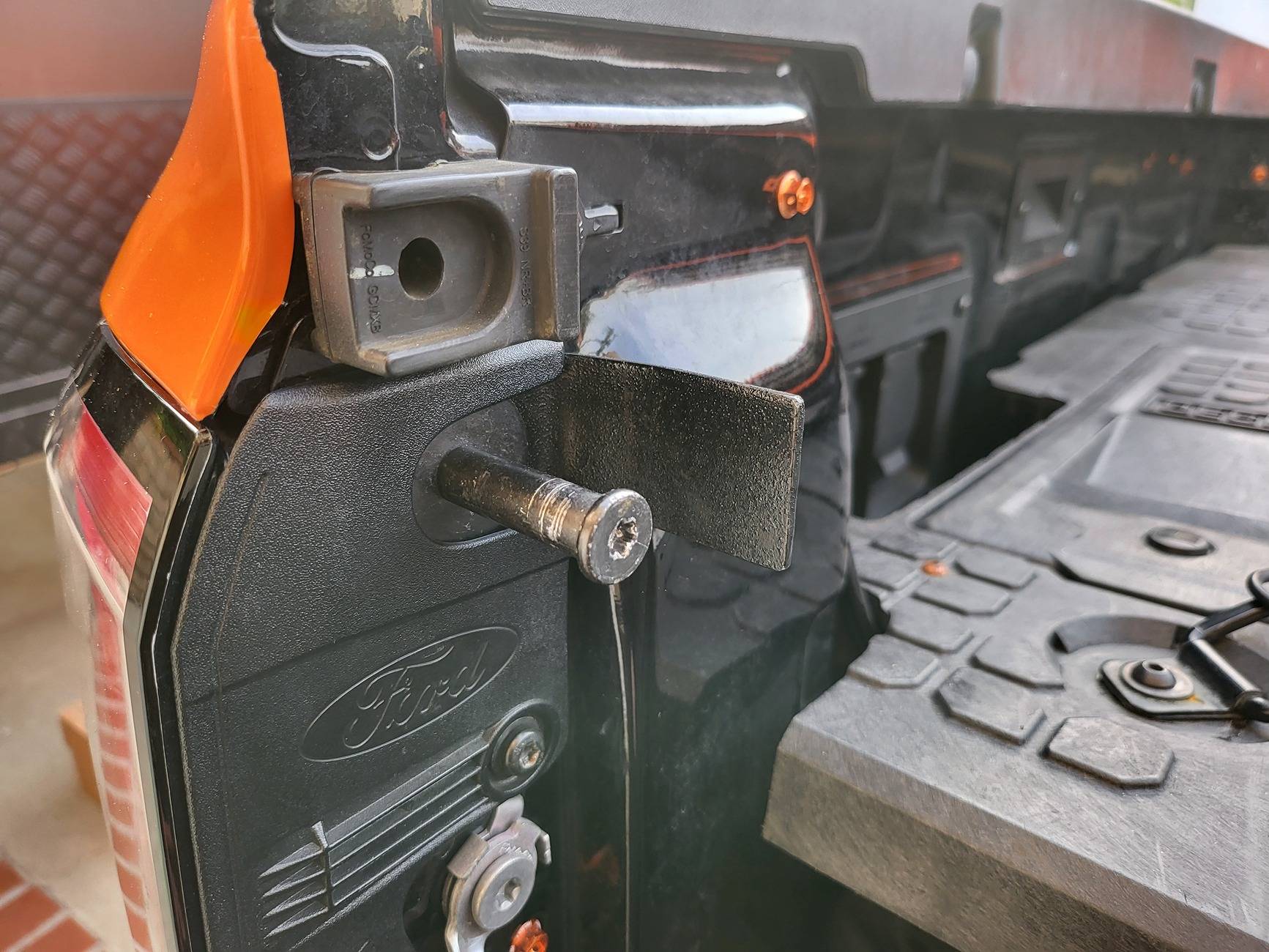

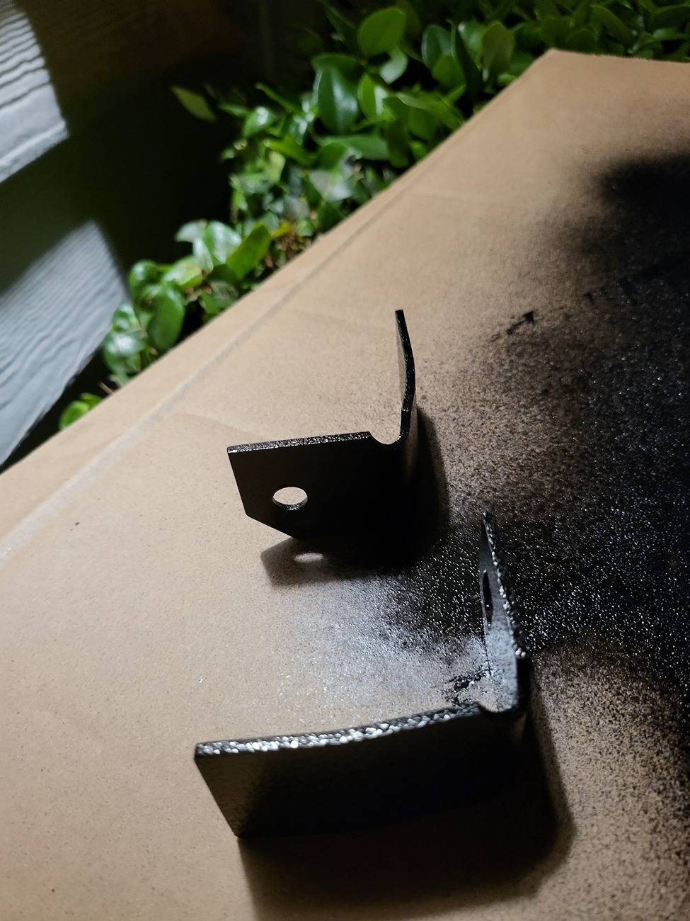

Do you have pictures of the passenger side? I am about to install this kit and it looks like the Australian passenger brake bracket is different than the US bracket. So the relocation bracket may not be needed?
Someone else mentioned they didnt use it. I threw it on anyway and there's still plenty of clearance from the wheel.

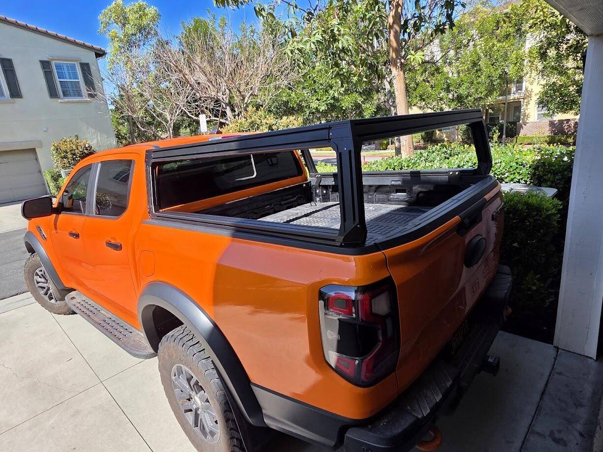

Contemplating doing some of the sunrise orange wrap like yours. How has it held up?
So far it's been about 2 years and 21k miles. No issues at all. The light pinstripes from going through bushes heals up quickly.
I only have 1 major scratch and it's from dropping my bed rack onto the outside bed of my truck when mounting it. It went through the wrap and dented it. I cut off a part of the wrap that was wrinkled and just left a hole there to remind myself not to do stupid things. Still looks the same since it happened early last year.
Thanks for the reply. It looks fantastic.
I'm right there with you on the reminders not to do stupid things as my recent front end "issue" will be my thing not to do again.
