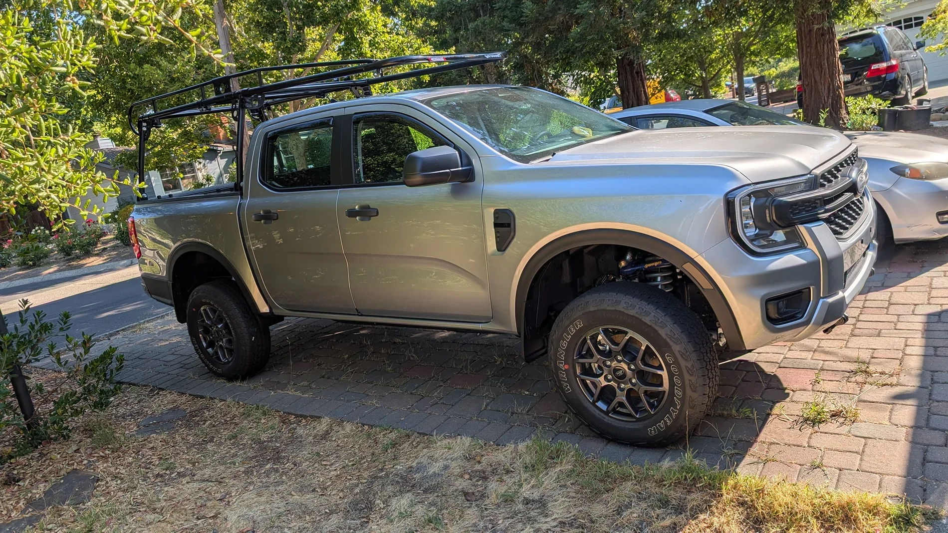

It's a debadged STX and I ended up backing off preload collar 2 full rotations or 1.5mm per for a total preload measure of 102mm vs the 105mm factory set. I'm glad I did because I got 75mm ~3" of lift at that preload. Overall I'm pretty happy and will post some photos when the project is " complete"
Did you add the Eibach rear shocks? I just picked up a '25 Ranger XLT and want to add 2.5" to the front but keep the back an 1" or 1.5" higher for towing. Trying to decide if I want the resivor shocks or smooth sport ones. May need to add a 1" block to the rear to get that little bit of rake. Any thoughts?

Certainly, Thanks for asking. Yes I added the Eibach pro 2r resi rear shocks along with 3/4" blocks because that was the absolute most I could get out while still retaining the factory hardware u-bolts, I also installed the BDS shackles lift kit. The only thing I might do in future is add the Bronco Goodyear "35's" but that would probably be down the road. I would recommend going with the 2r resi rear shocks, it's a small price increase but they ride nice and look well designed and built.

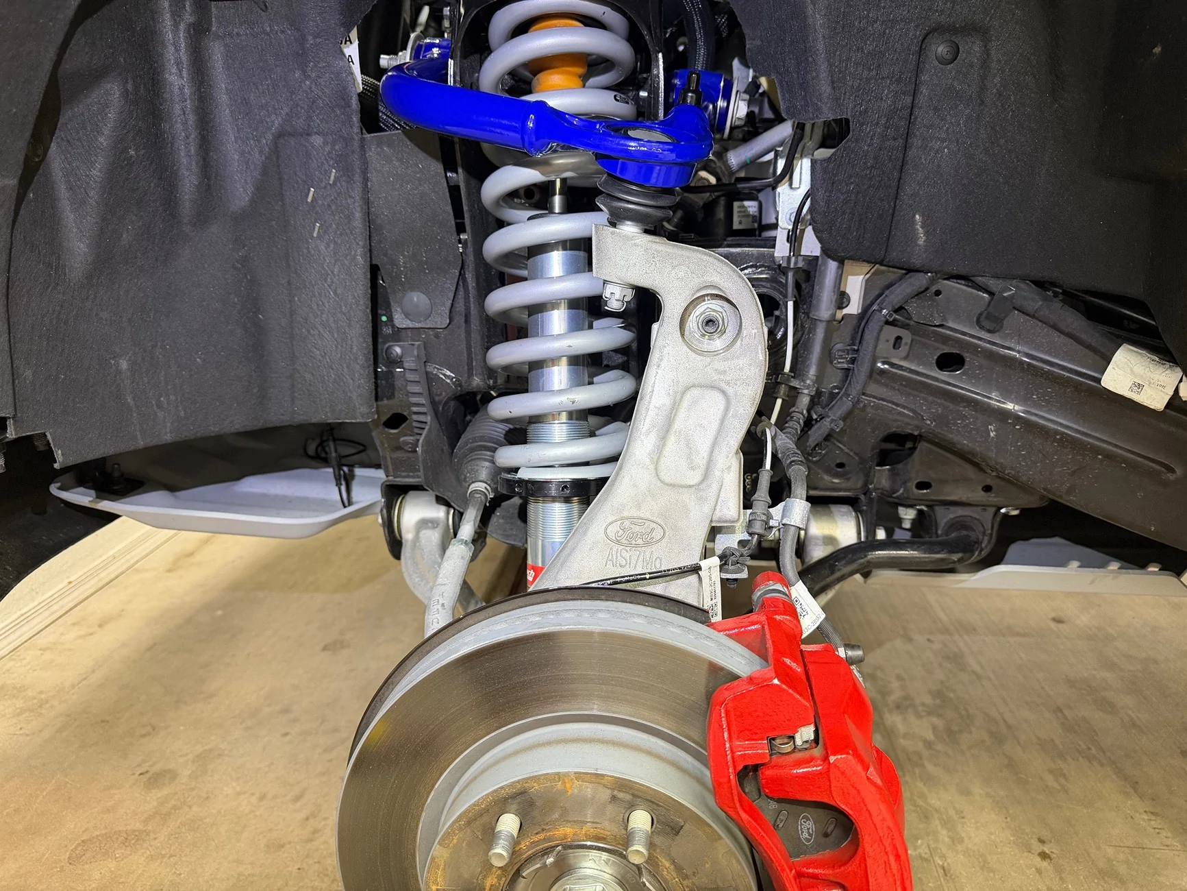

Finally got around to installing my set of SuperPro arms.
Rearly happy with how easy the install was,and the fitment.
I goes to alignment in a couple of days to dial it in.
Total knee replacement slowed me from getting them on the truck,been staring at them in the box for the last 2 months LOL

that blue control arm looks cool, like the same blue on their rear sway bar, which also looks cool :)
I’m probably going to pull them when time allows and powder coat mine red.
I wish they had color options available 😉
4,072
3,938
for sure, to match the caliper
And a few other red accents that the truck has lol
Or if the blue grows on me,maybe some Shelby blue stripes,and a caliper repaint 🤣😂

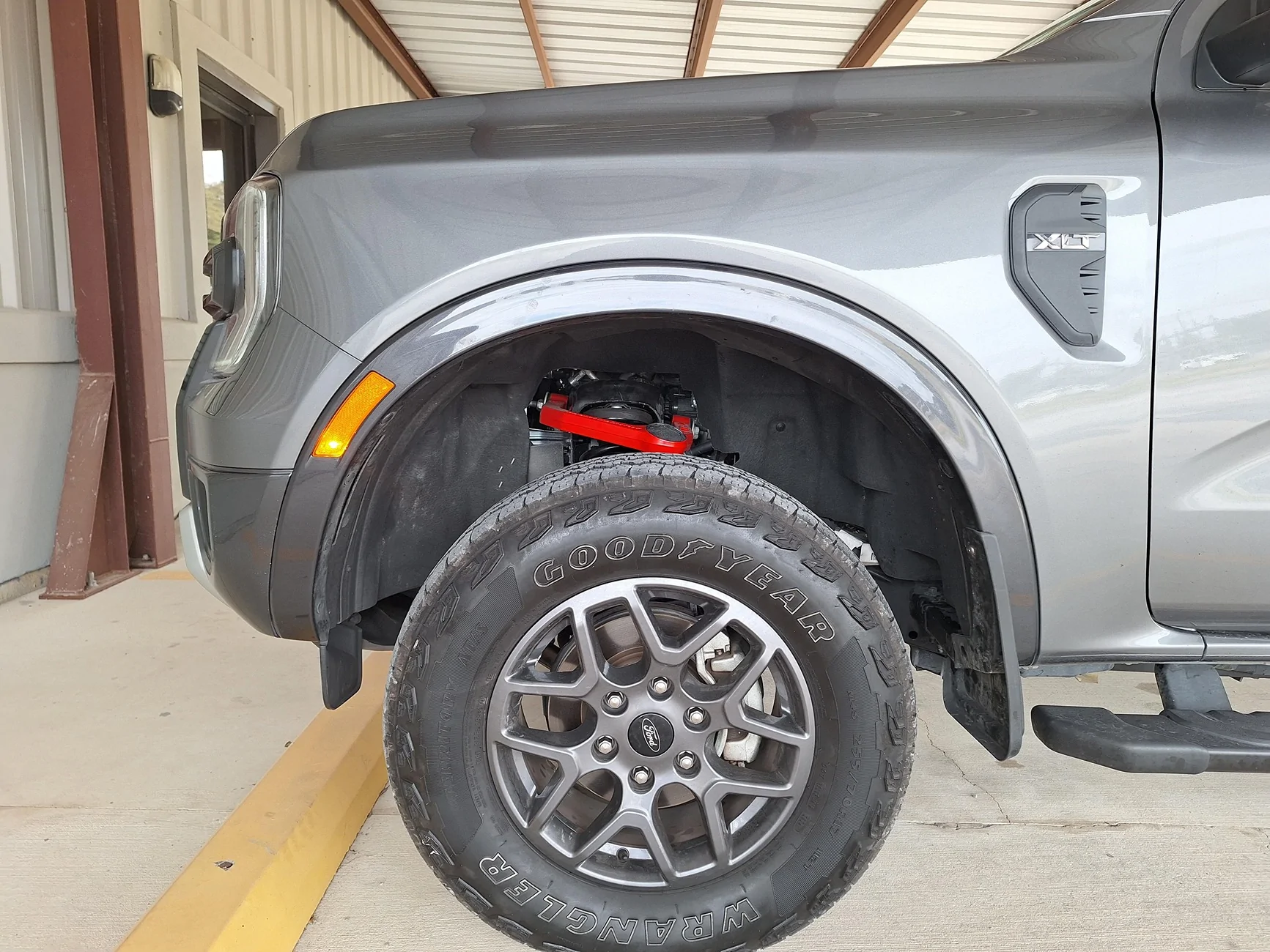

But I wanted red, so I went with Rough Country forged aluminum. These are OEM spec, but they do have some with offsets.
