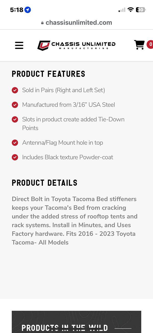

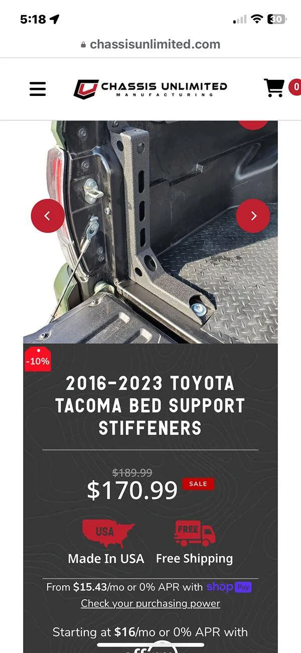

Okay, I was not happy about the J brace thing and I still think FORD should recall/reimbuse those that have already done it. But HOLY SHIT, look at what they are selling for the TACOMAS!!
Unbelievable, but they try and sell like it gives you an extra tie down.

This really isn't that crazy. They sell bed stiffeners for most trucks. On the F150 Raptors if you do a ton of off-roading the bedsides will actually start to separate if you don't have these bed supports. Definitely not comparable to the J-brace issue

The back of the bed is an open structure so needs to be pretty strong otherwise it flexes excessively. The front of the bed is a more solid closed in structure so generally not a problem. It's like convertible vs hardtop. Toyota has had this issue for a long time, they don't see it as a problem.

The very first year Toyota made a truck, I saw one at the local auto show and I noticed how the sides were wobbling with the tailgate open, more than any other truck I've seen. Cant believe it's still an issue. But yeah, like Dillon M said, this is not uncommon. If you have a box with no top and you remove one side, the two corners closest to the open top of the removed side, will be somewhat flimsy. Its not a design issue, it's basic physics. I wouldn't mind something like this for my Ranger Raptor.
