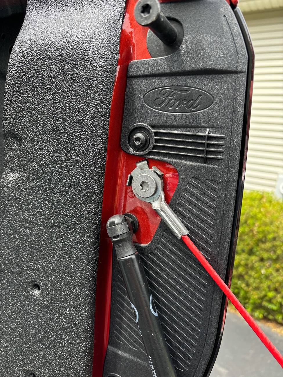

Every 5-6 closes of the tailgate results in this cable being exposed like this. Any ideas on how I can eliminate this from happening?

Same. Have tried to bump the damper over (because that's what appears to be causing the problem). Looking for a spacer to act as a busing....but haven't found the right sized yet.

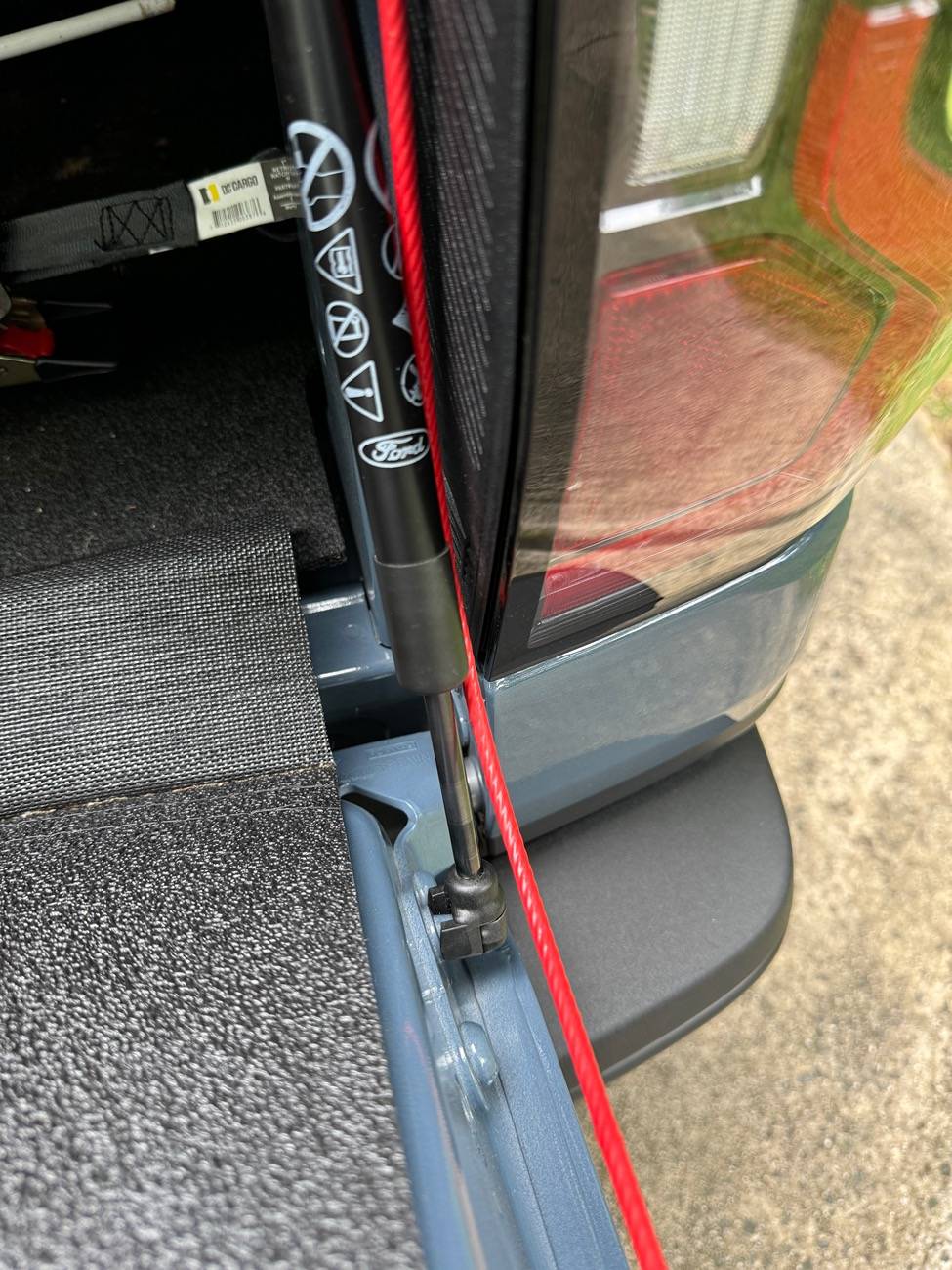

So no dice on flipping in the alternate direction the plate fits into a slot in the bed. Also interesting note there’s an open thread for a second dampener on the lest hand side I never noticed. I might find a bolt to shove in there.

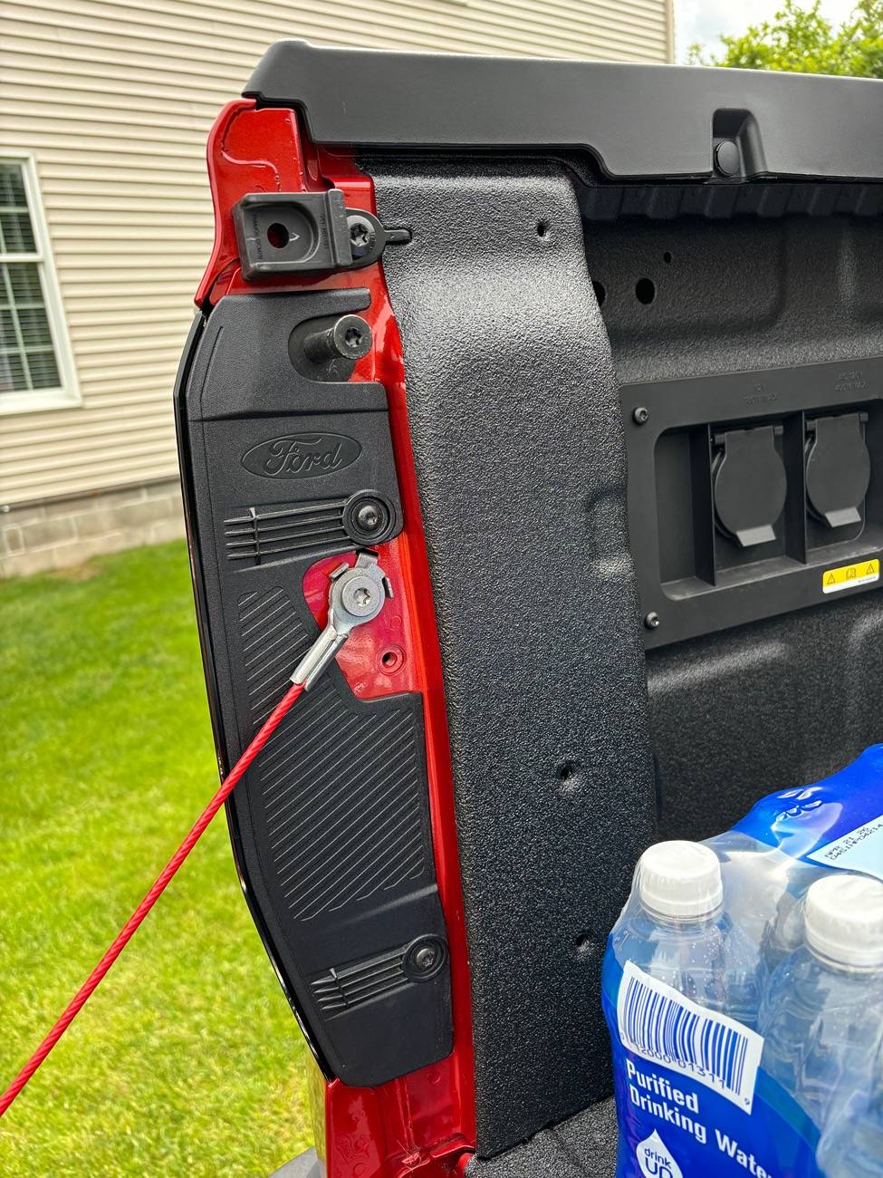

Also since my rear end is getting so much attention, some obligatory rear end shots.

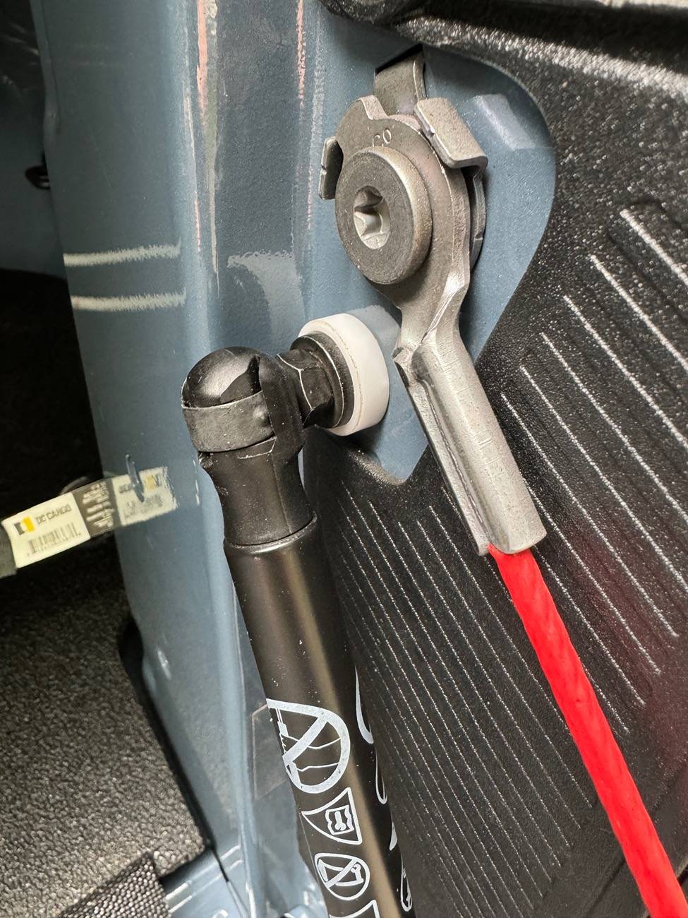

Added a spacer under the top mount (plenty of length) which pushed the shock out far enough for the cable to slide by, and no longer hang out. I'm sure Ford will make an adjustment going forward
