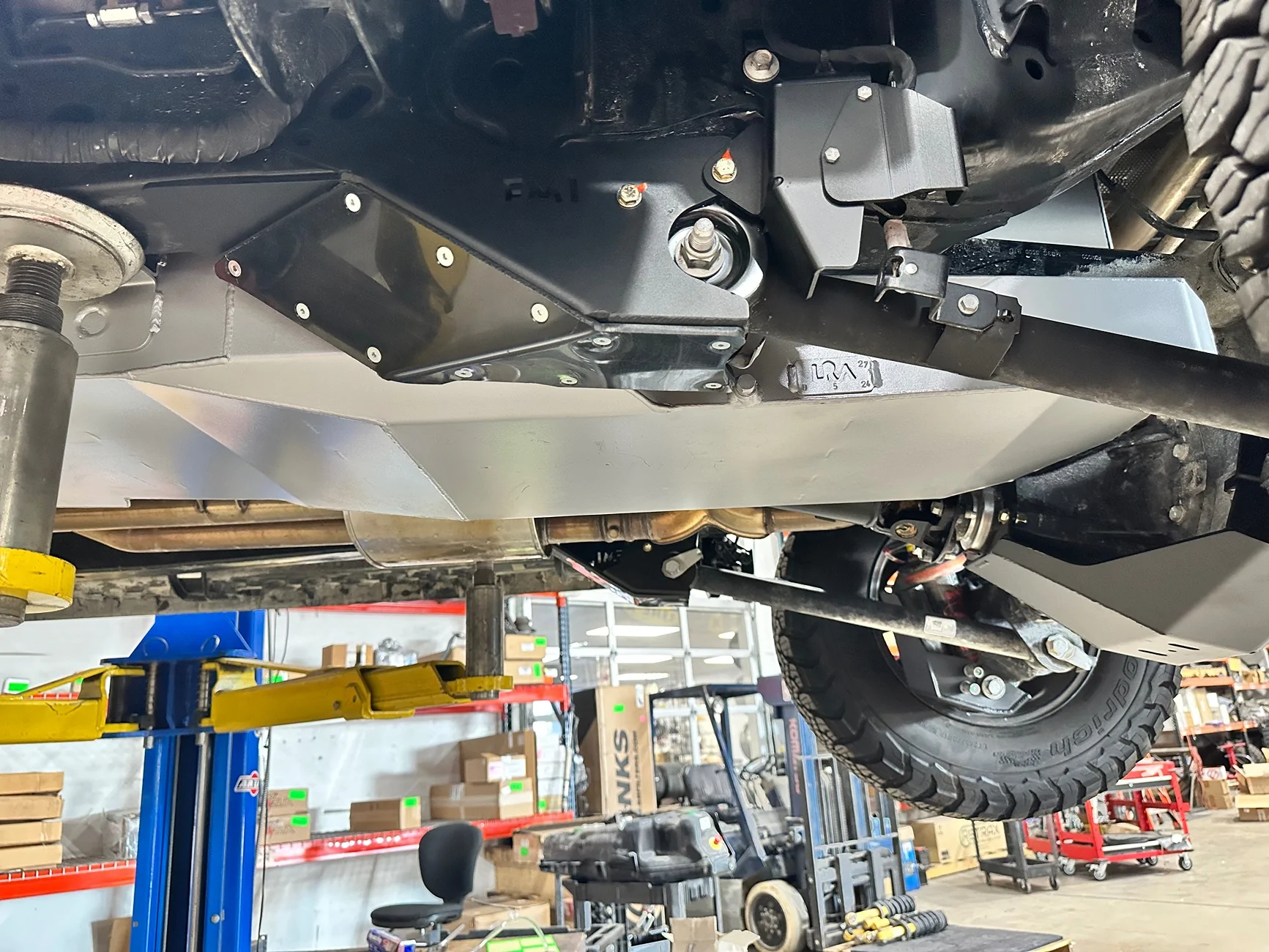

My number one mod/accessory is the Long Range 35 gallon fuel tank. The factory 20.3 gallon tank is just too small. Stock was Sub 300 mile range at 15mpg on 93 octane gas. Less than 200 mile range when I run ethanol at 10mpg. With extended tank, over 500 on gas (my best was over 600) on ethanol free gas and over 350 on e85. With all of the factory features programmed to work properly, it safely has almost a 60 mile reserve.

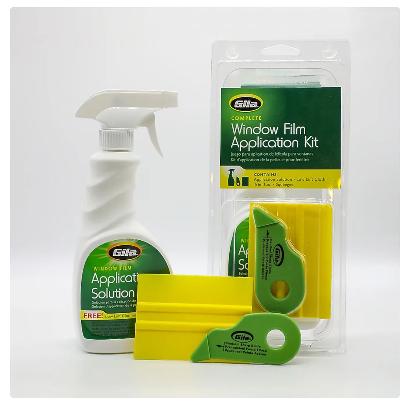

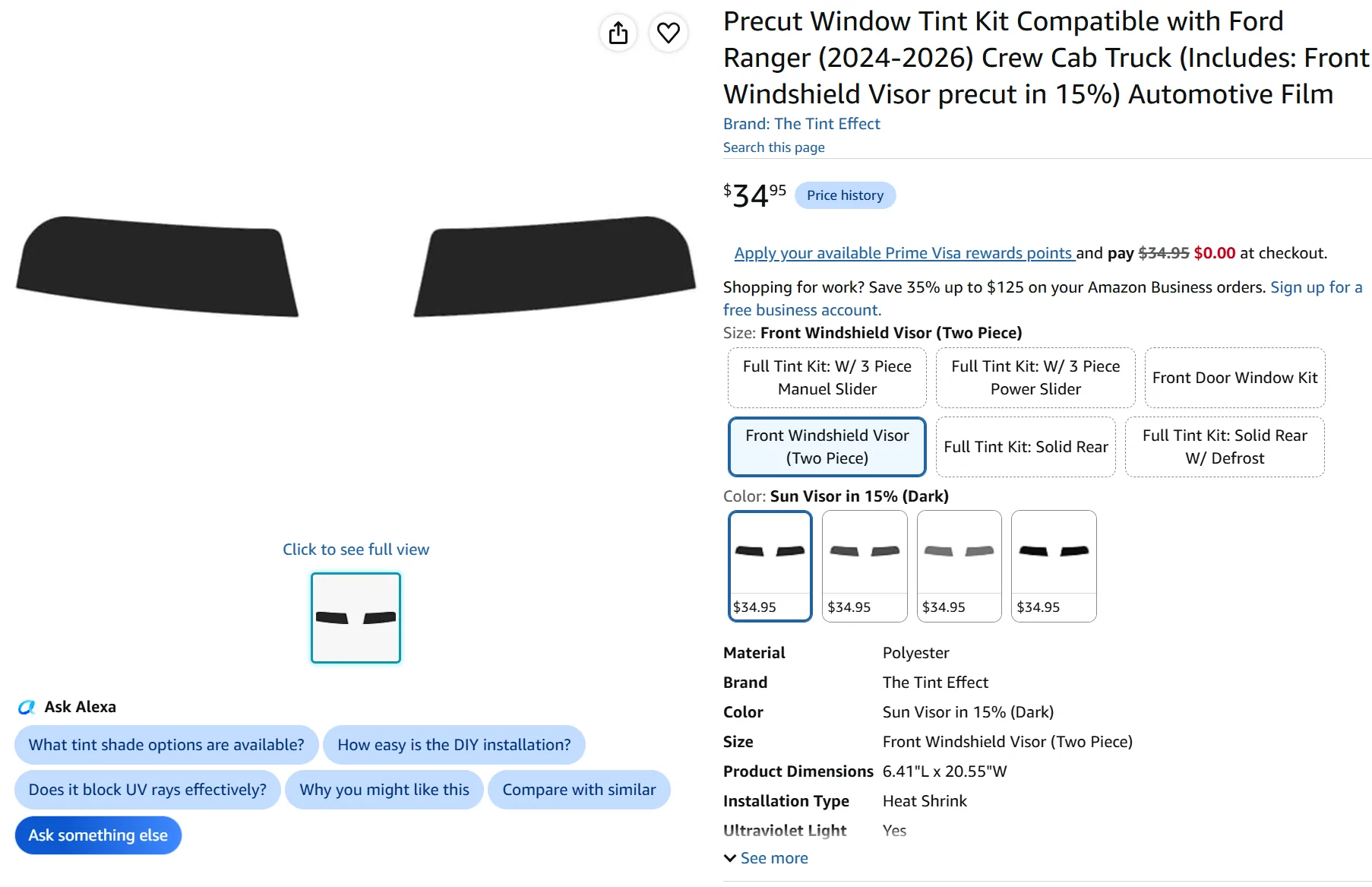

Totally agree. It really started to bug me. I found this window tint kit on Amazon, installed them myself. Very straightforward if you use some window film application spray, and it didn't require removing any trim. I was quoted $200 for the brow when my dealer offered tint, so I was happy to try this out for $45. I probably should've gone with the 5%, but the 15% still offers a lot of relief.

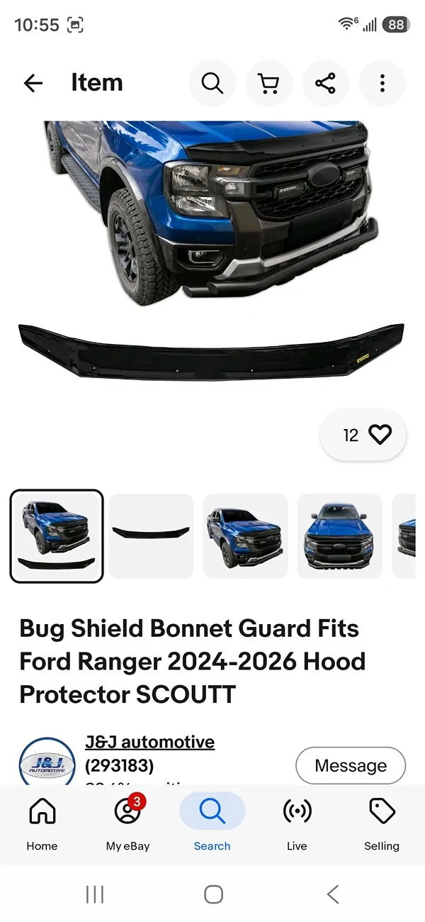

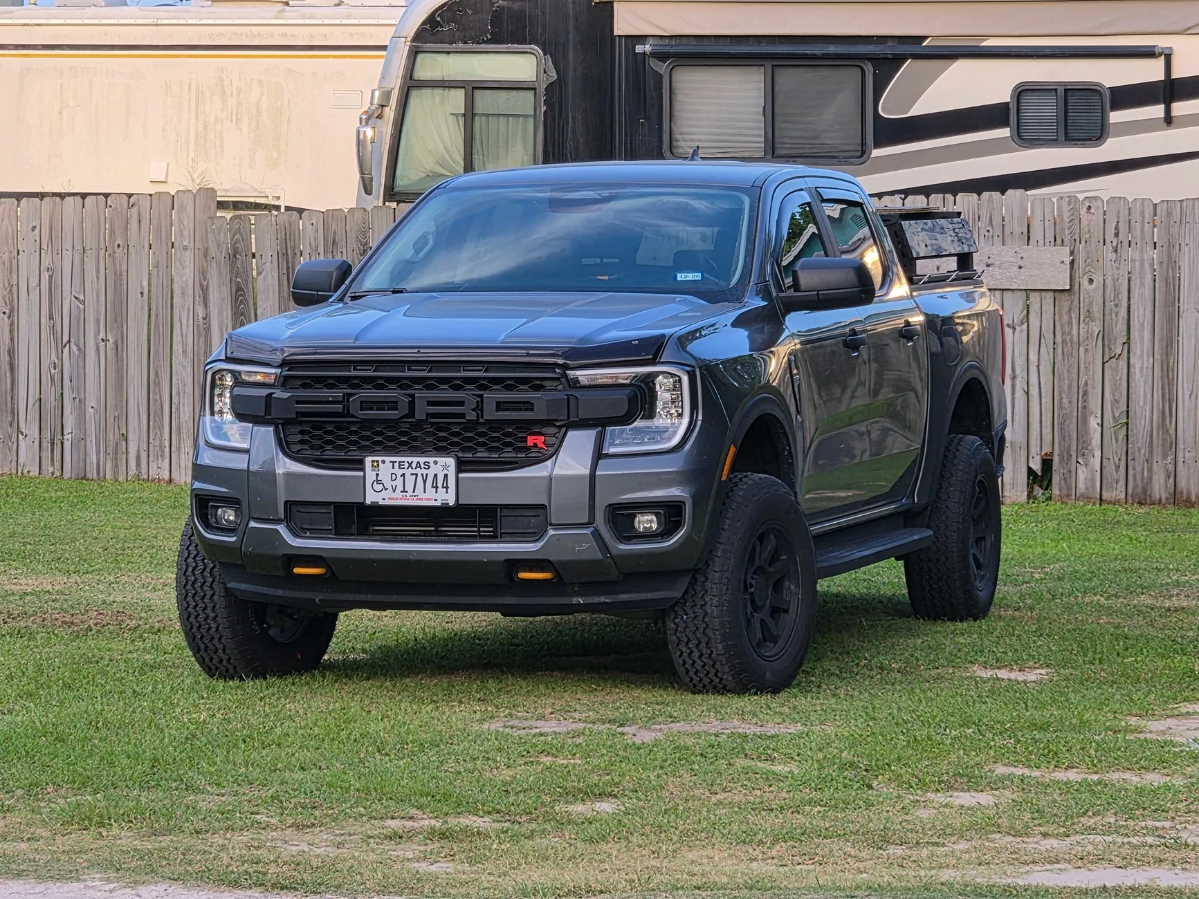

I will tell you an accessory I would love to buy: A hood rock / bug deflector that attaches under the hood and doesn't use tape. I have had them on most of my trucks but (except for a company in New Zealand), I cannot find one for the Ranger.
The avs one attaches with screws and plastic inserts for the screws to go into. It sticks up off the hood and has little rubber bumpers to keep it from banging on the hood while driving.
Of all the hood guards I have tried, the avs was my favorite because it sits up that way. The others all attach with double sided tape to the hood.
This is the avs hood guard
But, I did get plenty of compliments from people on the tripleA hood guard when I had it on

Where did you buy yours? Was it vehicle specific?
4,033
3,894
Yes, vehicle specific.
I think amazon but maybe i just used google and found it, I don't remember now because that was one of the first things I bought

Can you help me out with a link to that deflector? Every one I see attaches with double-sided tape. What you have described is exactly what I am looking for.

This is a Raptor only option in the U.S. other Rangers it will not fit-two completely different rear suspensions and frames. The cost, last I checked from Long Range America was about $2700. Calibration is like having a tuner tune your truck—Cody Cutforth from Stanghi.com is the first and only tuner that seems to have cracked the code. I believe he has a deposit plan for the tuning devise, and you only pay for the program to recalibrate all the factory parameters of full/empty, DTE, and mileage—all just like original. There is some false info floating around that Forscan can be used to reset the tank capacity—don’t believe it. That only works over in Australia where these tanks are made, and they can go into the dealer and have one installed as an option—and they can use Forscan.
