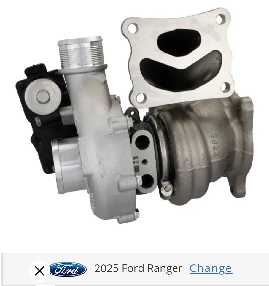

I found the answer. See photo. They did the exhaust pulse timing by different size exhaust feed ports. Took forever for someone at Ford to post real pictures of the turbo to see! :like:
Just a heads up, that's a turbo for the 2.3L., no twin scroll for the 2.7 or 3.0
