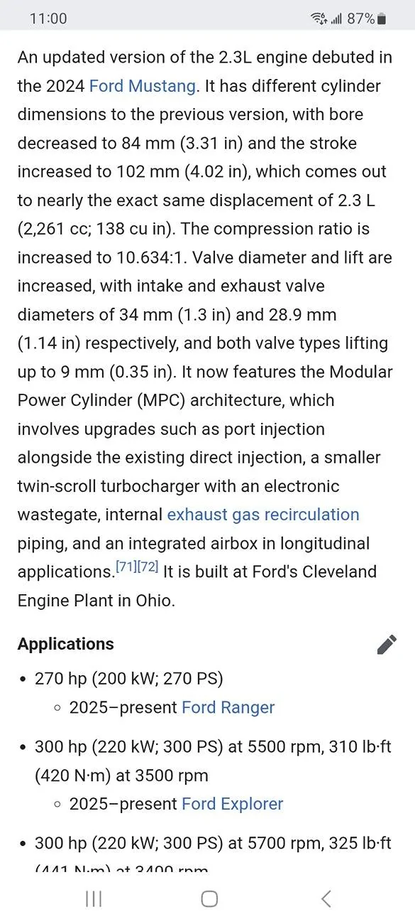

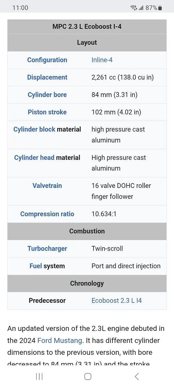

I found an article that finally gices an hp number for the new 2.3. Unfortunately, its wikipedia, but it gives a number.
This is the best description Ive seen yet. If this is accurate they detuned it to last year specs so they didnt have to do a formal announcement and screw up the the 24's on the lots and get it too close to the 2.7 numbers. I can tell you it is much smoother and stronger on the low end than the old engine. Higher compression, bigger valves and the new turbo all contribute. I can't wait to see the numbers after the tuners get one of these.
I seriously doubt they detuned it strictly to avoid announcing it. I think it's much more likely that the intended use in a Ranger is rather different than the expected use in a mustang, so it's tuned for more torque in the Ranger at the expense of a bit less hp. And even if they put the mustang-tuned 2.3 in with only 15 hp less than the 2.7, it still falls about 90ft/lbs short on torque which is pretty darned far from nothing. I don't buy the conspiracy theory.
