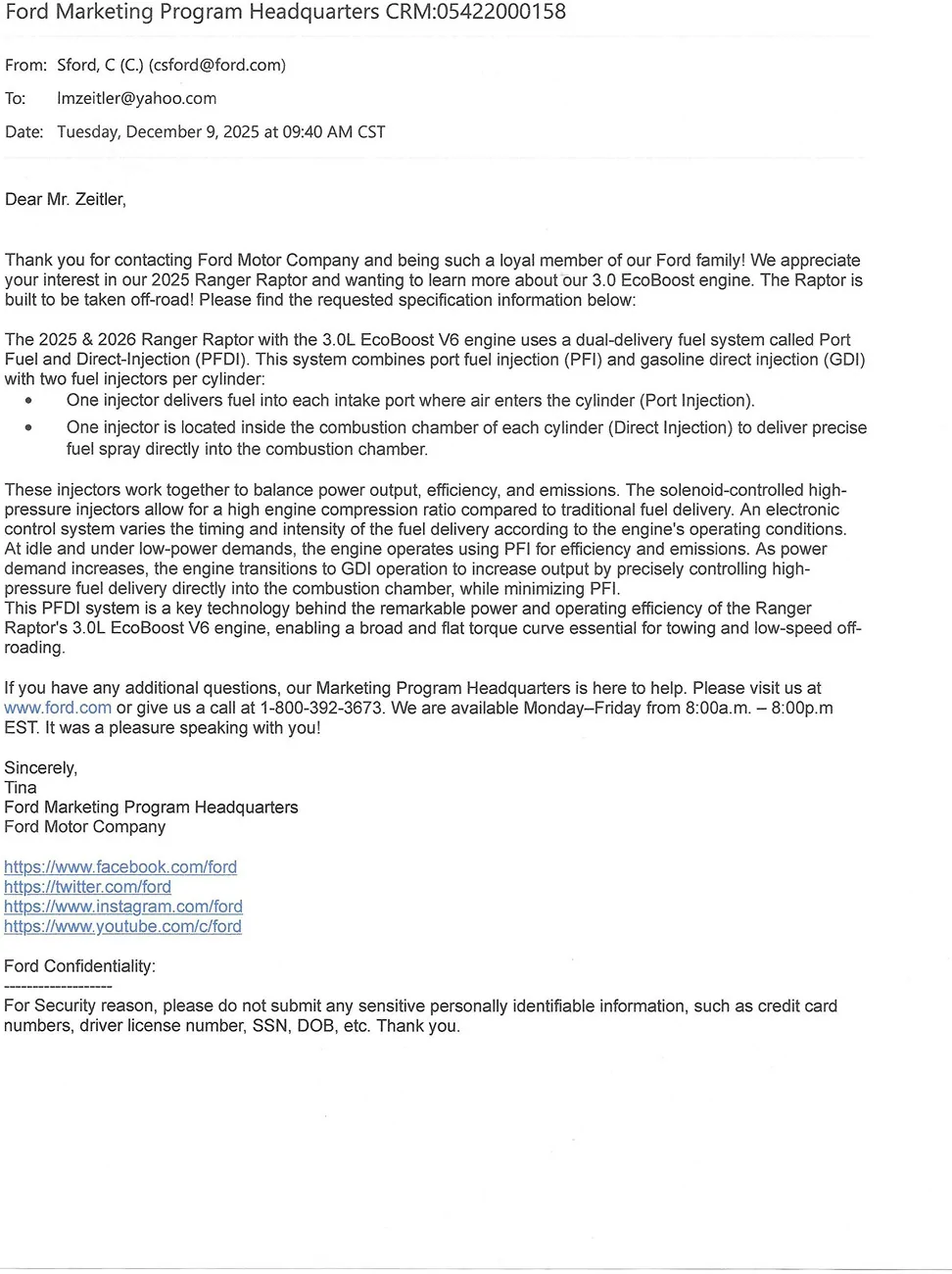

i got this response direct from ford tech support.
I believe they are incorrect, they are probably referencing the Ford website, which mistakenly lists the 3.0L as being dual (Port + DI), it has listed the 3.0L in the RR as dual injection since 2024.
I'm 99% positive some guys with 2025's have also already checked the fuel rails and they are the same for 2024, 2025. I'd imagine the 2026 is no different, but if it is that's great, however they would likely have improved fuel economy if it was which is usually a benefit of Dual injection, and everything is still rated the same for 2024 - 2026.
Looks like its coin toss time. :facepalm:
The only way this will be for sure is those who own them the 24&25 Raptor to look & post pictures. Direct injection will mount under the intakes in the runner valley. Port will be more visible as the injectors are in the intakes runners and pretty hard to hide.

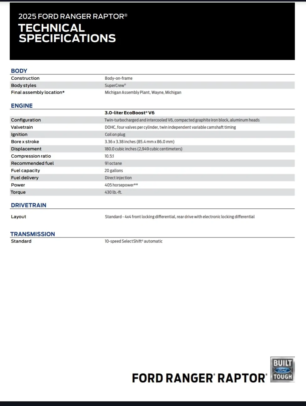

It was confirmed by a forum member with photos, that the 3.0 is direct injection only.
Strange that the 2.3 & 2.7 have the dual system and the halo engine doesn't.
