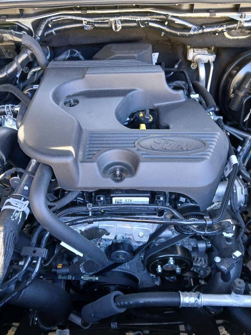

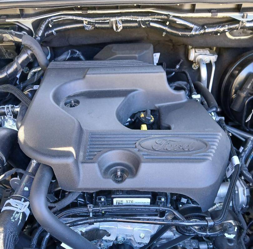

I have this pic with the cover already installed, i can take a pic with it removed tomorrow when it's light out if no one posts one before, sorry i know your looking for a better top view.

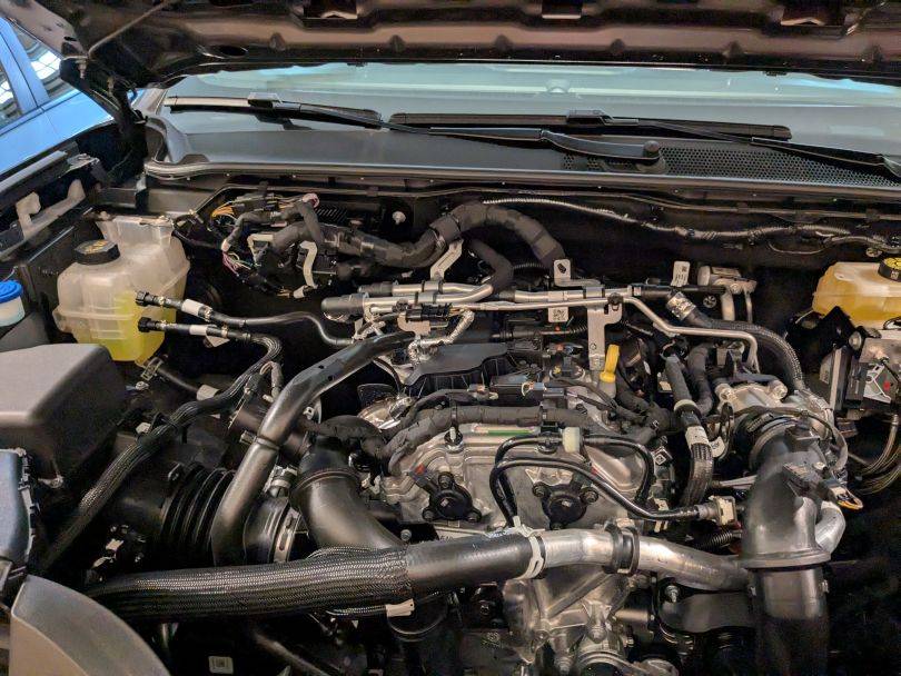

Thanks Muffin1. I can already tell it's an old style 2.3L engine vs the '25 model.
a) the cover fits yours and it's a different bolt pattern on the '25
b) the oil filler cap is in a different position on top. Yours appears oriented behind the dipstick whereas the '25 filler cap is beside the dipstick.
c) the coolant hose on the 24 model routes to left side of engine and the '25 model routes to the right side.
BTW, anyone with an old style engine that wants a great price on the engine cover just PM me. I bought mine while awaiting delivery of my '25 truck and they don't allow returns. :>)
Surely someone with inside Ford knowledge would be gracious enough to provide some detailed guidance on the rumor ?
20224 2.3L - top and 2025 2.3L below

Why you keep insisting this is just a rumor when we definitely have the NEW 2.3 that was used in the Mustang all last year and it was confirmed in the Bronco Forum.

@2018 yes I noticed those items were different too and I never realized there were two different 2.3’s across the models

you can see the belt on the old style one, it goes around a pulley on the head. that new style pic doesn't have a pulley up top. that seems to be a very easy way to tell, cover or no cover

Also the electric brake booster with no round disk against the firewall like the old hydraulic 2.3 booster. I like these brakes better than the 24 I drove which were mushy.
