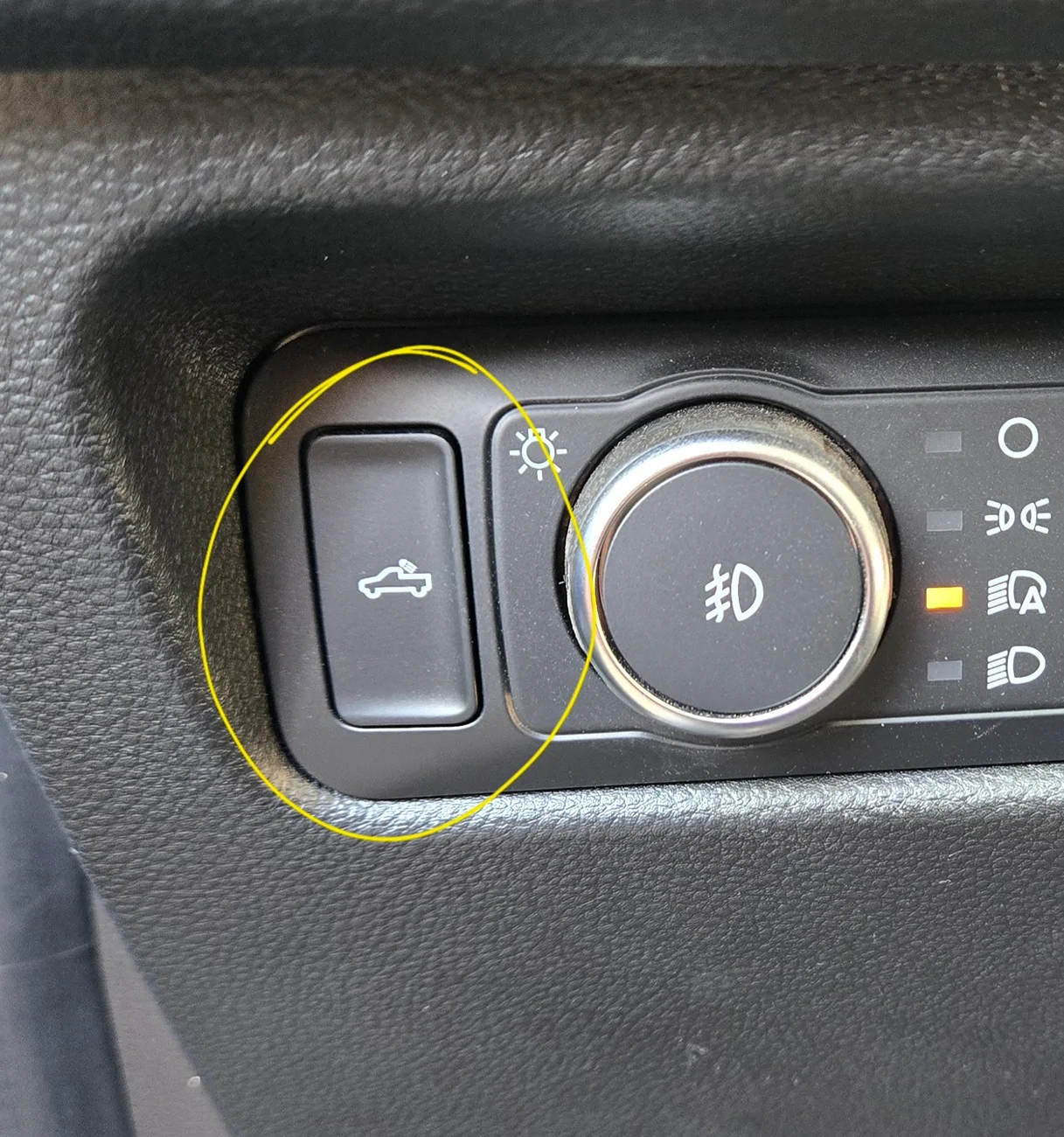

I can not figure this out. A have a 2025 Ranger Raptor and I can't figure this out. On the the back of the cabin is the 3rd brake, which works fine, but the two lights (on either side of the third brake light) I can't get to light up.
Are they reverse lights? Are they bed illumination? I can not seem to get them to light up.
Please advise

Mine come on every time I open my doors. :sunglasses:

Doesnt work. Zone Lighting doesn't turn it on either. Have to trouble shoot to find problem. Any suggestions on where to start?
the dealer. warranty. if they wont turn on when you unlock the truck, or that button, or with the zone lighting. it could be bigger then a fuse and is a warranty issue one would think

I have noticed (from reading the Forscan thread), that some trucks were not configured completely in the computer code. It is possible you'll have to go into Forscan to enable those lights.
