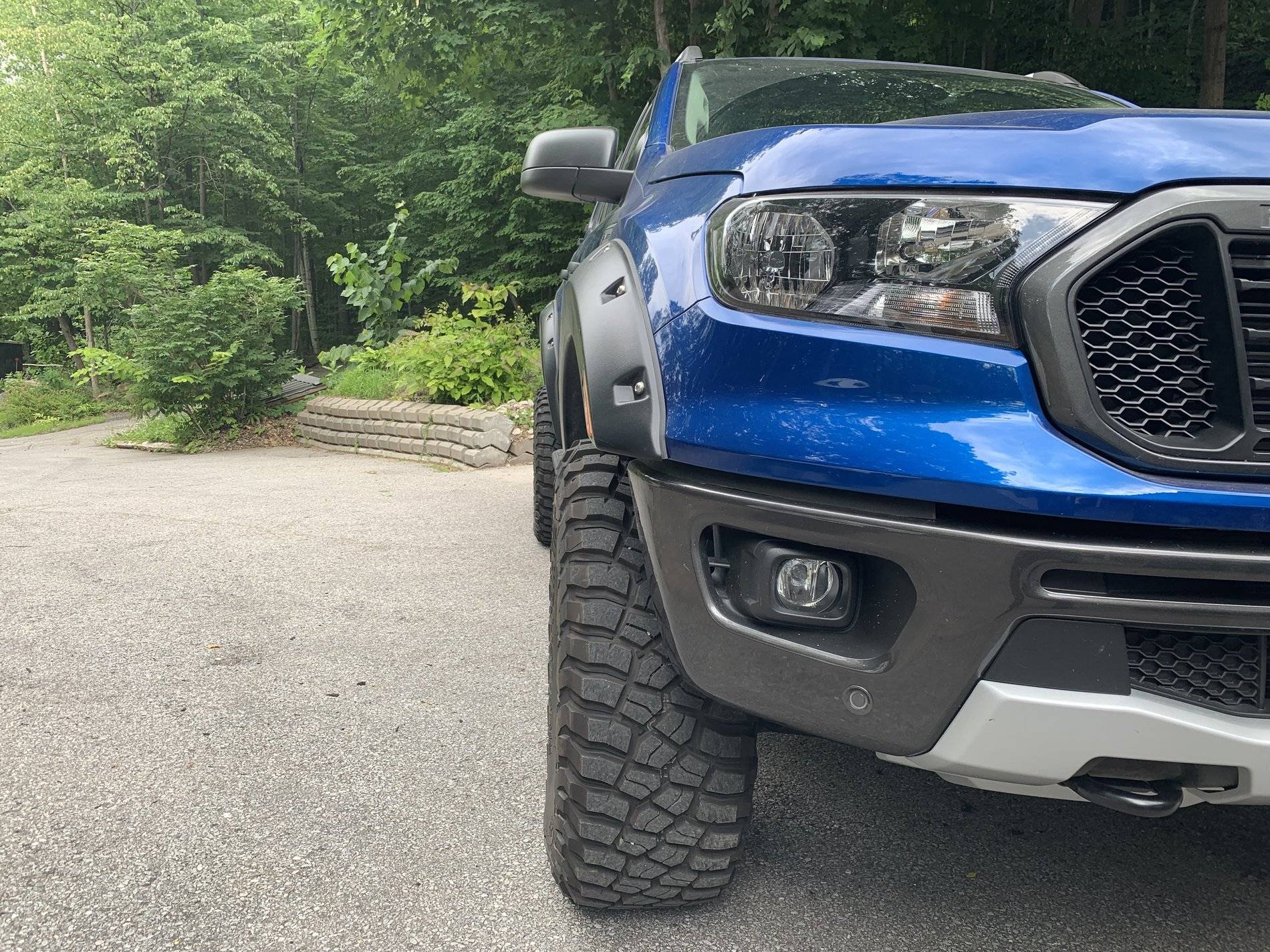

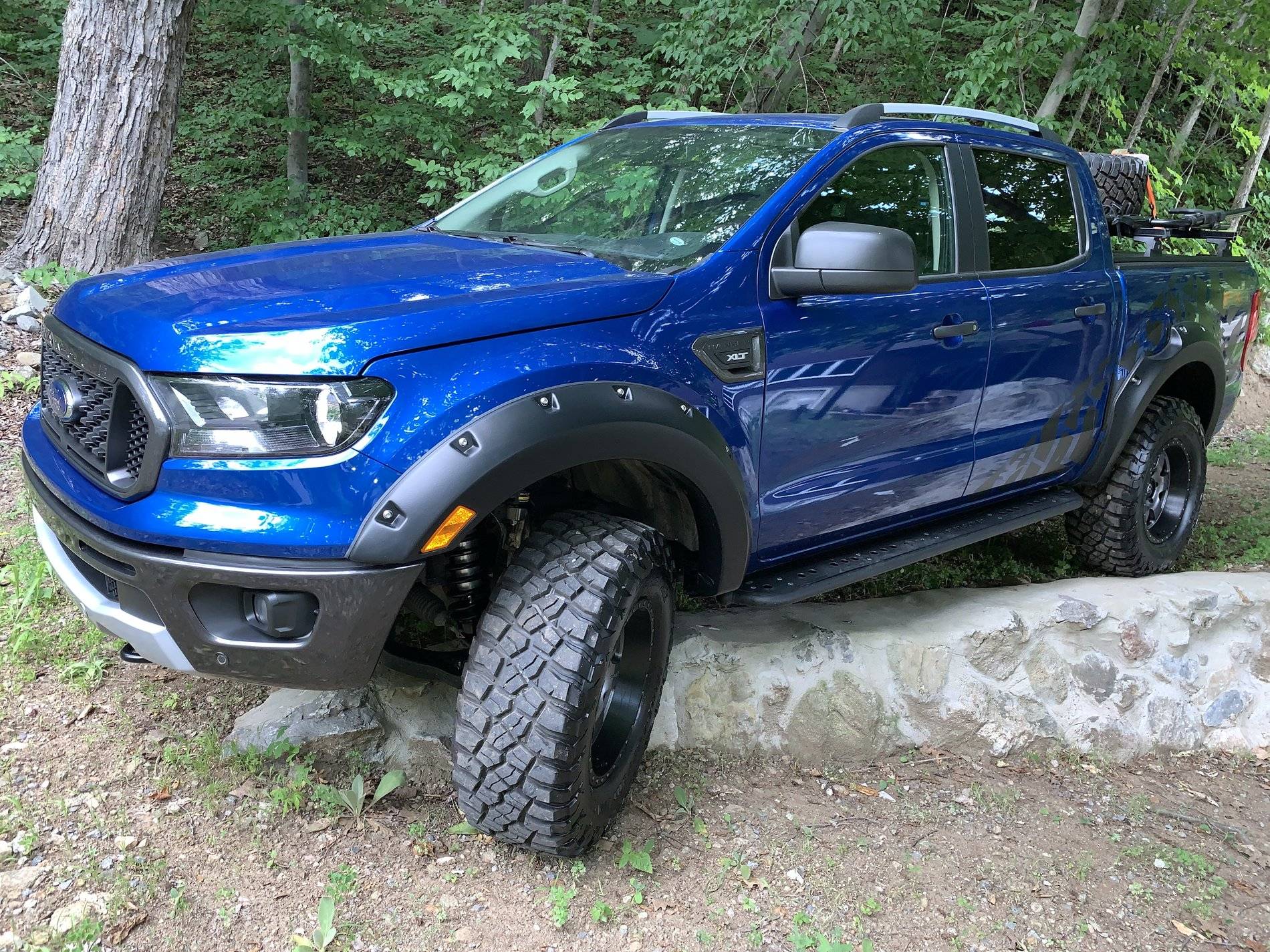

Thanks! Pretty happy ... except getting some significant rub on inner-fender. Will need a lot of trimming.

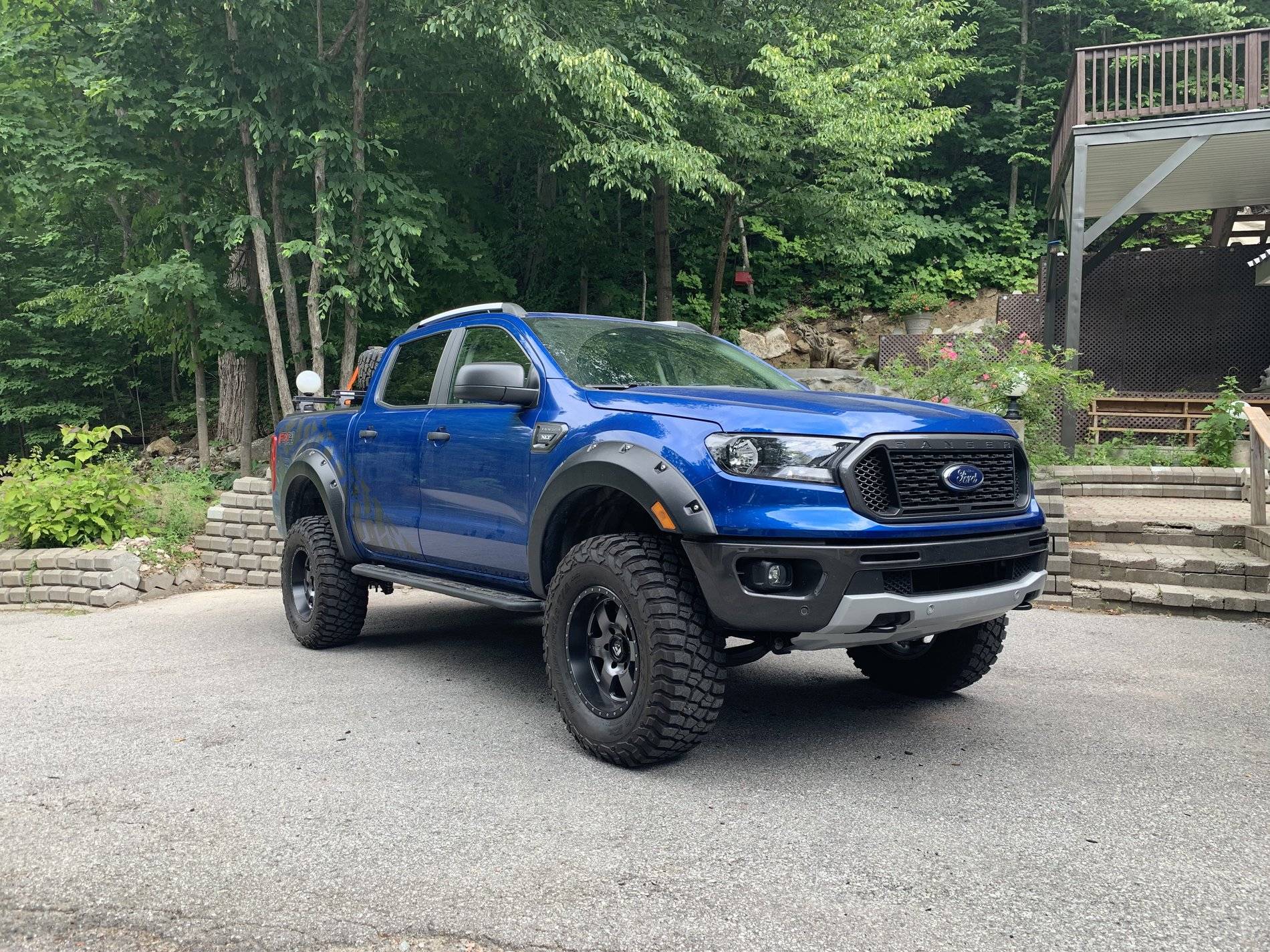

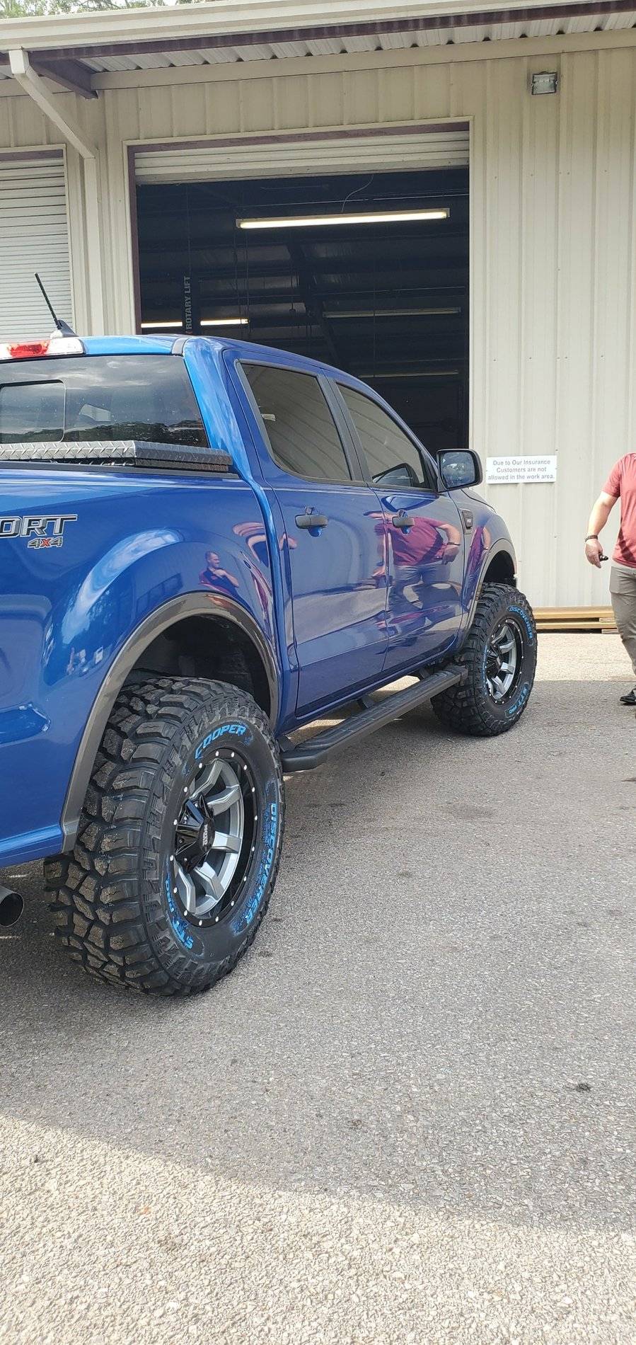

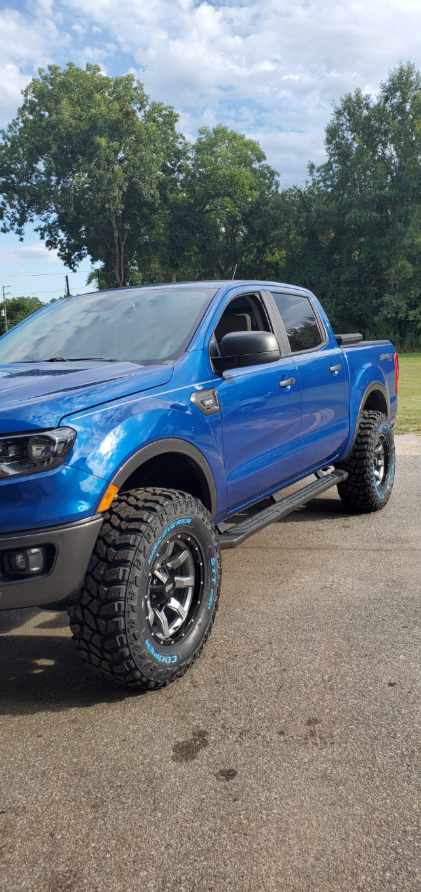

FINALLY! ... Icon 3’’ lift, Fuel wheels and BF Mud installed ... this was a textbook case of Murphy’s law! lol
I see in the one pic that the front crash bar was removed. Did you have to cut it and remove the remainder or take off the front bumper to slide them out? Did you also have to remove the rear one's as well? I'm picking my wheels up this week 17x9 -12 offset with 285/70/17 Moto Metal M0970's with the gray center and black lip. Certainly will pop on the lighting blue. I put a 305/70/17 with the same Moto Metal's 17x9 -12's on the this weekend and with my 3in level kit, it was rubbing front and rear on the crash bars. Just want to get everything prepped before I have the shop put these on.
Congrats on your Ranger! And I agree the black/grey is great on our color. Stands out in a sea of plain black wheels!
Yes both front and rear crash bars have been cut. You can see pics of this in my earlier postings. I don’t believe you can fit more than a 265 if you leave them on. As far as rubbing you should be fine with a 285. I’m having issues with rubbing on the rear section of the inner fenders at full lock because the 295s are quite a bit taller than my winter 285s.
I’m meeting with shop today to figure out how to fix this prior to my first trail run. Under flex and the wheels turned I’m afraid I’ll dig the tires right into that inner fender.
Outstanding, thank you sir. I'll get busy removing these. At least I don't have to chop the cab mounts and fenders like on my Tacoma just to get 33's under it. I would be curious with what your shop comes up with. I do a lot of off road and hunting here in the panhandle of Florida and have a lot of area's I'm sure I will run into a full flex of the front. Will hit the trails this weekend to see how much rubbing I will get.

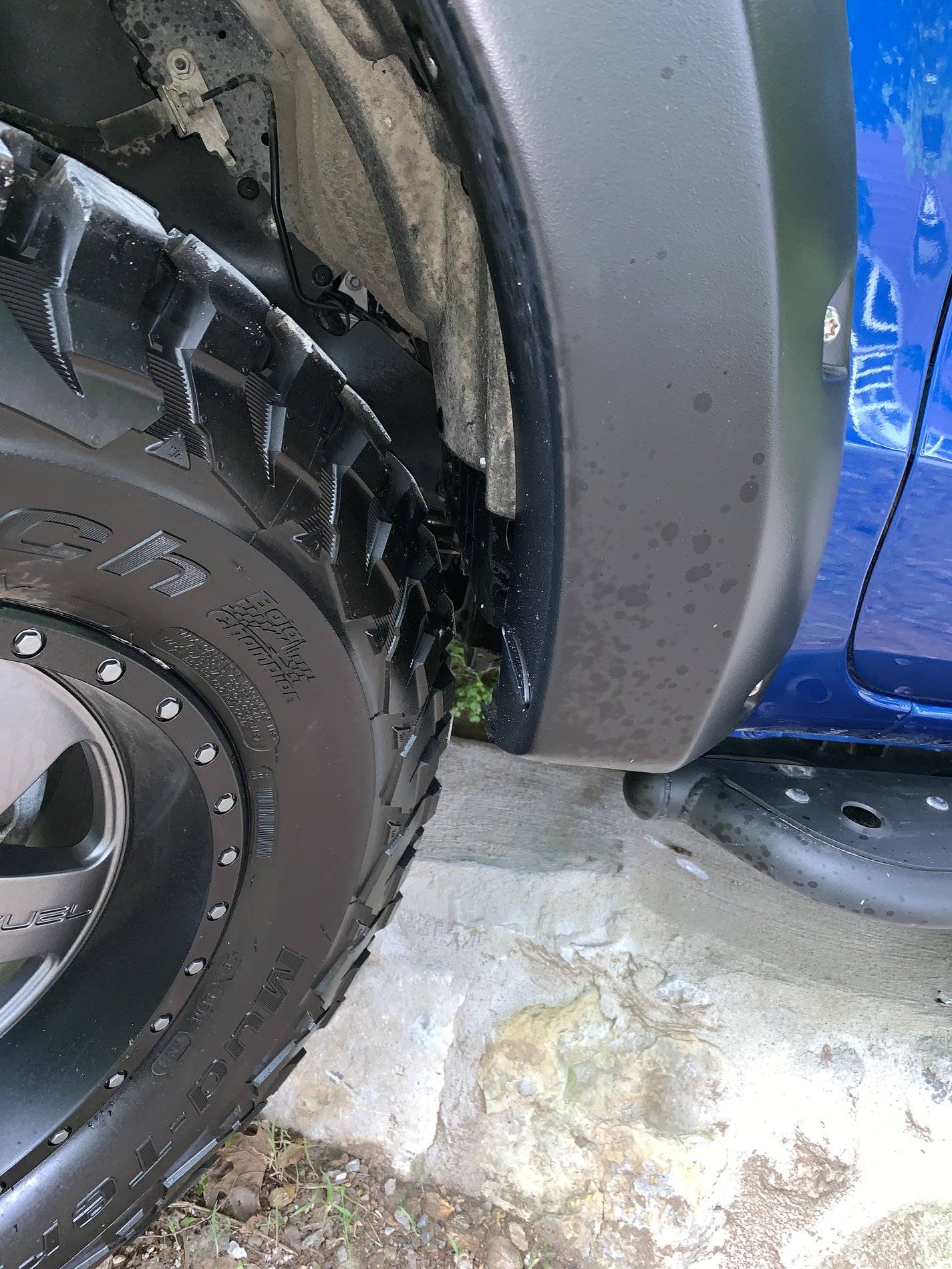

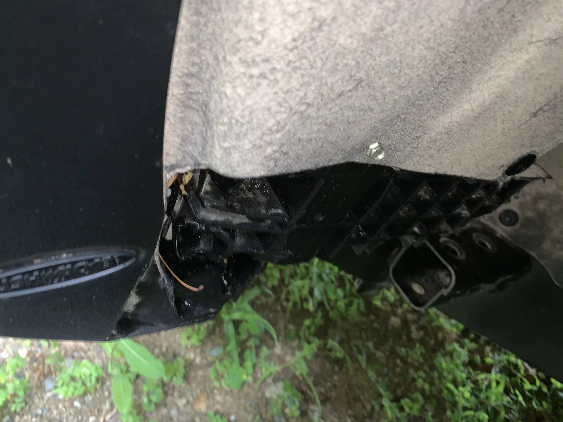

Pics of the cutting required to make it “streetable”. Needed to trim both inner fender and part of bottom edge of bushwackers (from inside the fenders).

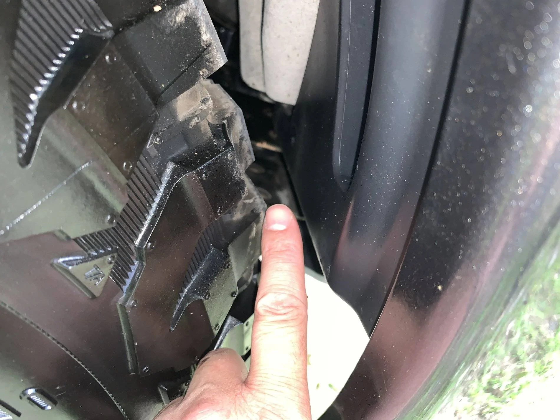

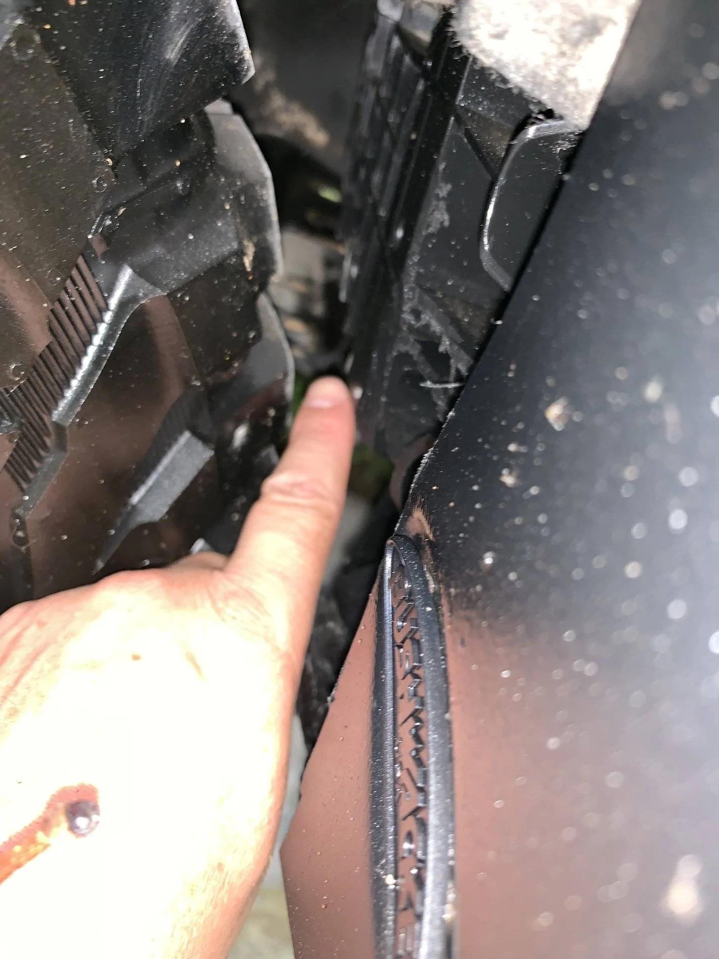

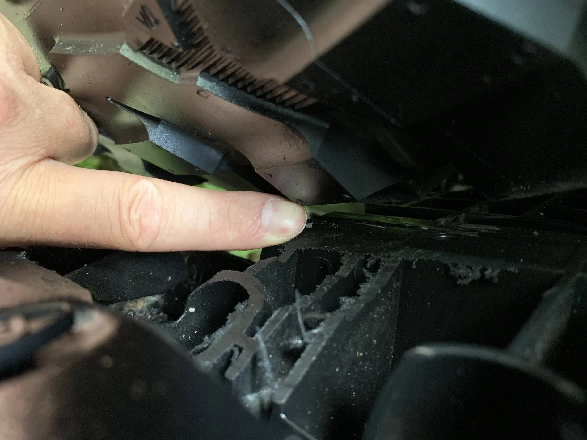

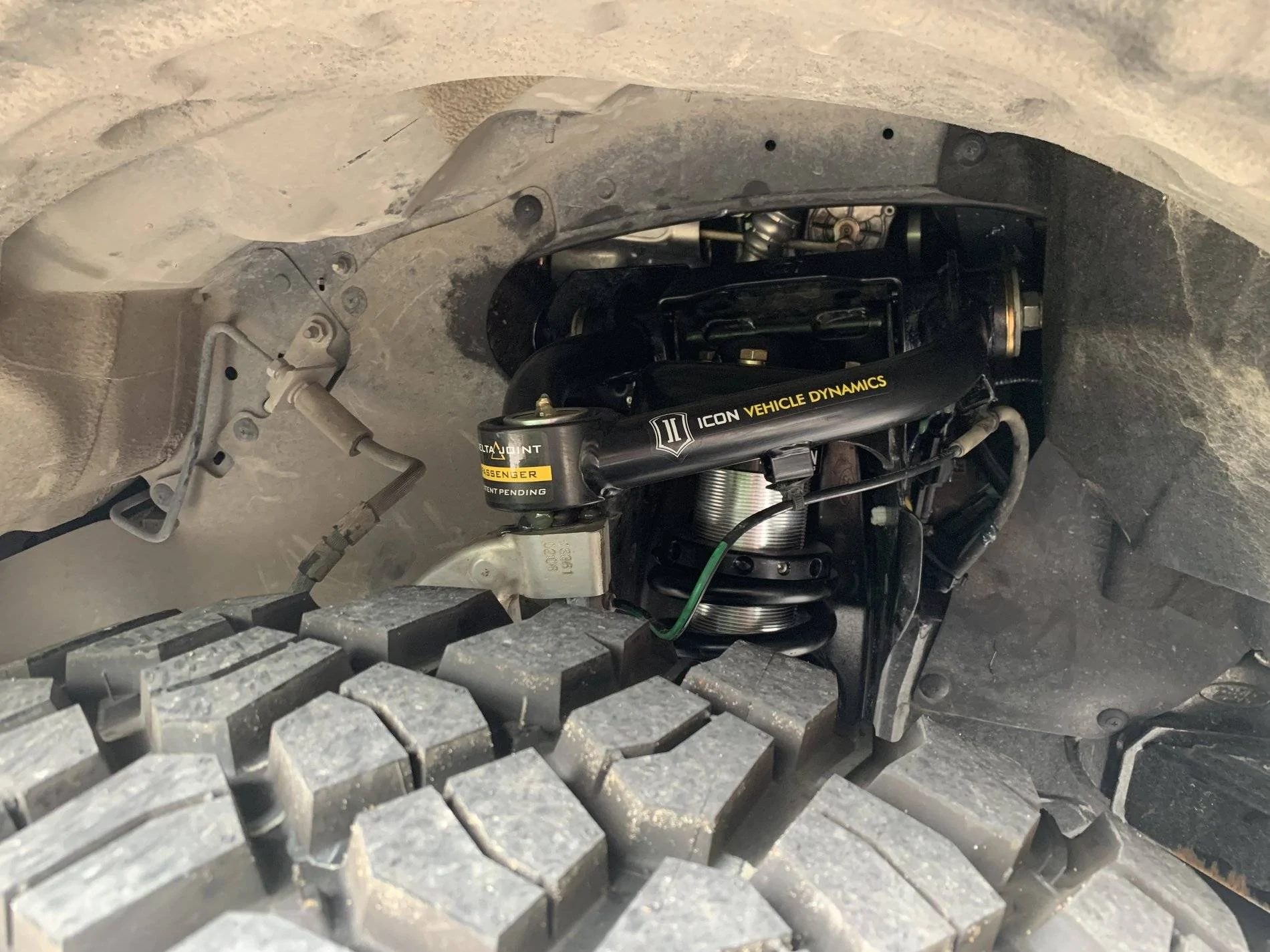

But for off-roading I think I’ll need to start “grinding” away at that plastic thingy on the inner fender. Under moderate flex and at full lock it’s cutting it a little too close for comfort!
I finally got around to having my wheels and tires installed. Instead of trimming the plastic crash blocks, I took them completely out. Only (4) 14mm bolts holding them in place. Amazing how much additional room there was. Under full flex and full lock neither sides rub with the 295/70/17's. I was also able to save the OEM carpet liners by pushing in and pulling tight to the inner block mounting bolt next to the frame. Just used one of the original mounting bolts with an oversized washer to secure it in place. Once I get the fabtech crash bars in, I will more than likely trim up those plastics blocks to fit back behind the bars. Might have to tweak the rear bars and blocks but will see when they come in and I find the time.
Looks really sharp man!
Thanks for the info on the plastic block thing. Will be doing that for sure ... but unfortunately for me the felt liner as already been ruined. I will also be trimming part of the rocker/fender junction inside the fender cause it sticks out almost like a knife. In a more aggressive weight transfer with the wheels 3/4 to full lock it would easily puncture the tire I suspect.

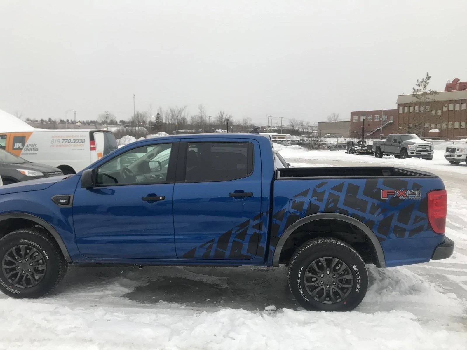

Kinda ashamed to post this but I started this thread and don’t have any of the “main” mods come in yet so what was supposed to go on last ends up going up first.
But...
This stripe kit did give me a good 15hp increase, certified by a genuine PoserPower Dyno.
Also the manufacturer, Bro-Engineering, is currently seeking certification to state that this kit is as effective as a front locker while negociating a Walmart parking lot (in dry weather).But it has hit a snag with the Justine Trudeau government because of high toxic masculinity emissions measured under the newly enacted intersectional climate change initiative.
I've planned a lot of things out for the ranger Im getting next spring (hopefully) when I graduate, but I never thought about getting a stripe kit or decal until I saw this.... this looks awesome!! Could you post a link to where you got it from? Also, I'm assuming that retractable cover is the one through Ford Accessories. It's compatible with the Tonneau Kit 1 from Yakima? How's the quality? I've heard some bad things about Retrax so Im edgey on getting their cover but I really want the Outpost HD from Yakima. My preferred cover is the American Roll Cover from Truck Covers USA but for now that doesnt work with Yakima's new truck rack system.
Thanks for the compliment!
I found the inspiration from a pic I found on the Ol’ Google machine:
Ford Ranger The Weekend Warrior 12ADF693-CE84-4C8C-8769-4678571E3F99
I then gave it to the dealer and they had their supplier come up with a design based on that.
As for the tonneau I’m kinda disappointed not in the quality but rather it’s operation. I first intended on buying a Pace-Edwards because I liked the ease of opening/closing the cover (It’s sort of on a spring mechanism) unfortunately it wasn’t available when I bought the truck. No such option on the Retrax/Ford cover, it’s manual all the way, as in you need to walk beside the truck with the latch in hand to open and close it. You cant stay at the tailgate and pull a strap like on many others (P-E included).
