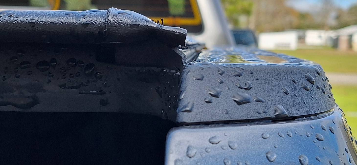

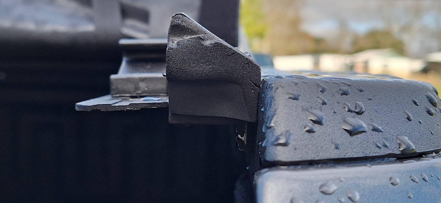

I took a couple of pictures of my Gator SRX. As you can see, nothing sits on top of the rail.
As for the caps, some have sealed those up with silicone. I didn't, as I added the cover for looks, not necessarily for keeping things dry.

Ok, yeah, yours is different than the other ones I've seen installed. Yours really bolts completely to the side, eh.
I'm not worried about water or dust, more just want to hid things from prying eyes.
