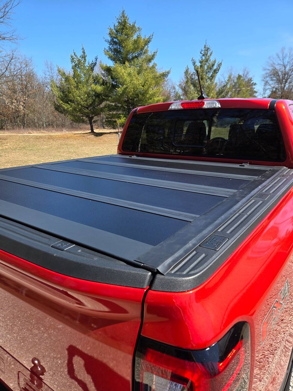

Finally was able install ours. Very nice product for $530.00 that it cost on sale.

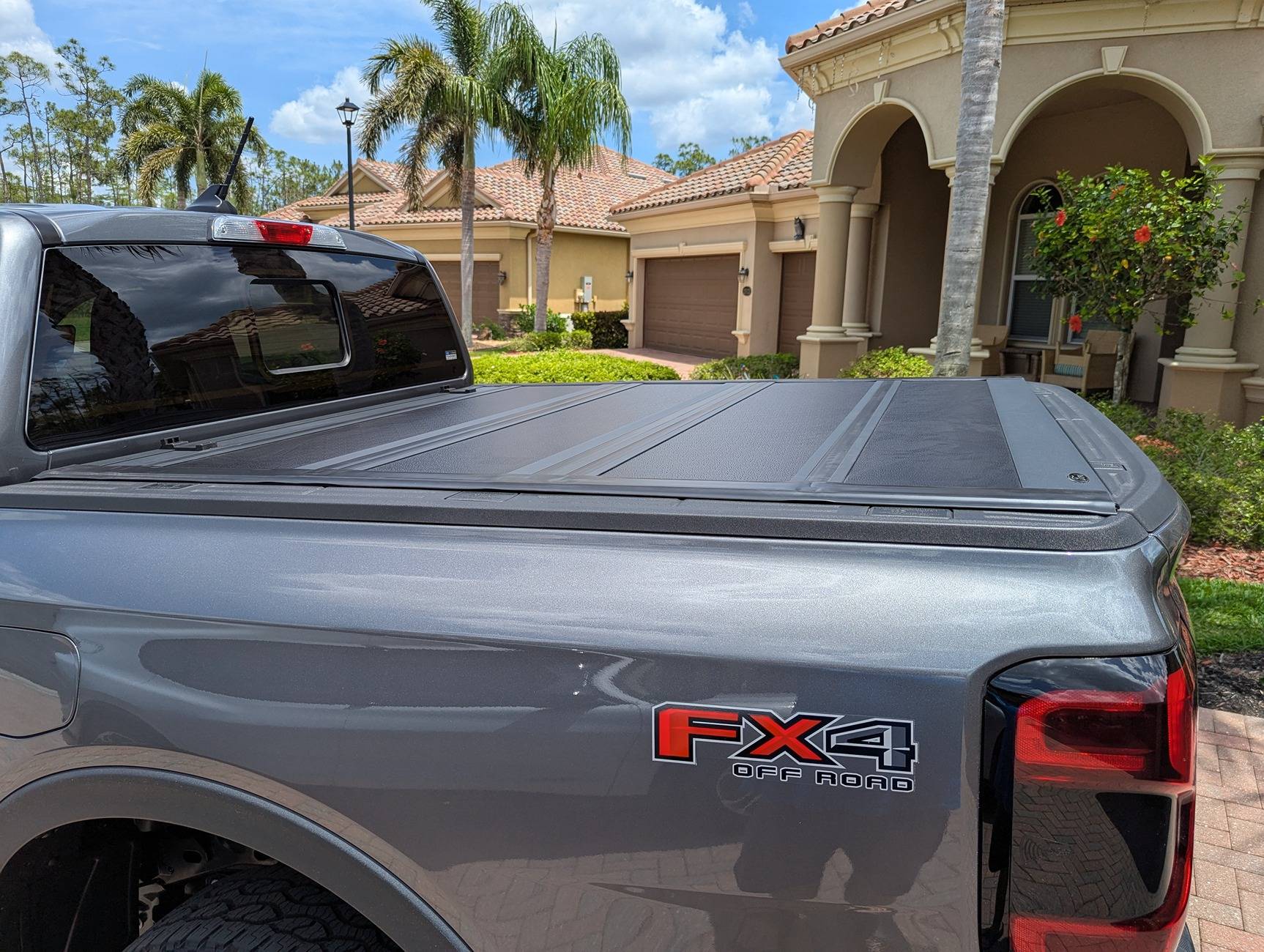

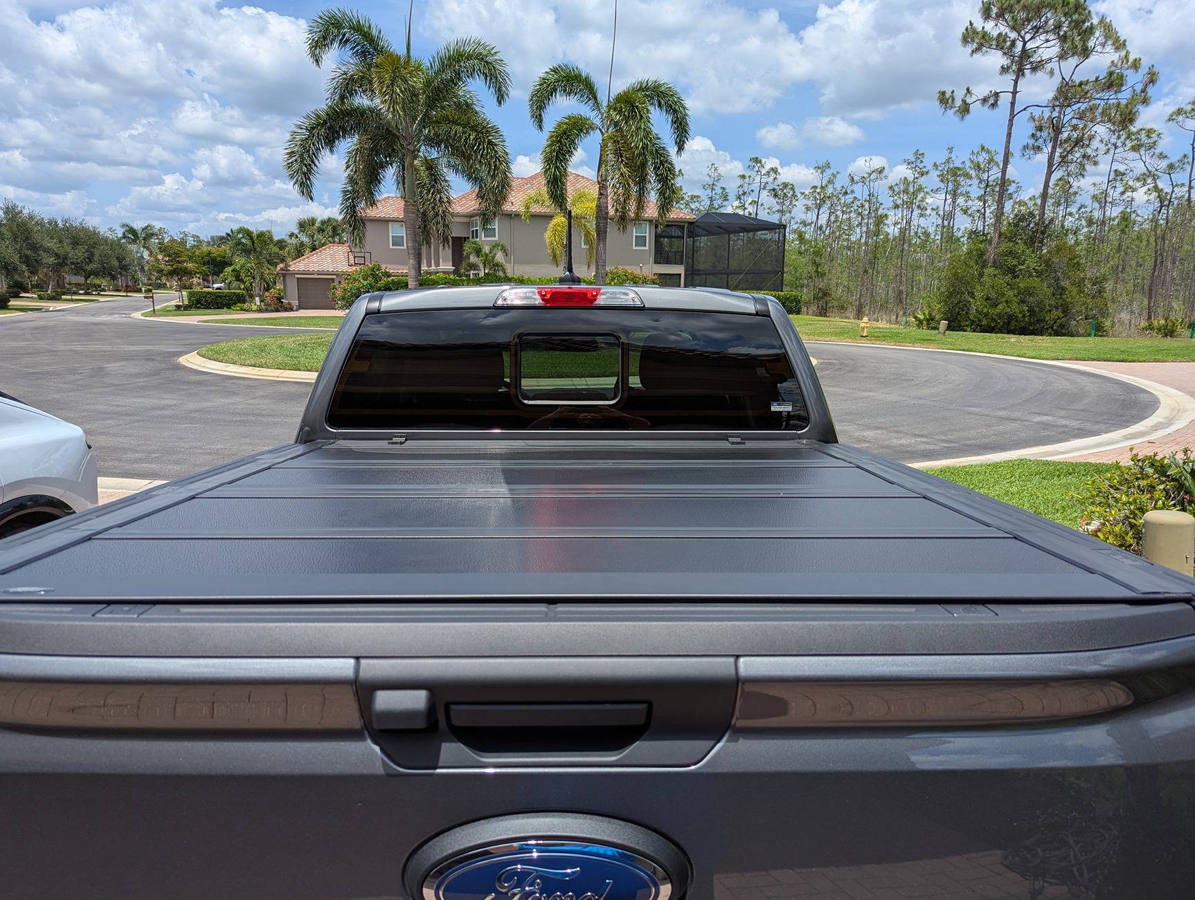

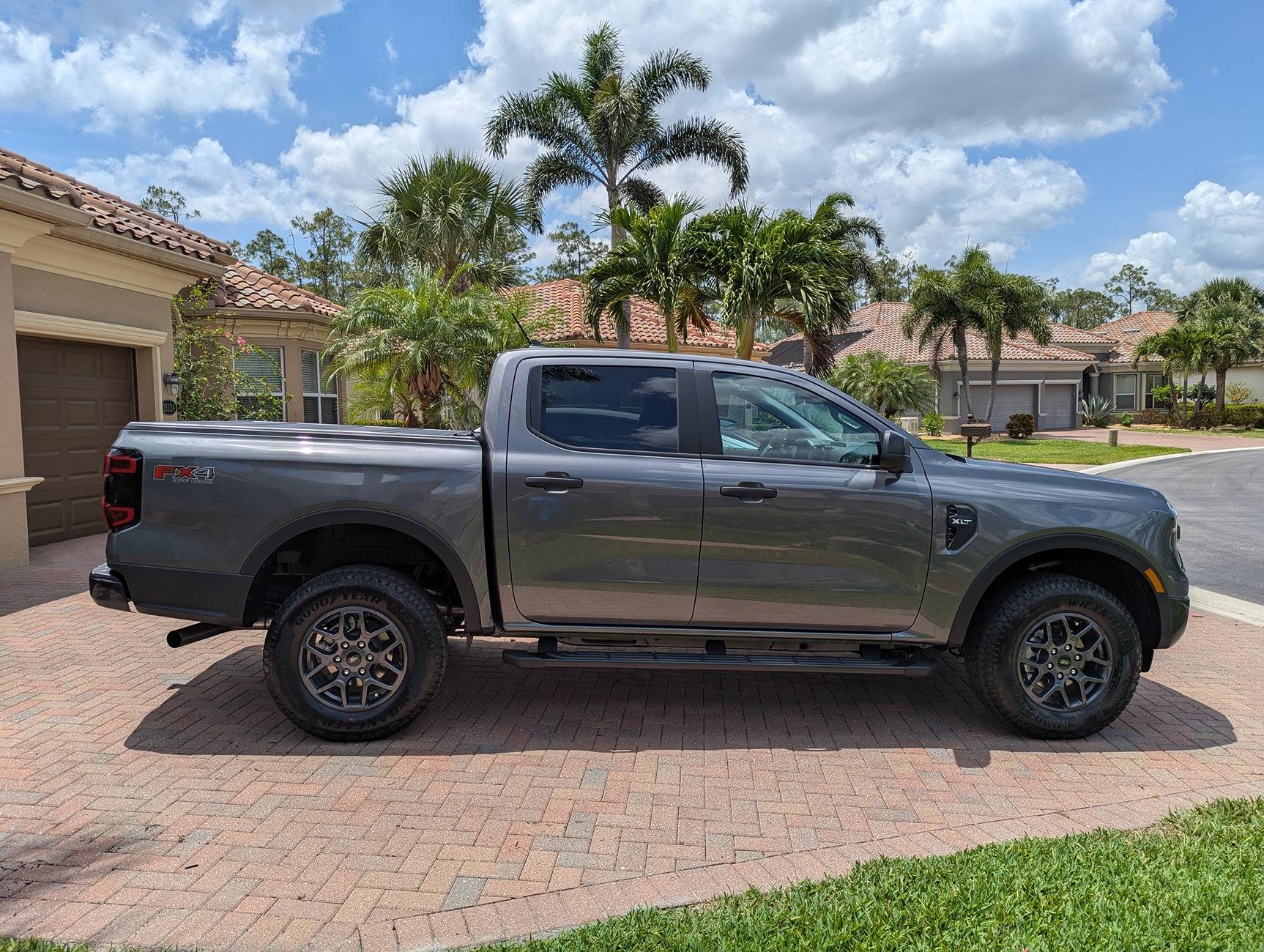

Finally got my truck yesterday. Installed mine today. Great fit. Easy install.
