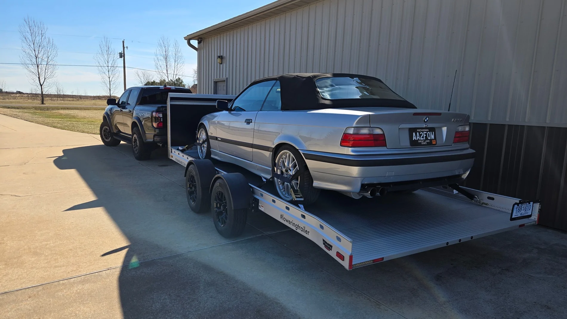

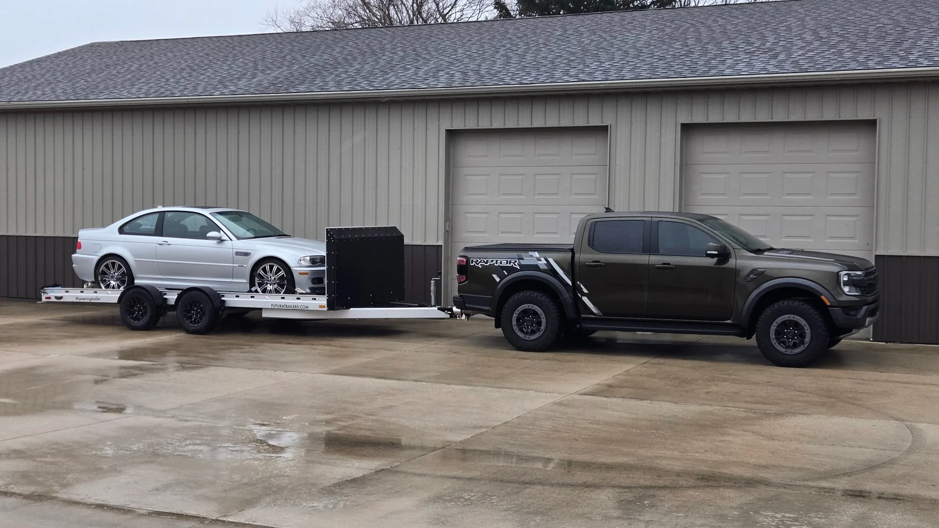

So funnily enough I just bought a Futura Supersport to haul my many car projects to racetracks and to and from the shop. The Raptor pulls it well, haven't put my M4 on it yet however which will be right about at the weight limit of the truck. I will probably put bags on it soon enough (when Boss or AAA comes back into stock) but if I was doing it every day for a business I would still probably get something a bit larger. Side winds can still make things feel a bit funny with the truck being on the smaller side.
I have also towed cars with a 6mt Tacoma (albeit not with this trailer) and it really kinda sucks rowing gears while pulling. I would recommend the Ranger at the minimum over the Tacoma.
The Futura kicks ass though, if you are in the Midwest hit up Brian at MOTOVAULT.

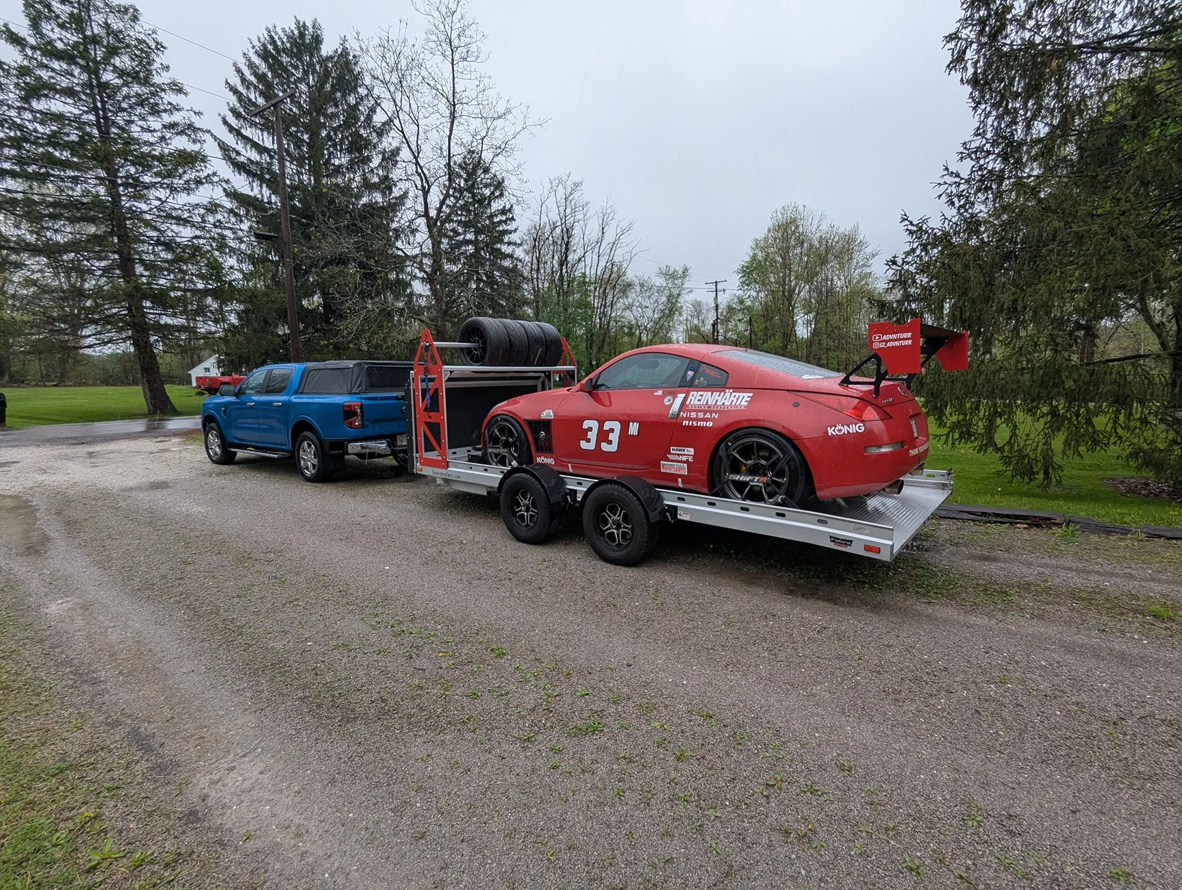

For the short duration tows and trailer/vehicle weights you're talking about the 2.7 Ranger would honestly be fine, even with that frequency IMHO. Yes, an F150+ would likely tow better but you're going to get eaten up by fuel costs when you aren't towing and you'll lose maneuverability and day-to-day benefits of the smaller truck when you aren't towing.
FWIW, I have a '24 XLT with the 2.7 and a Futura SuperSport that I use to tow my track car (and eventually other cars) to track events and such; less frequency, but longer distances. I towed my setup from OH to KY last fall and with the trailer at ~5k and a tongue load around 600lb it did spectacular and was getting ~12mpg with cruise set at 75mph (my friend's F250 with the small V8 gets that empty puttering around town). Definitely invest in a Weigh Safe hitch or similar because you really need to mind your tongue load with the smaller truck.
