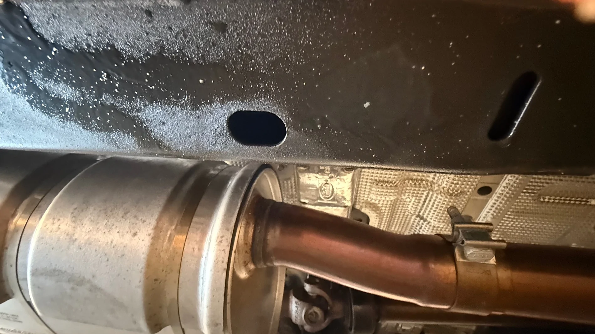

I see from this video that there's a lot of open holes in the frame. Seams that could rust.
What to do or what have you done. I thought when i get the truck to rust paint some of the seams.
Is there a plug kit for frame. The most common way to treat the bottom is to Oil it.
Video section 5:52 Under the Car.

None of the holes that i can see in the frame are down low. They would not allow it to drain out.
One of the things i did like on a 2011 4g Ranger is they had openings on the bottom of the rockers for the debris to fall out or be washed out.

I will se if i can find plugs to fit the holes in the frame. The holes on bottom of frame i would leave open.
I was reading on the 5G site that the rockers have 5 holes on each side which should have caps on them from the factory.
I found this on amazon. The big hole in front of rear wheel.
Amazon.com: ushilife Silicone Frame Tube Hole Plug, Compatible with Ford Ranger 2022-2024, Frame Cover for Tubes, Protective Beam Dust Cover, Anti Dirt Mud and Debris Caps, Rear Wheel Well Hole Plugs : Automotive

As soon as I got the car, I sprayed the underside and inside of the frame with rust prevention spray, which should last about three years.

i got mine sprayed with rust prevention spray when it was new and now will get it touched up every 3-4 years.
