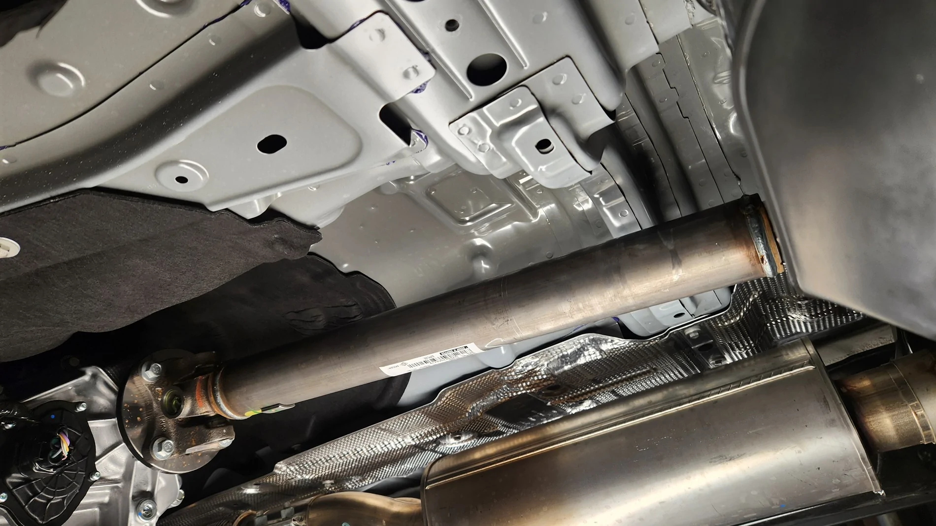

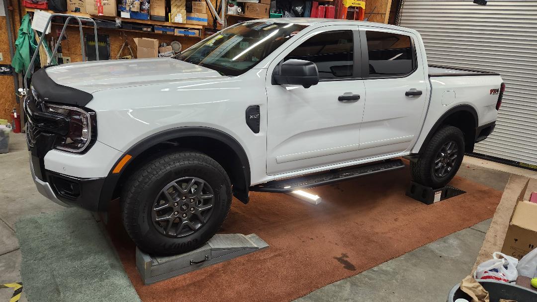

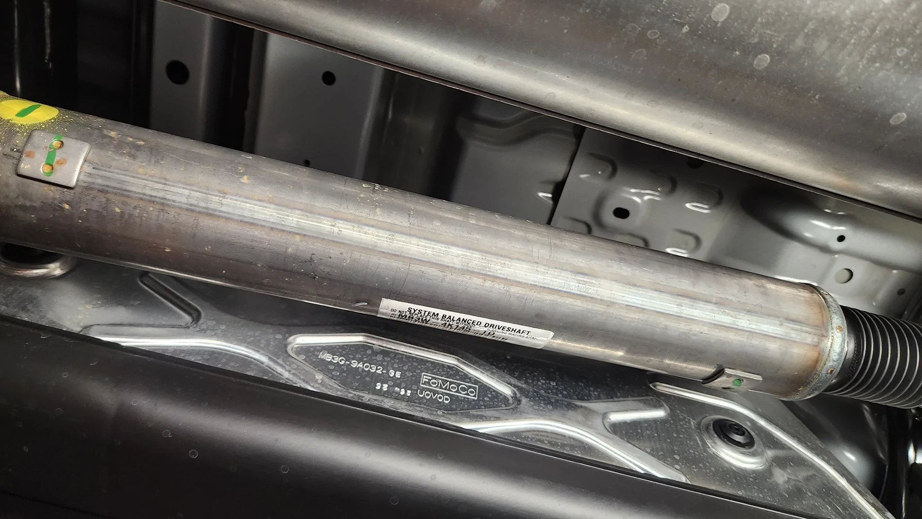

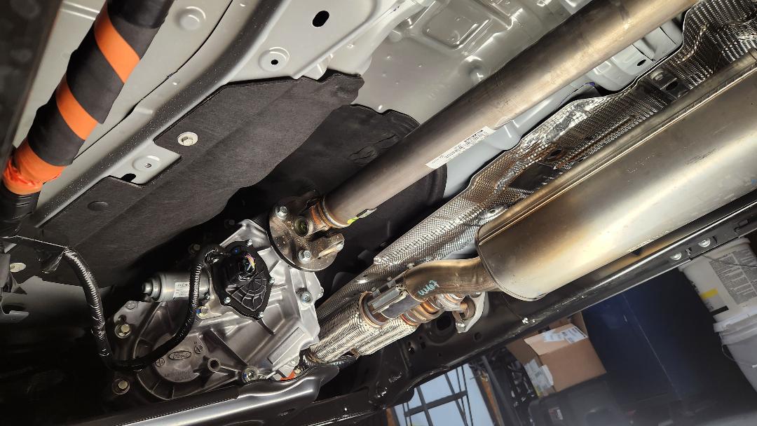

Having read about undercarriage rust I put my Ranger up on my poor man's lift today and crawled around underneath. Everything is bright and shiny, rust free right now and the only parts I can see that might rust are the drivelines and exhaust. I'm not too worried about it since I live in a desert, but I do plan to visit the beach now and then.
So what all gets surface rust? The heat shields look to be aluminum, the skids are painted. Maybe a few bolt heads? I thought I'd hit any bare metal with Rustoleum now and maybe some Fluid Film before I take it on the beach, but the drivelines are the only thing I see that might rust besides the exhaust which nothing can be done about anyway. As of yet my truck hasn't even seen rain.
The frame seems to be well painted, maybe I'll do nothing. 🤷‍♂️

exhaust is all stainless so no rust there, driveshaft will rust with the "smell" of moisture. So far that's all i have seen with rust in NE. (I "Cosmolined" all else)

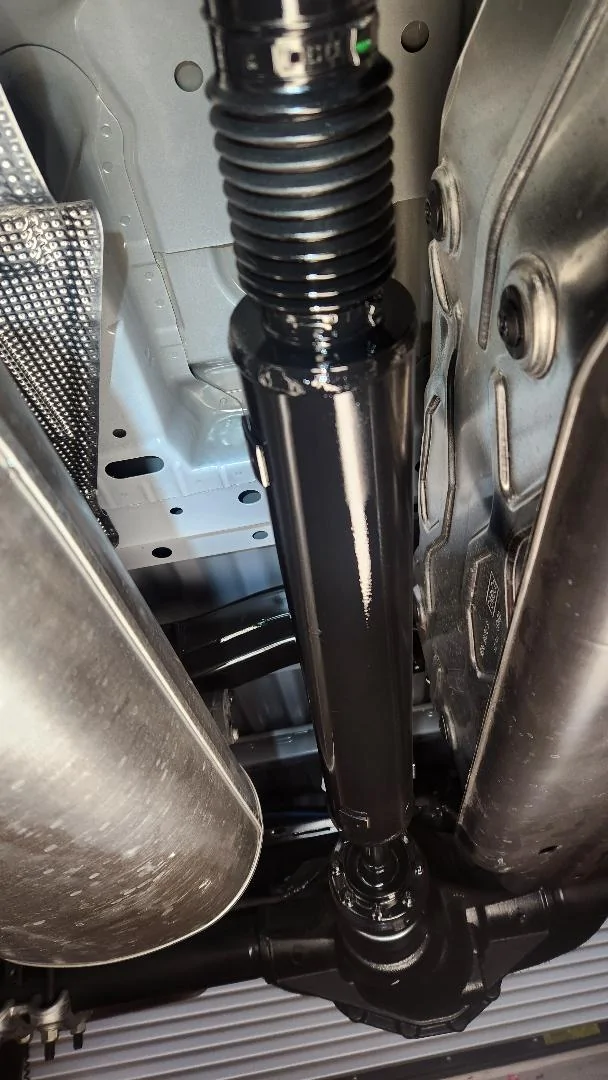

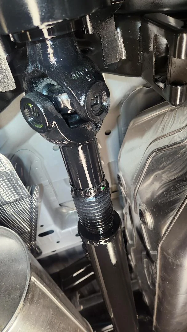

Well I went ahead and did all 3 drivelines, yokes and flanges, and a few bolt heads, that's about it. Everything else is pretty well painted. Even the bolts look to be galvanized.

I used Rustoleum Professional High Performance Enamel. The pics were taken right afterwards, haven't looked under there since but it does stay pretty shiny. It cures slower than regular Rustoleum and runs more easily if applied too heavily but the final cured finish is more durable.
