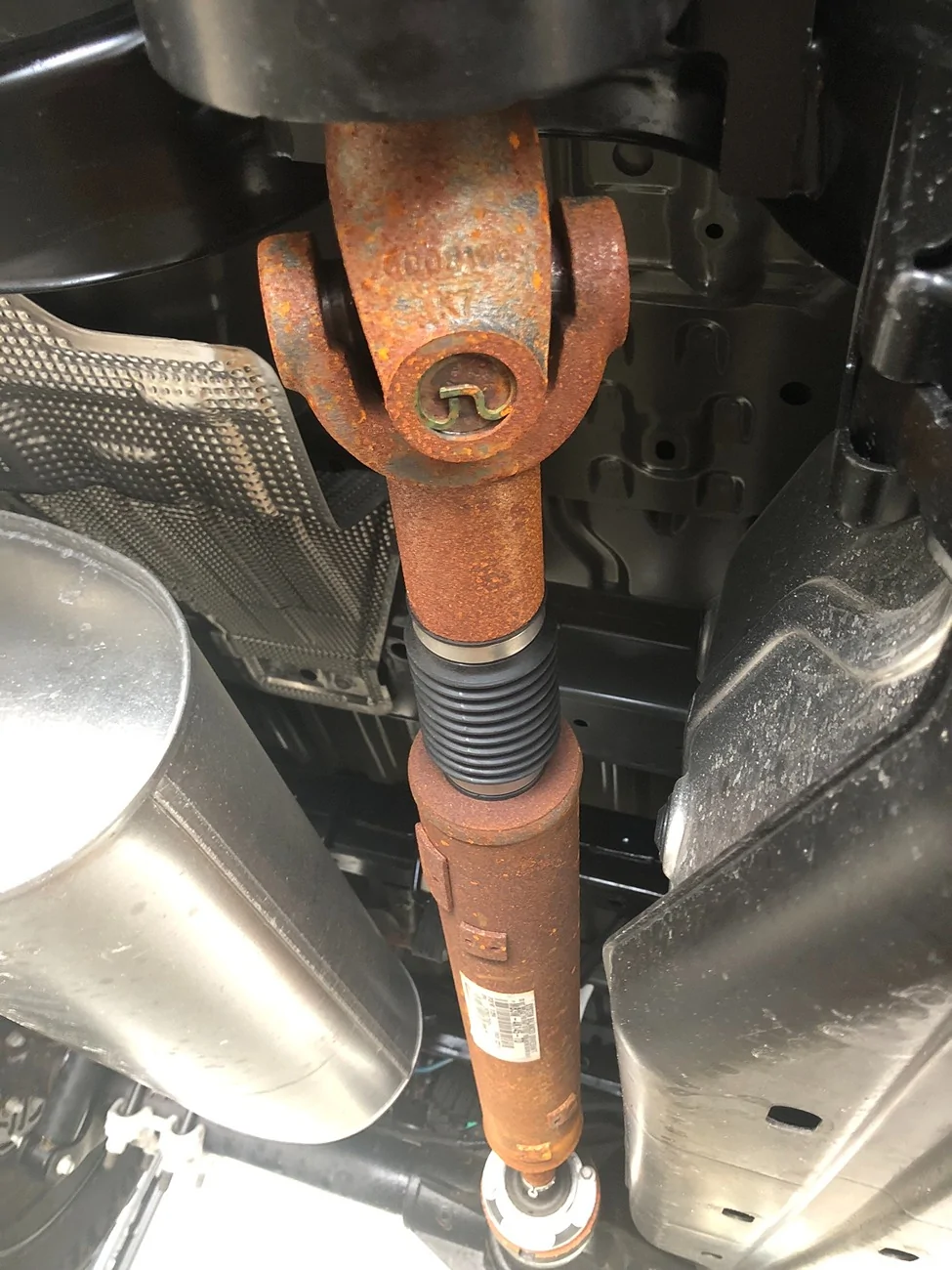

I used to be a designer for a couple of the big 3 automotive companies and I remember we had specific engineering requirements for corrosion protection for virtually every part on the vehicle (e.g. paint, galvanized coating, electroplated, etc.). Parts were required to endure so many hours of water and salt spray to make sure they didn't corrode prematurely.
I just bought a new 2026 Ranger and when I got underneath to my horror I observed several drivetrain components such as the driveshafts and axles that were severely corroded (see attached picture). I've never seen a new vehicle with so much rust under it. The funny thing is that they went through the trouble of painting the truck's frame rails with a glossy black paint, but they neglected so many other parts. Something seems strange?

You’ll notice this on a lot of new trucks—not just Ford. The driveshaft can look “rusty” the day you take delivery, but it’s usually just light surface oxidation, not actual corrosion damage.
A few reasons why Ford (and most OEMs) don’t paint steel driveshafts:
- Coatings vs. paint: Most steel shafts have a thin factory coating (phosphate/e-coat/oil film). It’s there for basic protection during storage and transport, but it’s not meant to look pretty long-term.
- Cost vs. benefit: Painting adds cost. From an engineering standpoint, surface rust doesn’t impact function, so it’s not worth it to them.
- Durability margin: The steel is thick enough that surface rust is almost always cosmetic and won’t affect strength for many years.
So what you’re seeing is normal—even on a brand-new truck.
What you can do if it bothers you:
- Apply a corrosion protectant like Fluid Film or ACF-50 (I use ACF-50)
- Light prep + coating: If you want it to look better, you can: Wipe it down / lightly scuff with a Scotch-Brite pad or sand it
- Apply a rust-inhibiting coating or some people will paint the drive shaft
Bottom line: it looks worse than it is. The rust is cosmetic, but if you’re the type that likes things clean underneath, a quick protectant goes a long way without messing with balance.

I sprayed blaster surface shield on my drive shaft and body underside.
i figured if anything is out of balance it will just throw off the lanolin.
the drive shaft has a nice dark patina to it now.
your drive shaft looks about right, for Florida 😄
is that brand new off the lot?

Yes, it's only been at the dealer for 6 weeks.

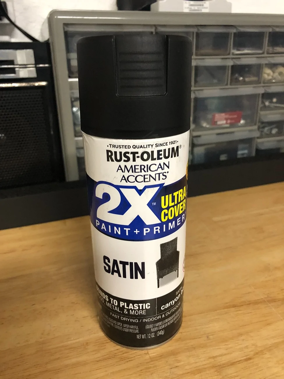

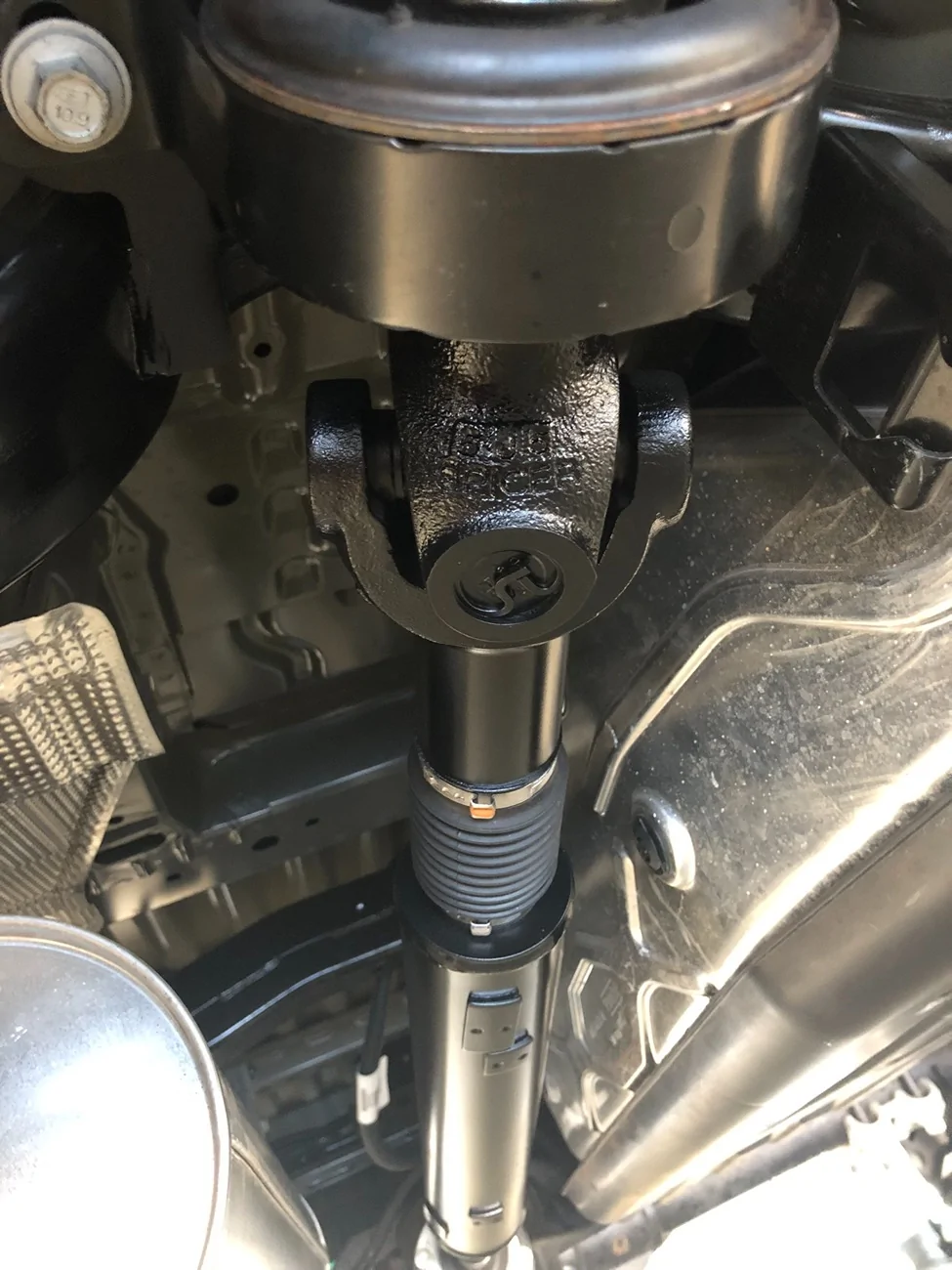

The rust was worst than it appears (very pitted). I spent about 20 hours wire brushing, sanding, cleaning and painting to do both driveshafts. But it turned out nice (see attached).

i think that rust looked plenty bad. Nice cleanup!

Thats how they all look after 5-10 years in New England. That they start rusting immediately after driving off the lot matters not to most of us.....but nice job with the rust-oleum satin black. That looks nice:sunglasses:

Looks nice after paint. But I wouldn't have spent time sanding and brushing. I use a rust converter like one of these. It converts rust to iron phosphate, leaves a protective finish and is paintable.

Yeah thanks, I've used Rust Mort. It works good on light surface rust, but it doesn't look as smooth on the more pitted surfaces. I did use a rust neutralizer on the project, but I cleaned it off with NAPTHA before I painted.

Adding to that is driveshaft balance. Uneven paint, especially heavy powder coats like used on chassis parts, can throw off the balance of the drive shaft and cause vibration. If chunks of paint come off over time as is common with undercarriage parts, the issue compounds.
And drive shafts / axles spin at high velocity, so even remotely loose paint will start to de-bond from the surface and come off, leaving uneven weighting.
It's more than just cost; it's to maintain functionality over time as odd as that might seem. Let it oxidize. Won't hurt nothing. The ONLY place you might want to use a little coating (i.e., a rust reformer that encapsulates), very light amount, is on the balancing weight welds.
My parent's 2015 F-150 has had FOUR drive shaft replacements (yes, they still have it, just over 100k miles now), the balancing weights fall off because the welds corrode and break (they just use light tack welds), then the drive shaft is out of balance and entire truck shakes like nobody's business.
That's the only major issue they have had with the truck, has been great aside from that stupid problem and Ford for some reason never changed the design for those MY.
