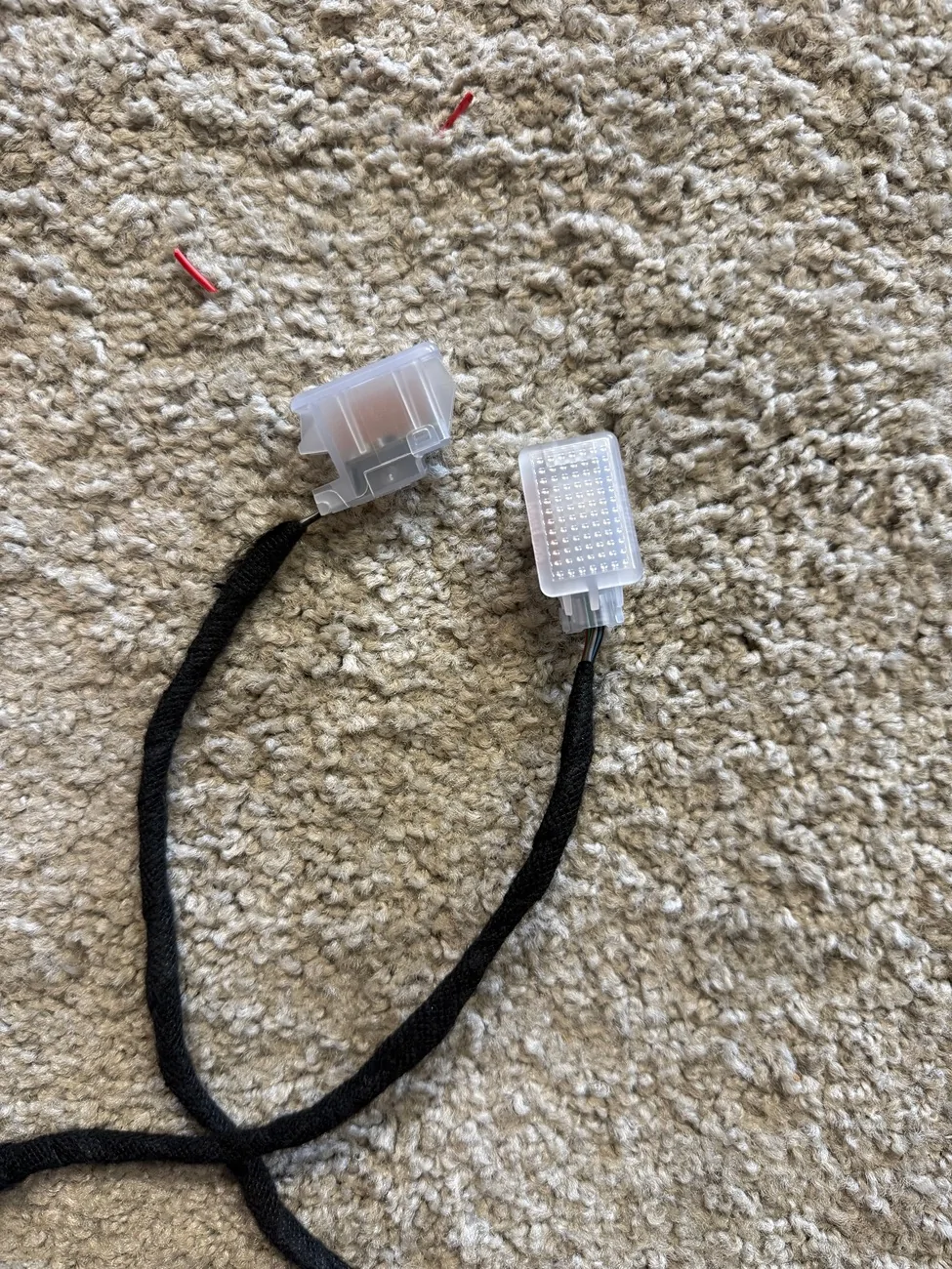

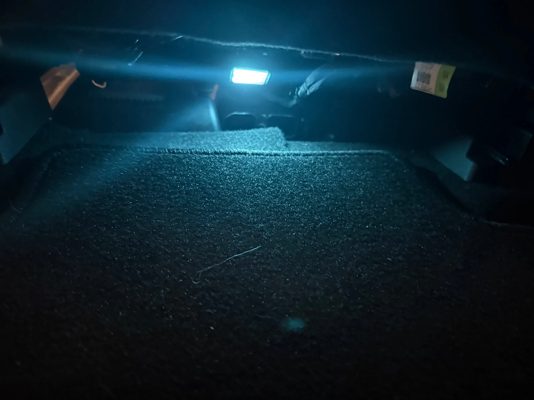

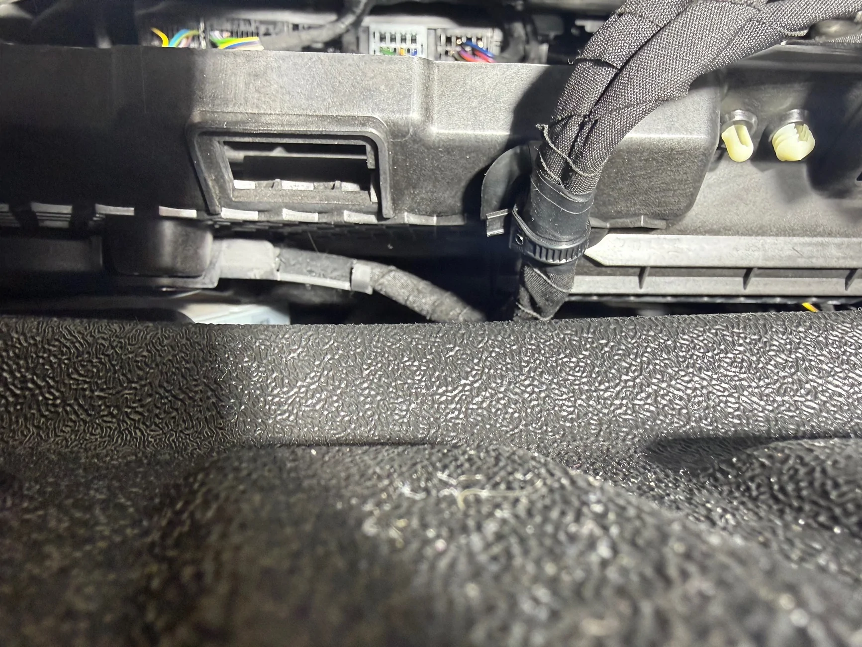

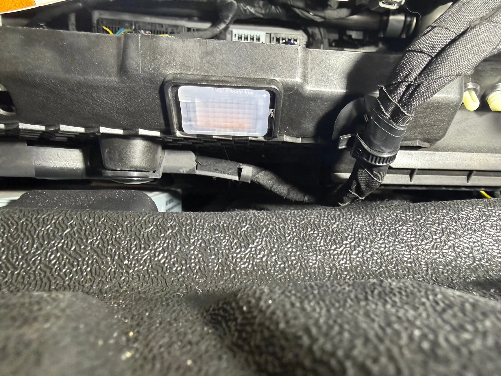

Bought ambient lighting that goes under the seat in a 2021 F-150 seeing that our seats in the ranger have the same spot for it. Tapped into the ambient lighting in the dash then.

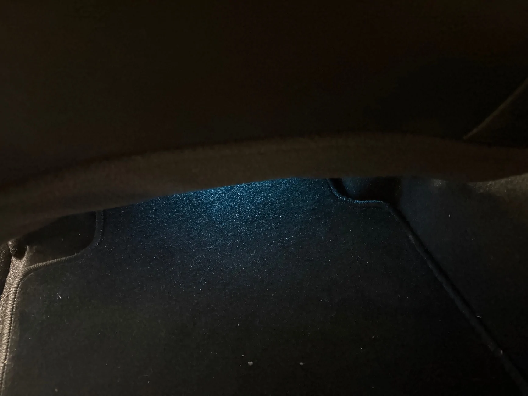

tell us more! does it only shine backward into rear footwell? or also forward into front? Couple more pics to show how much light it adds? How long to install and $$ for the parts? Thx!

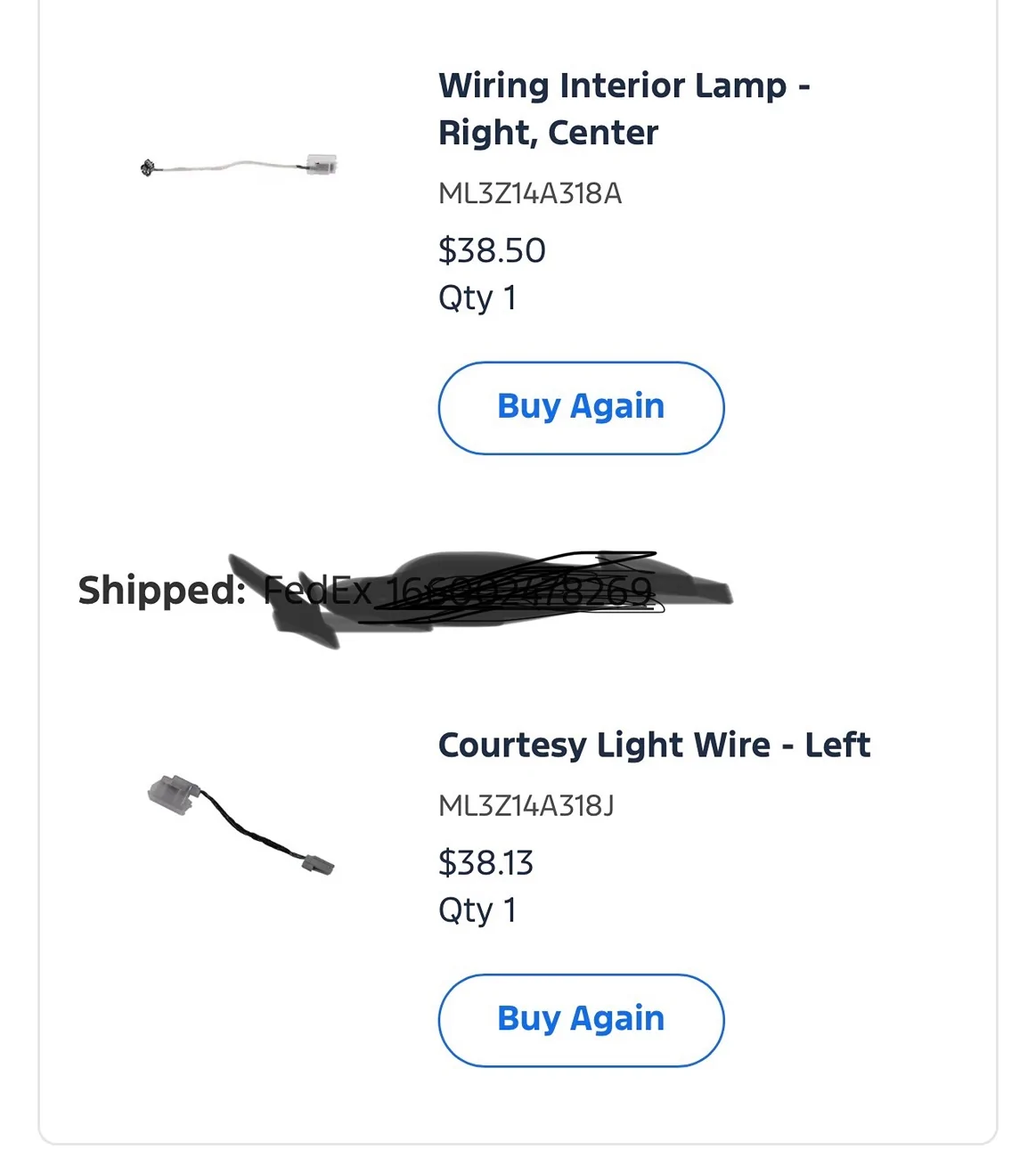

Sorry for the delay. I attached a screenshot of the parts I used. You can only do this if you have the ambient lighting that comes with the truck unless you are wanting to tap these into aftermarket ones. It wasn’t hard tapping into the existing ambient lighting in the dash as you just have to run the wire up to the glove box. The hardest part was dissembling the upper part of the glove box to get to the ambient lighting wire and tapping into it.

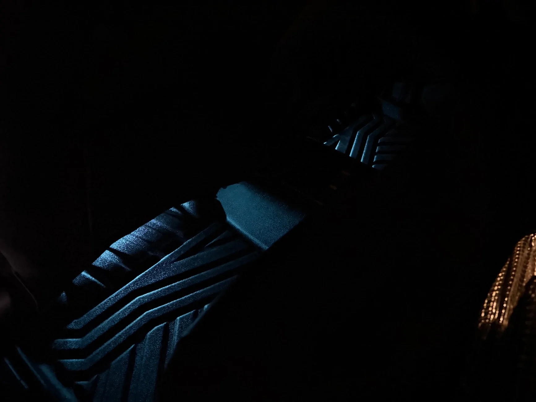

Attached is a picture of how much light you get. Looks good in my opinion and I’m very happy with it. The ambient lights were around $80 with tax and that is a light for each seat. I posted a pic in the thread of the part numbers and cost of each light.
