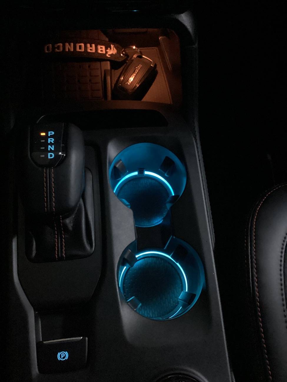

Something like what the Bronco crowd did in this thread may be needed for us. Seeing as if those are 3 wire leads (aRGB), that gives me hope for a simple plug and play swap using similar hardware they dug up
Bronco Ambient Lighting

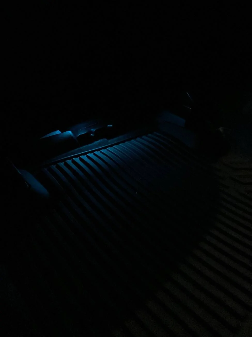

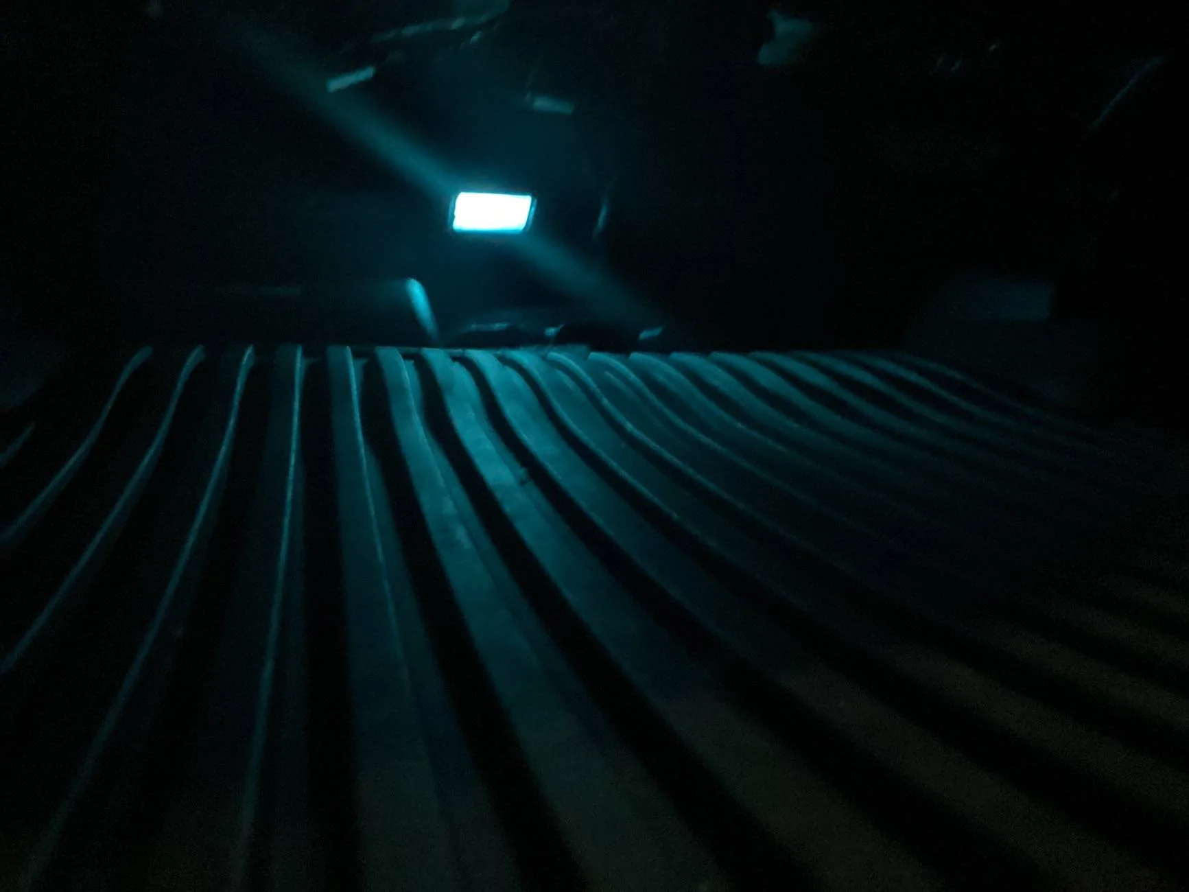

Should work on the Ranger. This is what I did on my Bronco Raptor and then installed on the Ranger Raptor. The only difference is I used single color blue ice LEDs because they were a lot cheaper and it is the color I like since it matches all the factory buttons and switches.

Awesome job!! What module was that in. We need to start putting together a sharable doc with the things we can make changes to.
@Stumpm2 was correct, it's the APIM. Really wish there was a spreadsheet already.
I plan on swapping out for RBG's (thanks for the Bronco link BTW!) but it will probably be a while. The Raptor is the newest of many projects I have to work on. Parts usually collect dust. My CTS-V is starting to get a layer of dust lol.
But yes, it has been fun trying to figure things out on this truck.

You need to replace the installed leds with rgb leds to get the color changing to work after adding in Forscan. I only had blue ice leds for the cup holders and rear seats when I added them to the Ranger Raptor and just went with that. The shifter and all other buttons are blue ice so I think it works.

Sorry, I do not have the part numbers I used as I did this to my Bronco over a year ago and just took the parts out. I used the cupholder in the Bronco6G posts, but used single color blue ice LEDs that I do not have the part numbers for. I remember the single color LEDs were over half the cost.

So the bronco and the ranger have similar cupholders? or did you have to modify anything.

I used the same modified Lincoln Corsair cup holder on the Bronco and Ranger. The Bronco and Ranger cup holders and close if not the same.
