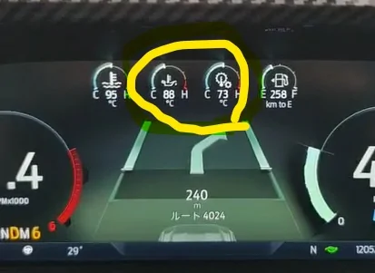

1. I drive a 2-liter diesel. Is it possible to change the device in the photo to a voltmeter?
 I enabled the Battery Voltage Display on the Forscan IPC, but nothing happened.

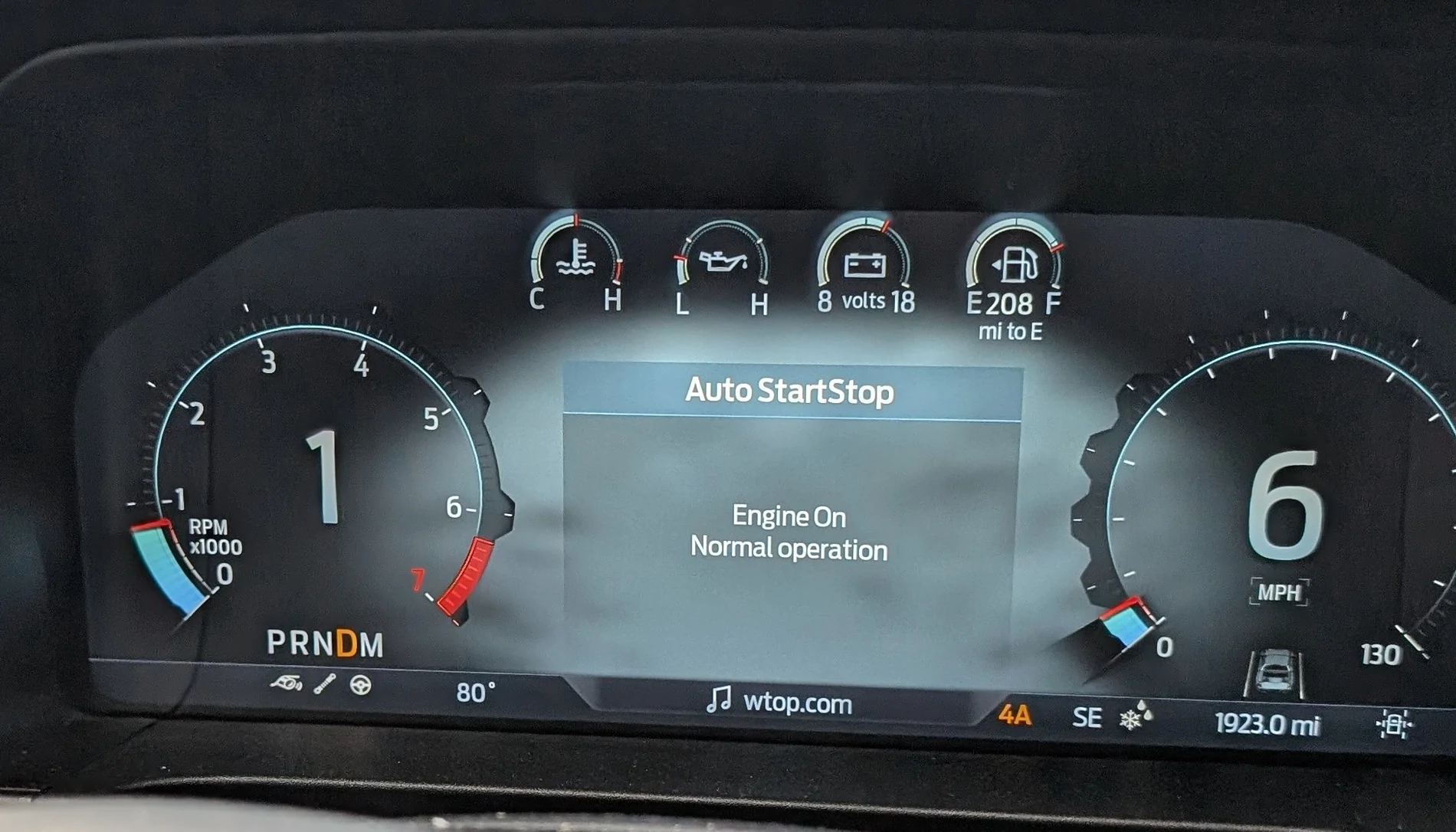

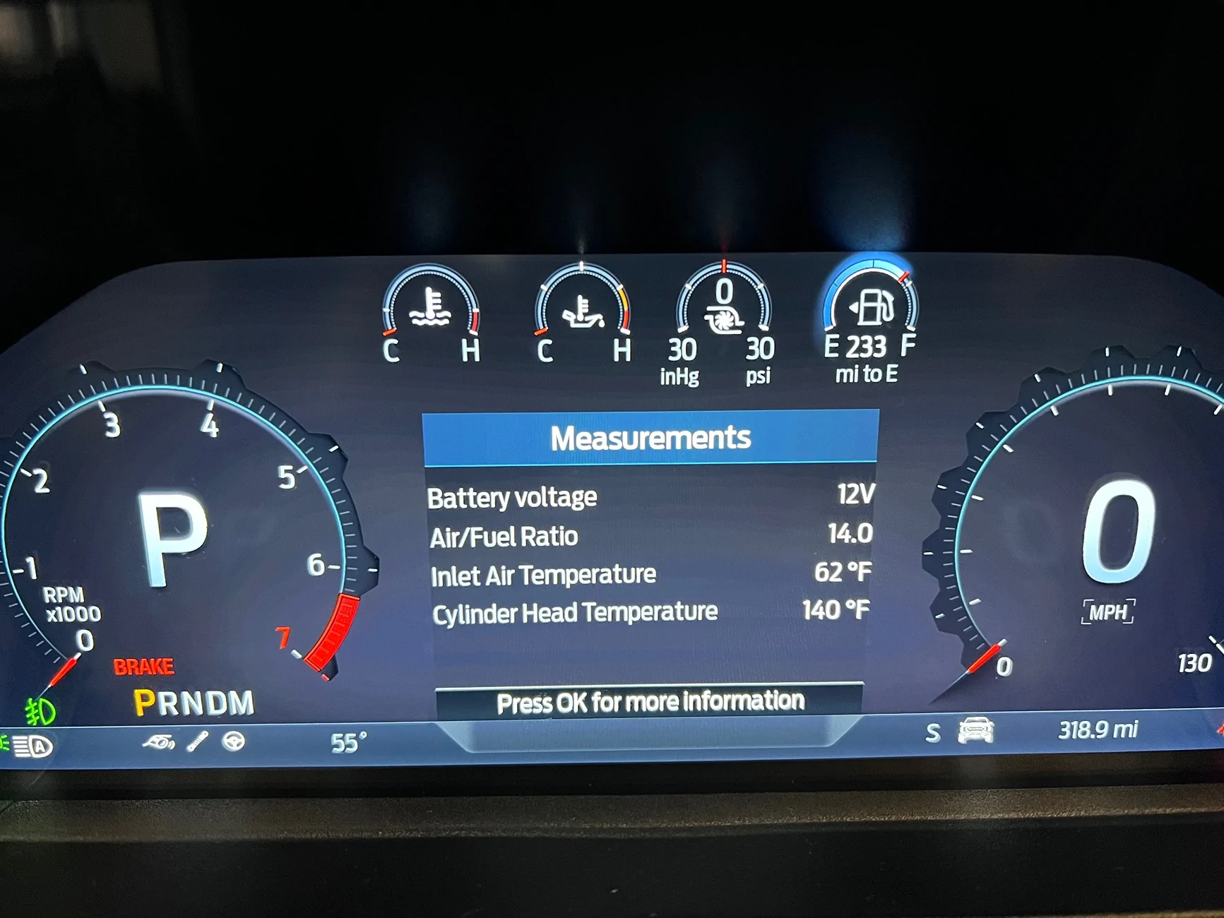

I’m not sure if this is available on the smaller clusters, but you can configure voltage. You can enable it in “measurements” on my view. Also, do the Lariats come with the larger clusters?

Yeah, you can. At least on the US model with the large cluster. I don't think it's as helpful as I would prefer. I would like it to show me the exact voltage as a value not just a gauge. The one in the measurement in My View isn't all that great either. There is a huge difference between 12v and 12.6v, for example.

I'm thinking this option might be Raptor-specific. I hope I'm wrong, but I don't see that option in any of the drive modes in my Lariat.

Agree on the lack of going down to tenths. Disappointing
