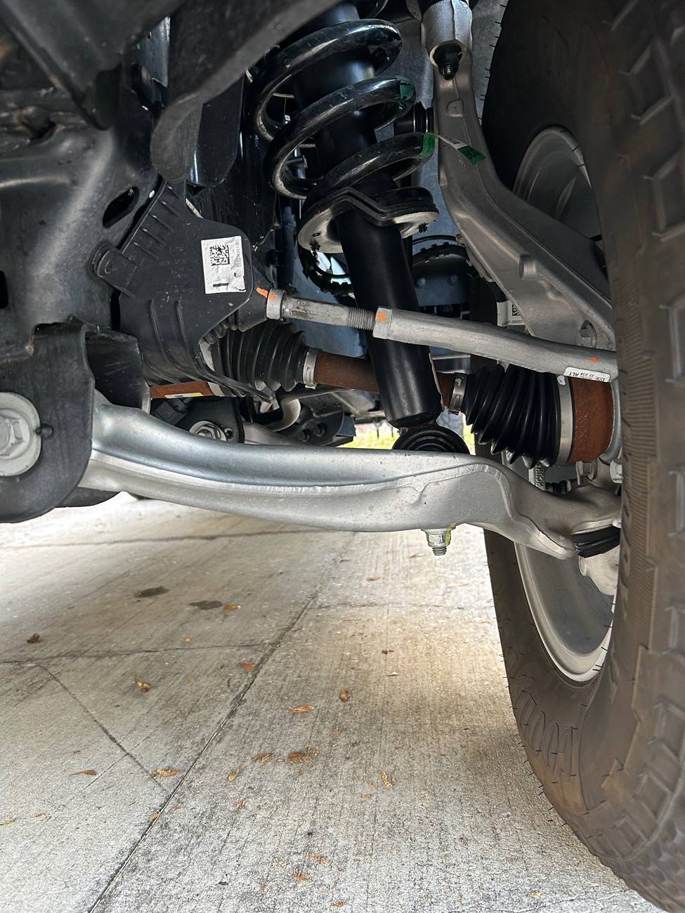

For shits and giggles take a picture of you cv joints
Ford Ranger What did you DO TO your 6G Ranger today? 🧰 🛠️ ⚙️ 🧽 IMG_2024
Here was a quick picture taken from the front driver side. The kit came with a differential relocation bracket so my CV angles are actually looking pretty good.
Thoughts?

i was going to say that those don't look bad at all

Funny, the only reason I questioned this setup was I looked at the install and I didn’t have a step for the diff drop, looked at it again and there it was! Pretty good deal for this kit!

Yeah I am real happy with how it turned out. I’ll post updates next week after I put on the 33 inch tires and do another alignment.
I’m still waiting to see what Bilstein, BDS, and Fox release in North America for this truck. Hopefully the wait will be worth it lol

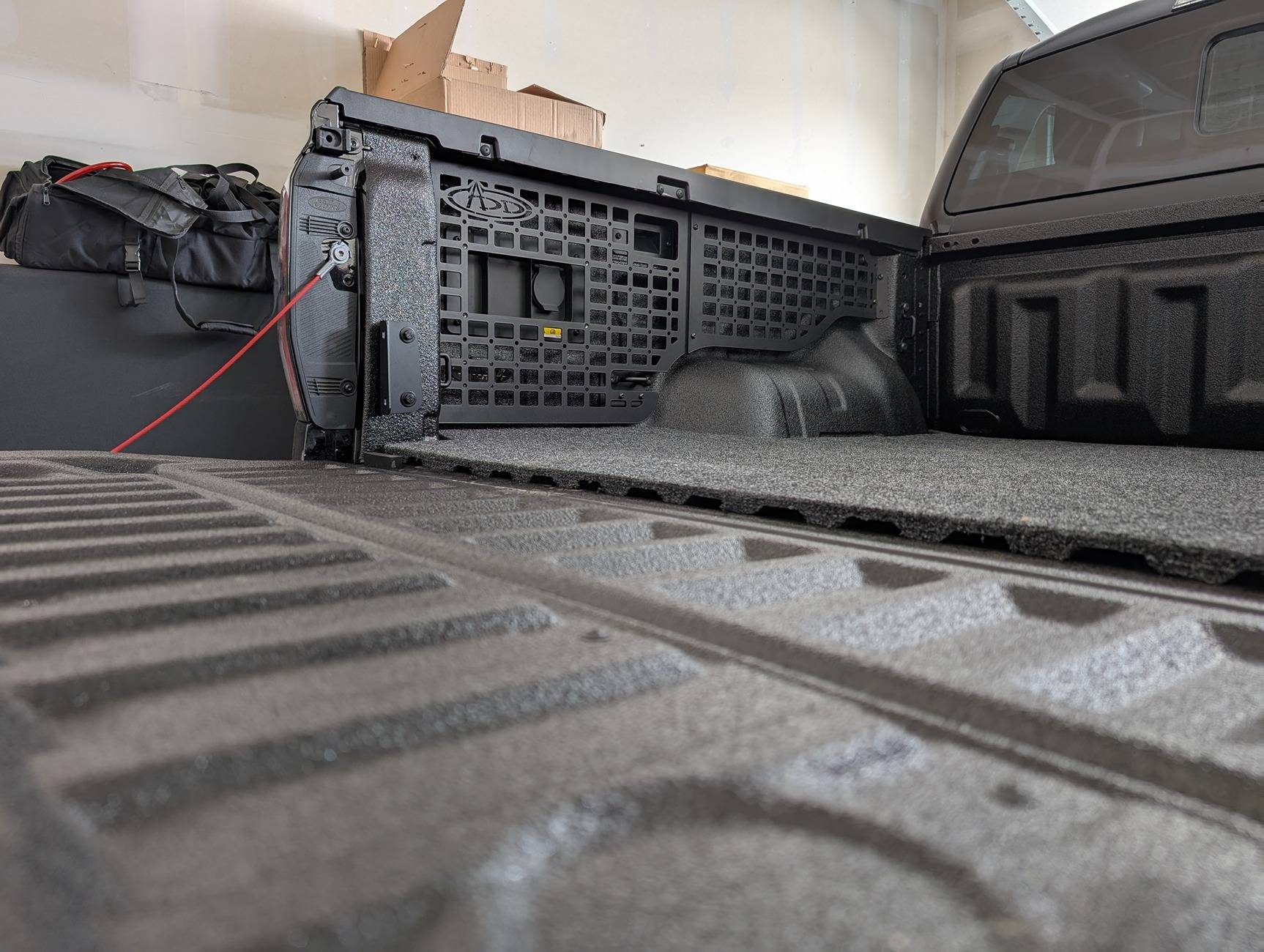

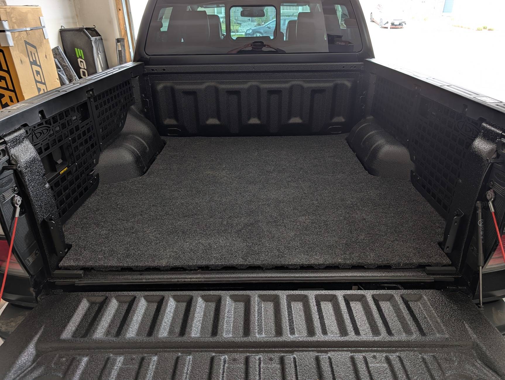

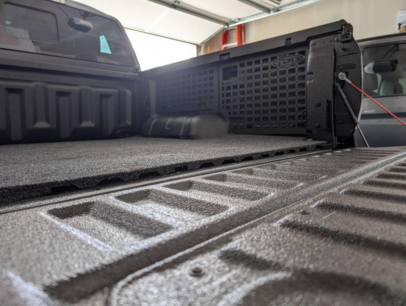

Installed the ADD off-road molle panels and a bed rug into the Raptor.
2 things:
-ADD molle panels aren't exactly aftermarket bedliner friendly. The tolerances are pretty tight and there was no way to get 2 bolts into the furthest forward tie down point. It seems sturdy enough without a 2nd bolt but ADD should probably loosen up the tolerances a little to allow more play.
-The Ford installed M8 bolts for the tie downs can kiss my whole a$$. Each one needs heat and the luck of the Gods to extract. Plus they are very soft. I rounded one head, then snapped the head with the extractor, then I snapped the extractor off into the threaded bolt. That thing is gonna be in there until this thing goes to the crusher.
