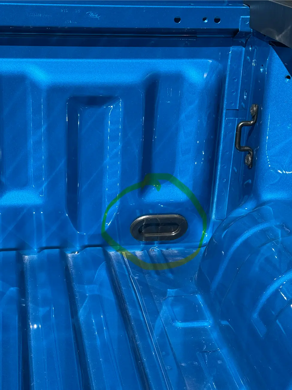

2025 Ranger Lariat
I am getting ready to install a Bakfip cover, which comes with drainage tubes. ( My last two did.) Can I assume the black plug at the front of the bed that I have circled in the photo can be cut and used for drainage? Is that what it is actually for or does it have another function? Thanks

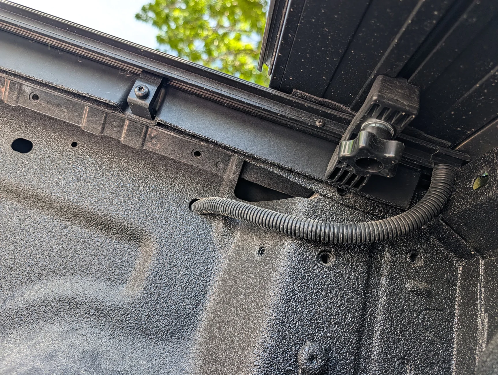

I used the area under the rail rather than drilling through those plugs. Drilling through the plugs is the recommended in the instructions. I didn’t want to drill them because they were covered with factory bed liner. Been like this 2 years with no issues.
That's perfect. I didn't even notice those holes until your post. That is what I am going to do. Thanks!

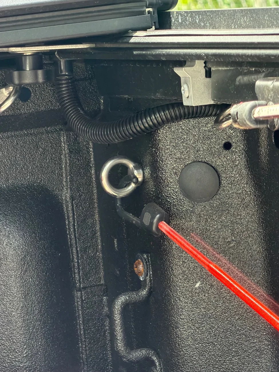

I also used holes already in the bed
I did not like running the tubes down because a could just see loading something in the bed that
would mess up the tubing.
