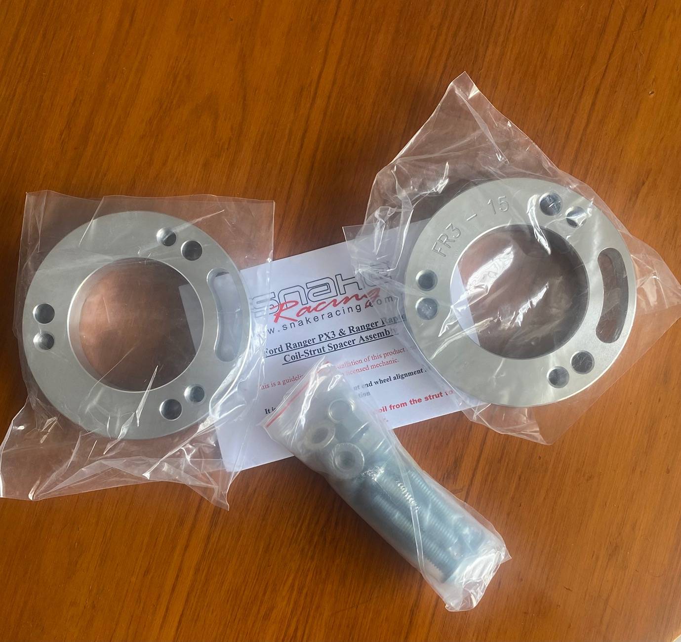

Yep, on my F150 Raptor, I could feel the firmer ride with a Perch collar. On my Ranger Raptor with the 15mm strut spacer, it feels exactly the same as stock. I ordered it from this site in Australia. Overseas shipping was economical and it arrived very quickly.
https://shop.snakeracing.com.au/ranger-raptor-front-coil-strut-spacer-kit-25mm-lift/

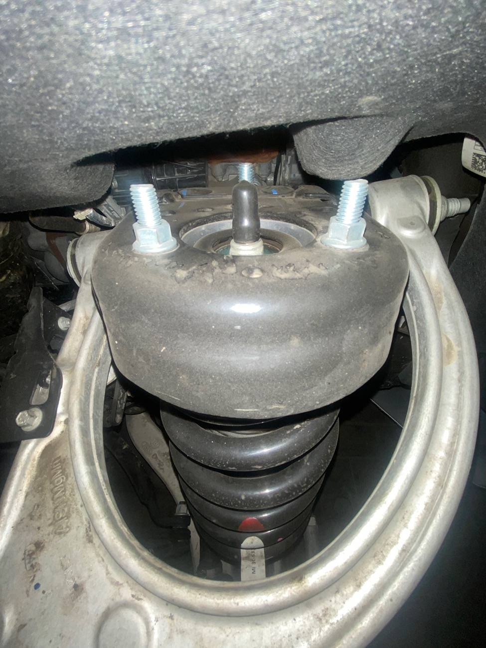

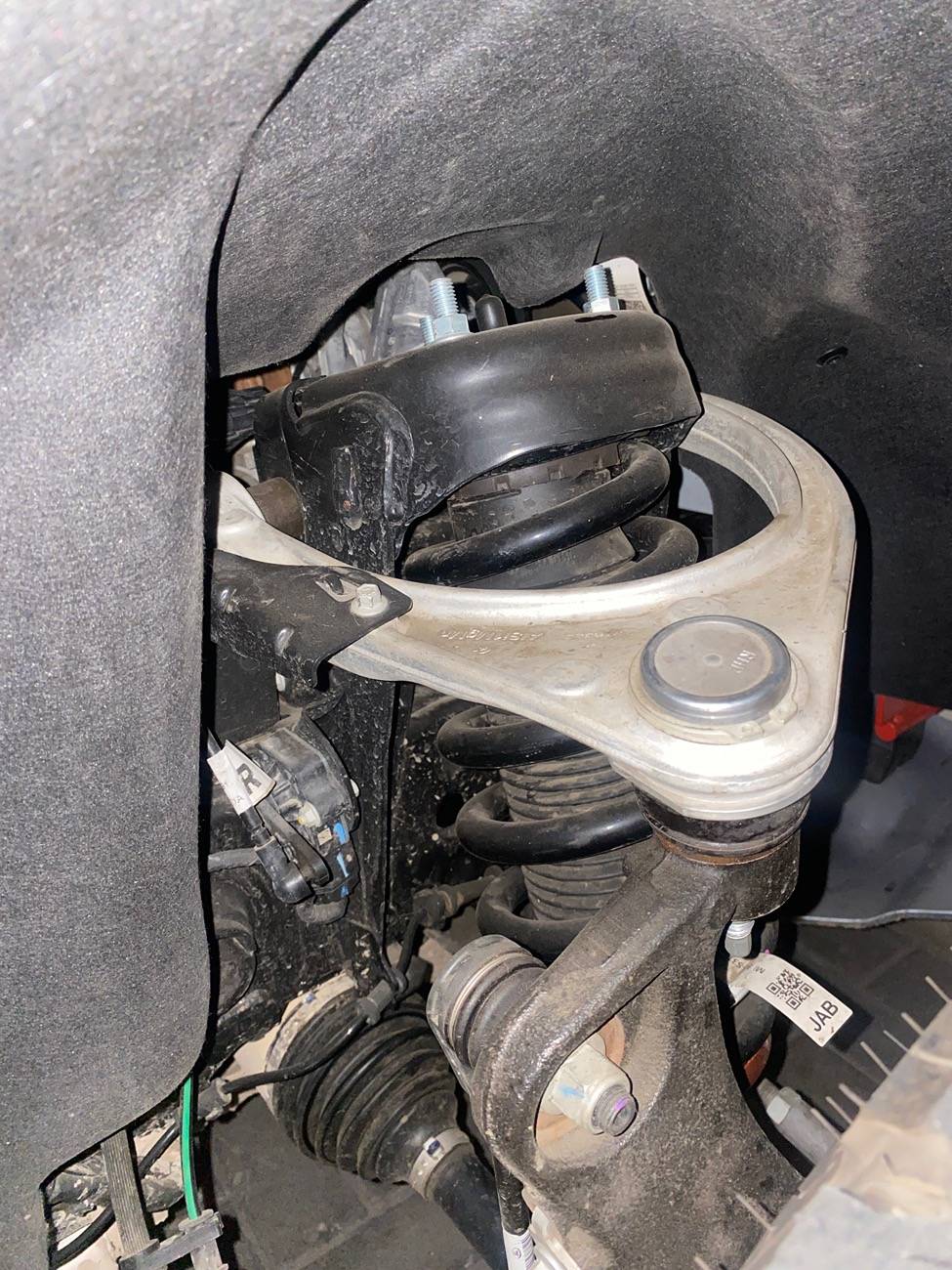

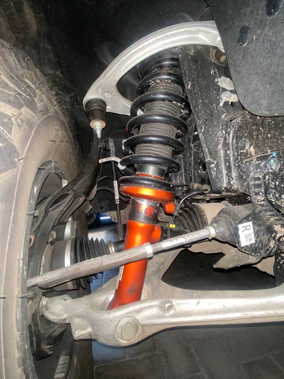

If your suspension looks like this, they will fit (the studs are from the kit) There is a video of a US spec Ranger Raptor posted on this forum with detailed views of the suspension, and it appears to be identical. I hope you can clear this up. Cheers!
