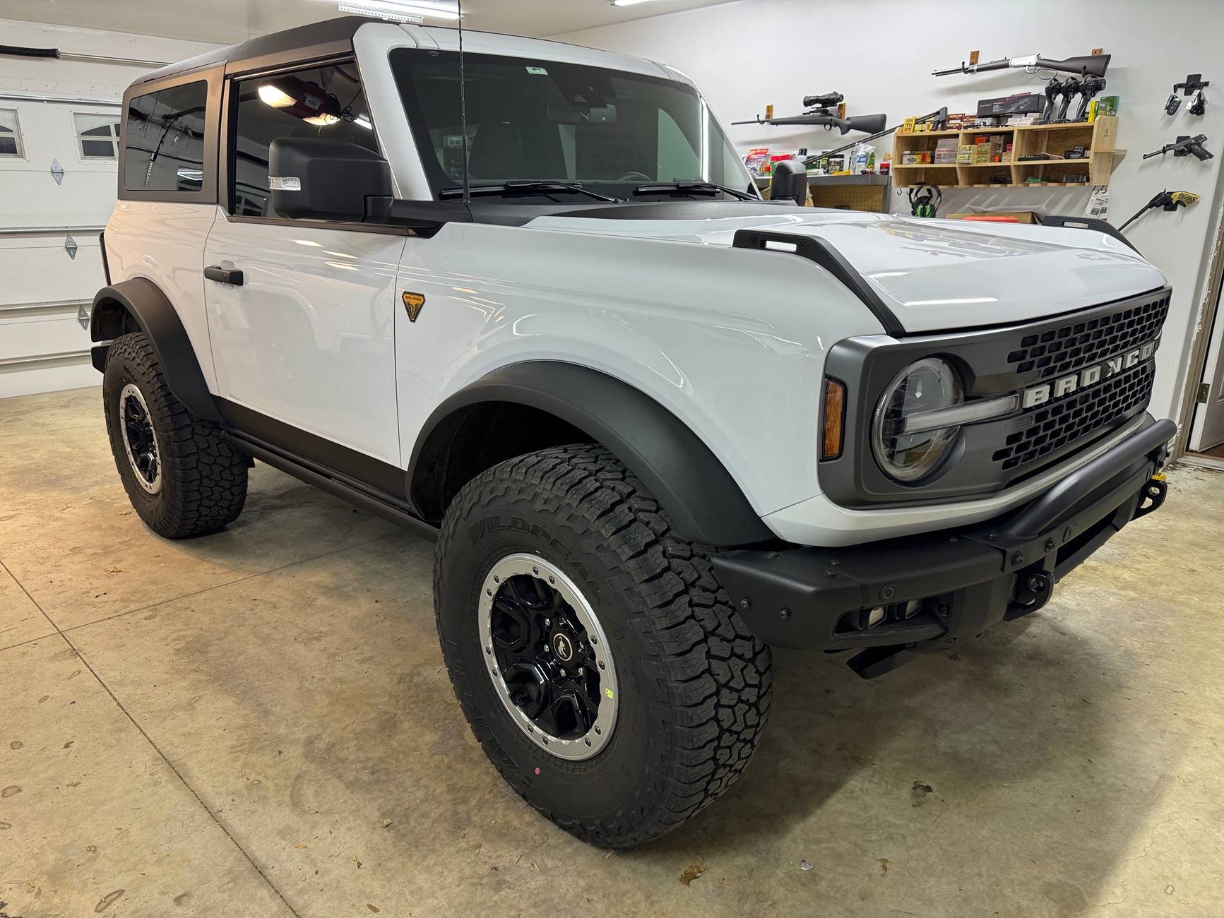

Anyone know what the Bronco SAS wheel is in terms of offset. Also just guessing the Bronco uses the same bolt pattern. I had given some thought to using the Bronco Rims to get a little more offset.
I do like the looks of my Bronco Rims better than the RR rims.
Maybe or likely would need to drop the tire size down to say a 34" tire.

Does anyone have the bronco Sasquatch wheel‘s offset. Just guessing it might be close to the +35 I am looking for.

I found the spec of the 17” Bronco SAS wheel. It’s a +30
i like the looks just hate the RR +55 offset.
