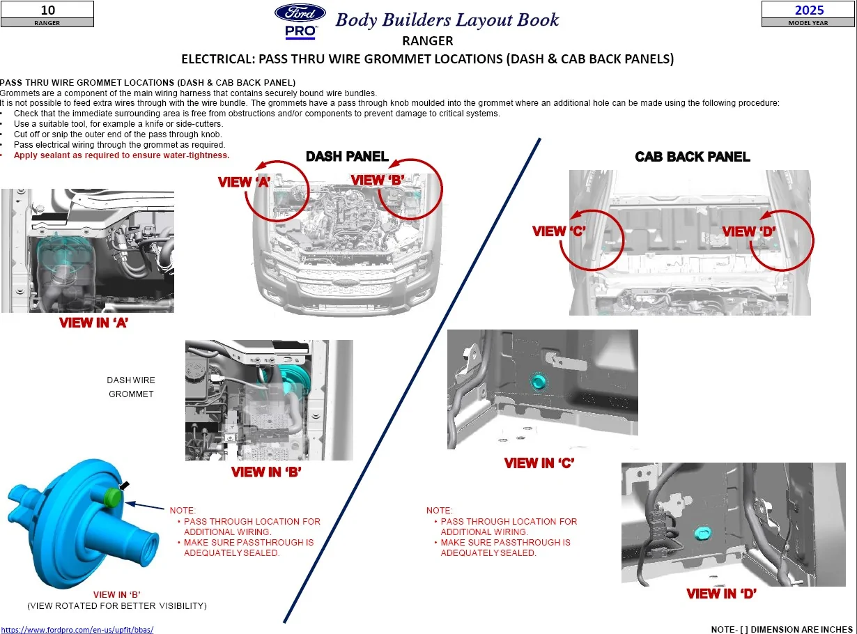

I'm looking for ignition switched power for a relay so just a few milliamps. I found some in the under hood fuse box but that box is well sealed and no way to exit with a wire without making a hole in it. If I use the body control fuse box under the steering wheel has anyone found a good place to come through the firewall? I have fuses in the slots for the inverter and for the wireless charger and wondering if I can maybe just tap into one of those circuits? There is an un-used slot (#1) that has pins but I can't get any power from it key on or off, unless engine actually has to be running.
Edit: Disregard, I found it in the body builder's book!
