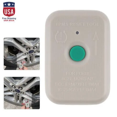

Hi @Tunisian @Bravofox
Once sensors are installed inside the tires. You must train them. You can follow the instruction from this video to enter training mode:
Once in training mode. Its either you use TPMS tool activator or let air out from the tire you are training until you hear a honk (havent tried air out method).
Ford Ranger TPMS Enabling on a New Gen Ranger: How to? TPM Tool
Thanks allot!
This procedure does indeed enter the learning mode. However, the letting air out method does not seem to work. Seems that I will net to get the TPMS activator tool...
Anyone with a THINKDIAG or Autel diag tablets could do it for you.
but even after activation and the car confirmation honks nothing happend.
