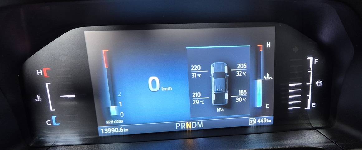

I then used the tool to train each tyre and:
Ford Ranger TPMS Enabling on a New Gen Ranger: How to? 20250218_092553
Success!

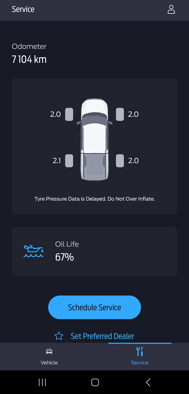

Hi, sorry for the delay. See attached the app shows TPMS.
I wonder if I missed a setting in Forscan. I have done 2 Rangers now and none of them shows the TPMS in die Fordpass app...
Hi
It took more than a week for it to show up in the app. Sorry, I cannot remember exactly how long it took before it showed.
Thanks for your reply. Yesterday morning when I opened the app, I saw both of them showing now. One took 18 days and the other one 8 days to show.

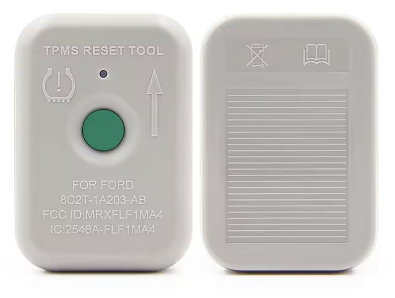

Ford Ranger TPMS Enabling on a New Gen Ranger: How to? Screenshot 2025-03-25 at 13.04.34
I was not sure if I would need the TPMS Tools to make it work so I bought it anyway. It was around 10USD.
LINK: TPMS Reset Tool
Ford Ranger TPMS Enabling on a New Gen Ranger: How to? Screenshot 2025-03-25 at 13.10.09

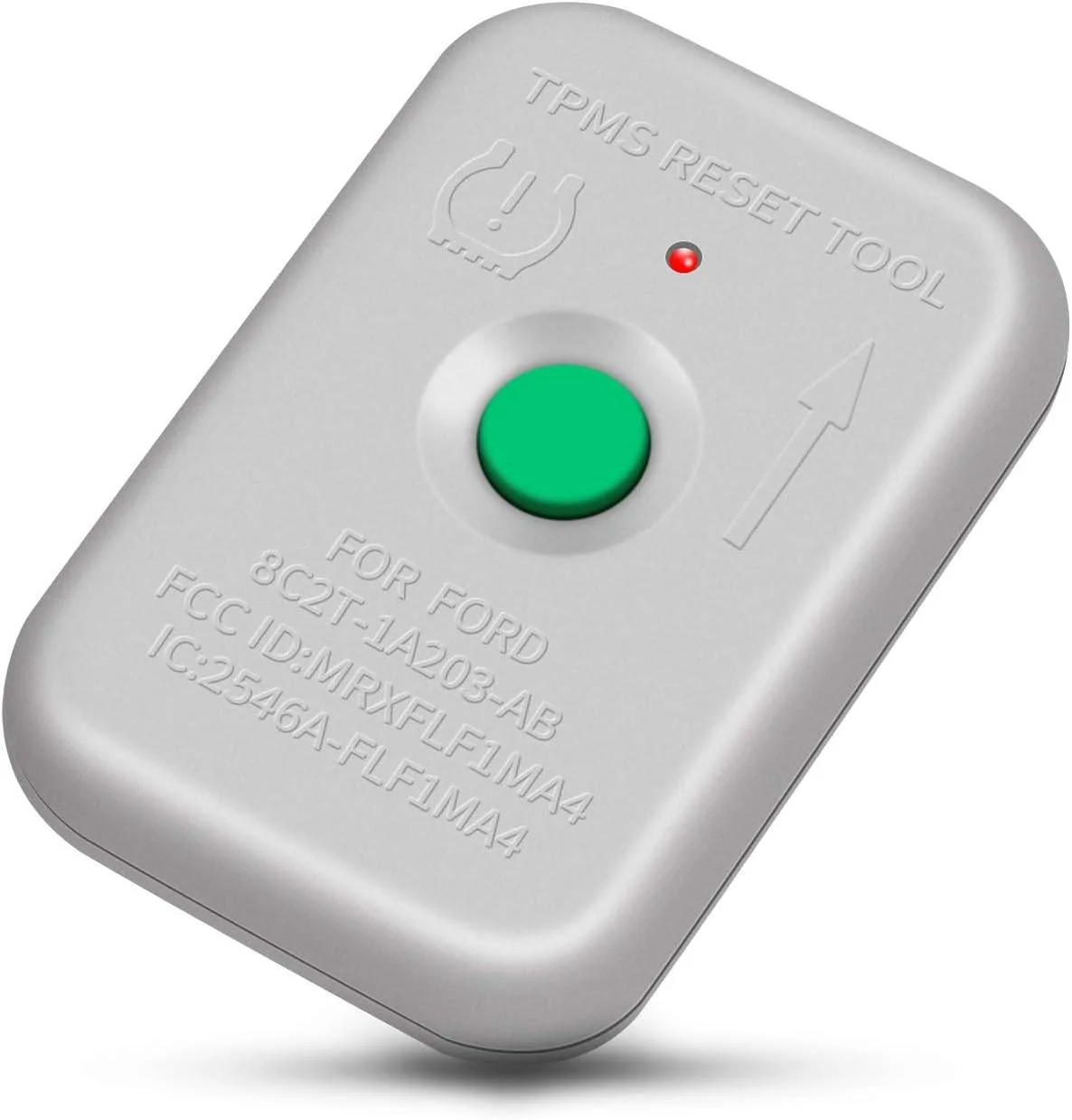

So I bought this tool from Amazon and it arrived yesterday: https://www.amazon.com/dp/B0CZF35C6Z
I activated everything in the IPC and BDyCM modules related to TPMS I could find with Forscan.
I entered the learning mode with the brake and Ignition on and off switch trick as the Forscan one did not want to activate it.
Success!
I want add that I bought the sensors from a local supplier in Cape Town that imports them from Thailand. Thailand and South Africa uses the same 433Mhz sensors.
Thanks for you info.!
I've brought 433Mhz sensors and install them all to the wheels already.
And use this TPMS reset tool but it not respond any signal.
(Already enter learning mode which show up on cluster screen.)
Ford Ranger TPMS Enabling on a New Gen Ranger: How to? 61yOFgGhOiL._AC_SL1500_
I'll try with this activation tool from your Amazon link.
