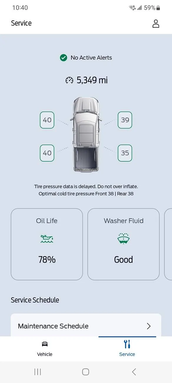

Guys, it has been two months and still no FordPass tpms information. What did I miss?
4,002
3,866

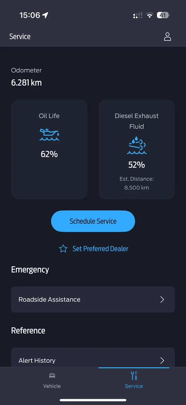

Did you look under service? Its on my fordpass app for my stx
Ford Ranger TPMS Enabling on a New Gen Ranger: How to? Screenshot_20250516_224015_FordPass

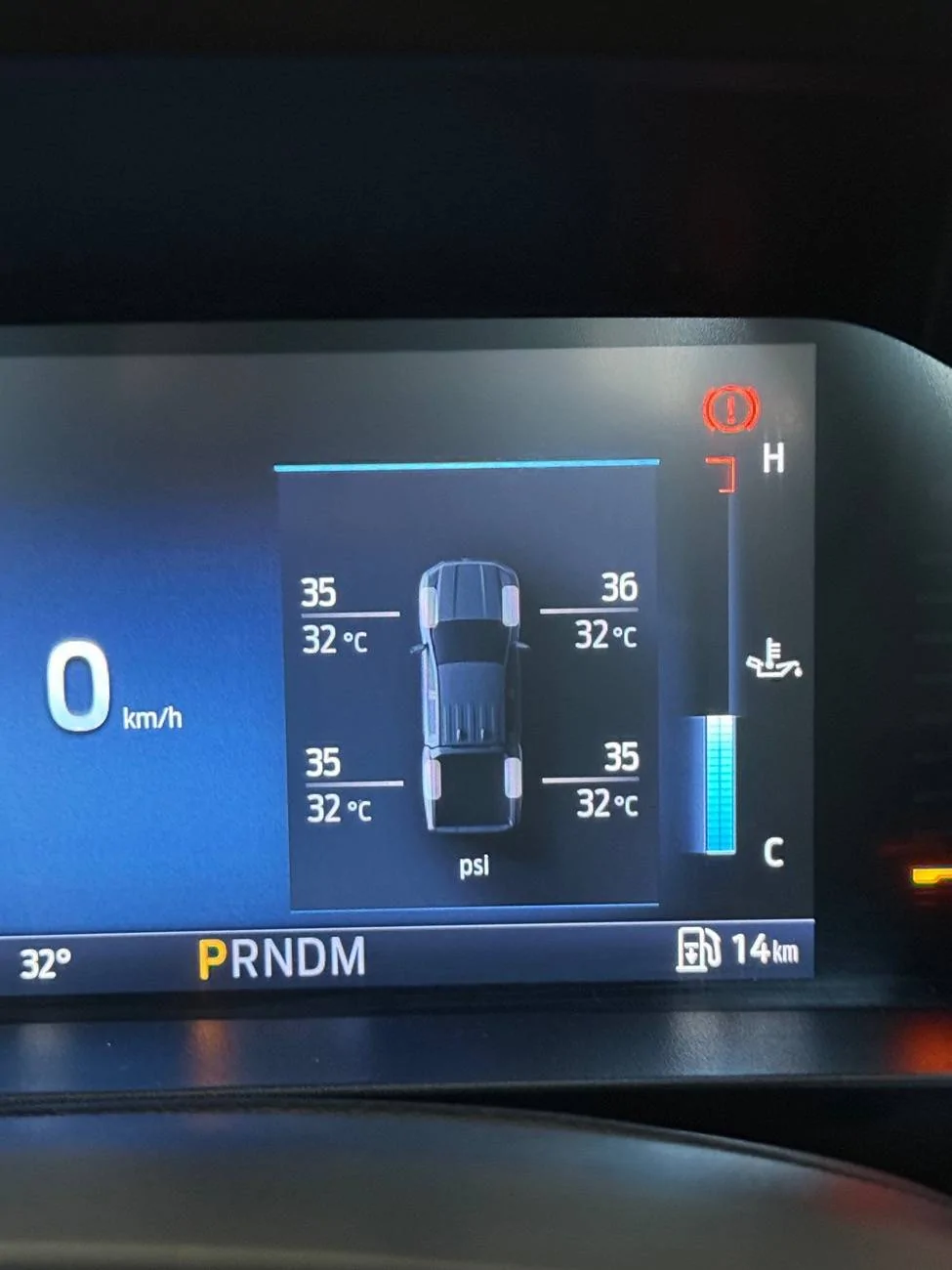

Guys, today I enabled the TPMS system on my Ranger. It's all working pretty well!

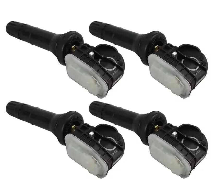

First of all, we have find out what sensor to use. On this post I guess there is plenty of information on which sensor/frequency on each country, but I guess I'm the first Brazilian here in the forum and so I had to dig that information by myself. I contacted my dealership and explained what I was up to. Since my car don't have this sensor, they had to get the VIN number from a LIMITED model (which comes with factory tpms) so they could find the correct part number. It turns out BRAZILIAN RANGER uses the F2GZ1A189AB sensor (315mhz). They tried to sell it to me but it was WAAAAAY too expensive. So I went online and bought it from Aliexpress (from china) from around 40USD with taxes and shipping (just a disclaimer here: I know I could find it even cheaper on the US, but the shipping and taxes would double it).
LINK: 4PC TPMS Sensor 315mhz

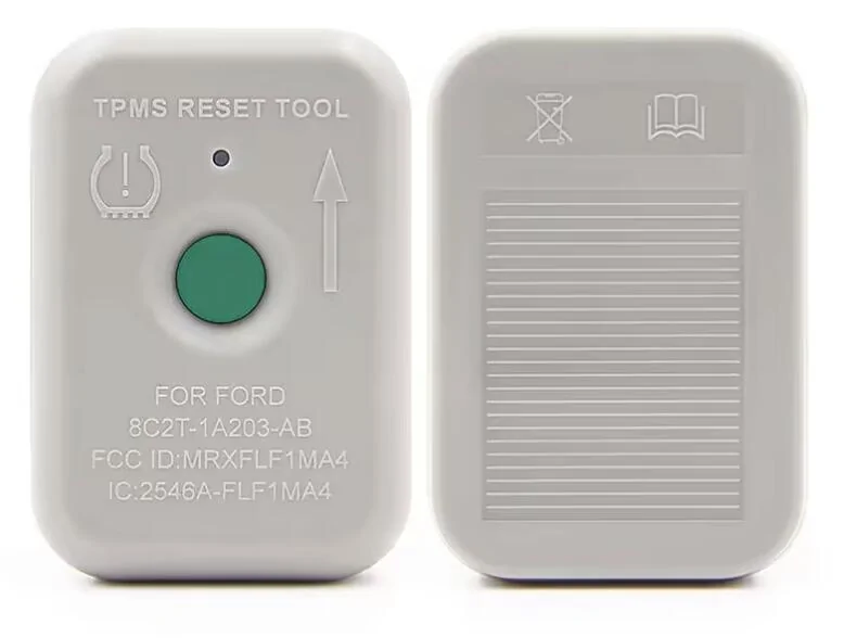

I was not sure if I would need the TPMS Tools to make it work so I bought it anyway. It was around 10USD.
LINK: TPMS Reset Tool

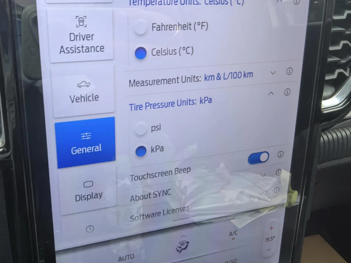

TPMS by Location Units from NONE to PSI (Brazil standard)
TPMS by Location Feature from DISABLED to ENABLED
TPMS - Default units from BAR to PSI
TPMS Menu from DISABLED to ENABLED
TPMS Placard Pressure Display from DISABLED to ENABLED
TPM - Auto Locate from DISABLED to ENABLED
TPM - Temperature Display from DISABLED to ENABLED

After enabling this last one, BOOOOOOM! Got a LOW TIRE LIGHT and a message that said something like "something wrong with your tire measurement system" (not exactly those words).

Now let's see how long it takes to show the info on FordPass app.
