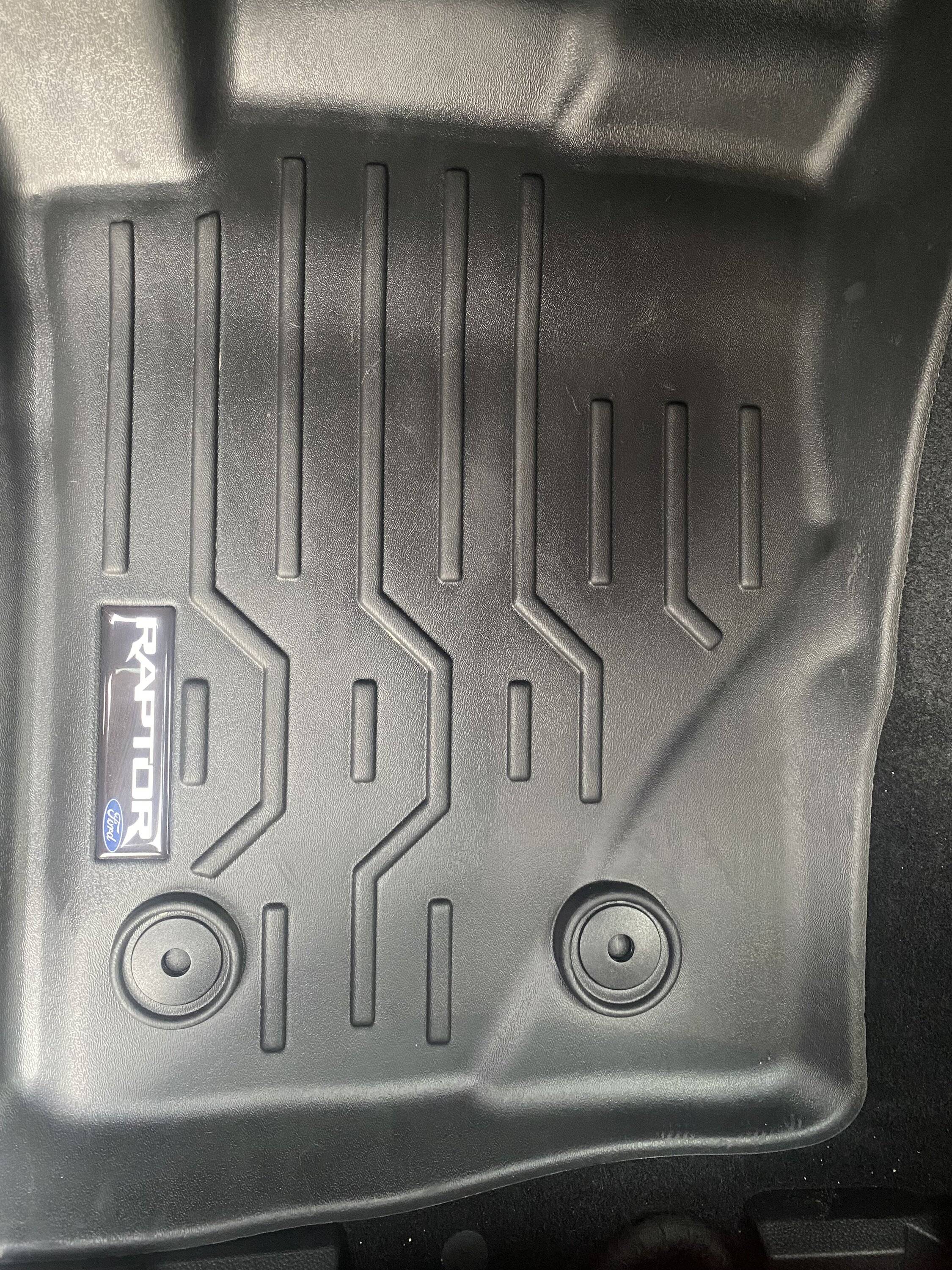

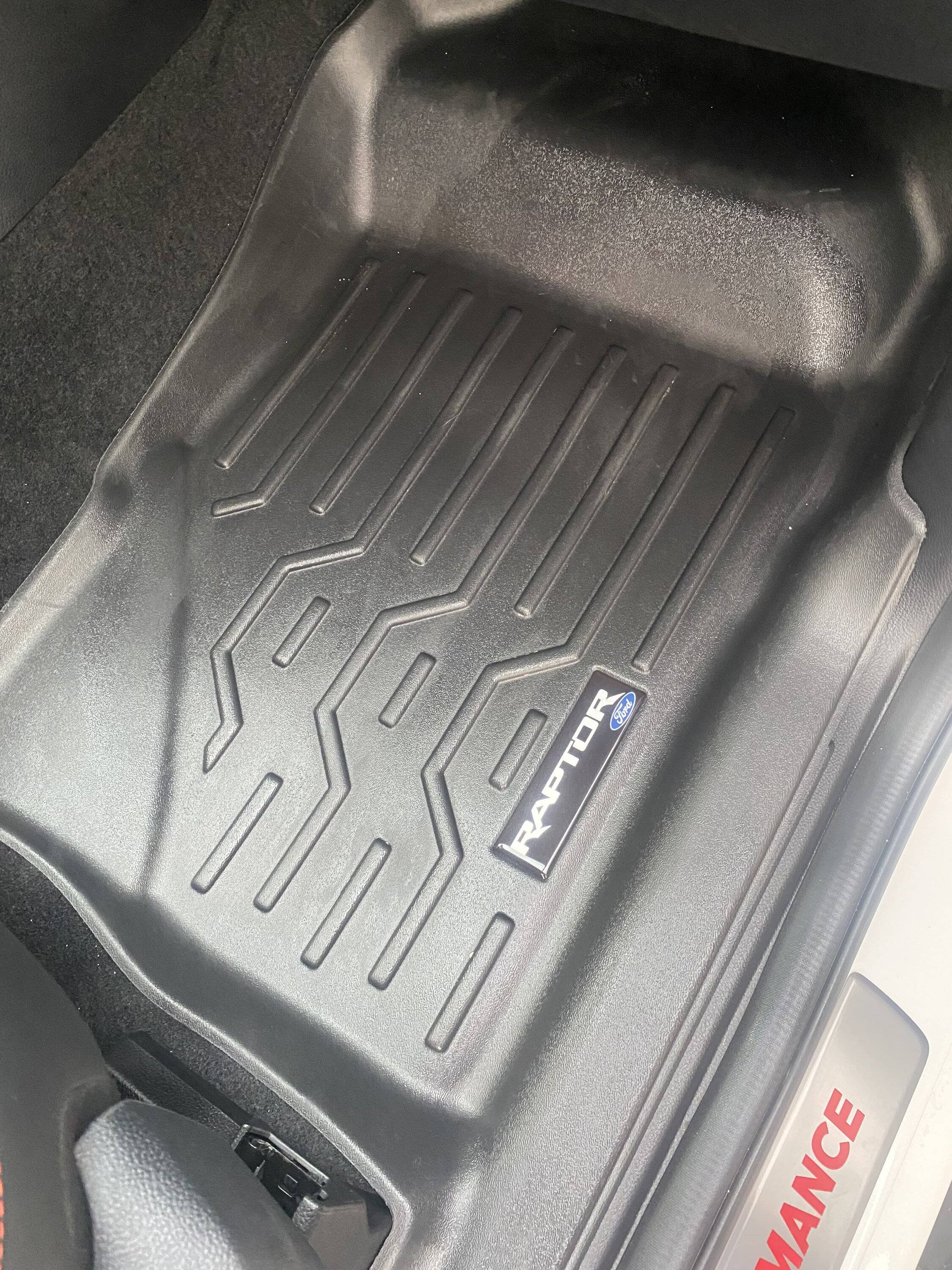

Wasn't happy with Ford's OE tray mats– too flimsy. Since WeatherTech or Husky Liners weren't available at this time, I gave AliExpress a shot. Surprisingly good quality, matches up to Weathertechs in looks and feel. Added some emblem inserts from Tufskinz, and I'm pleased with the overall result.

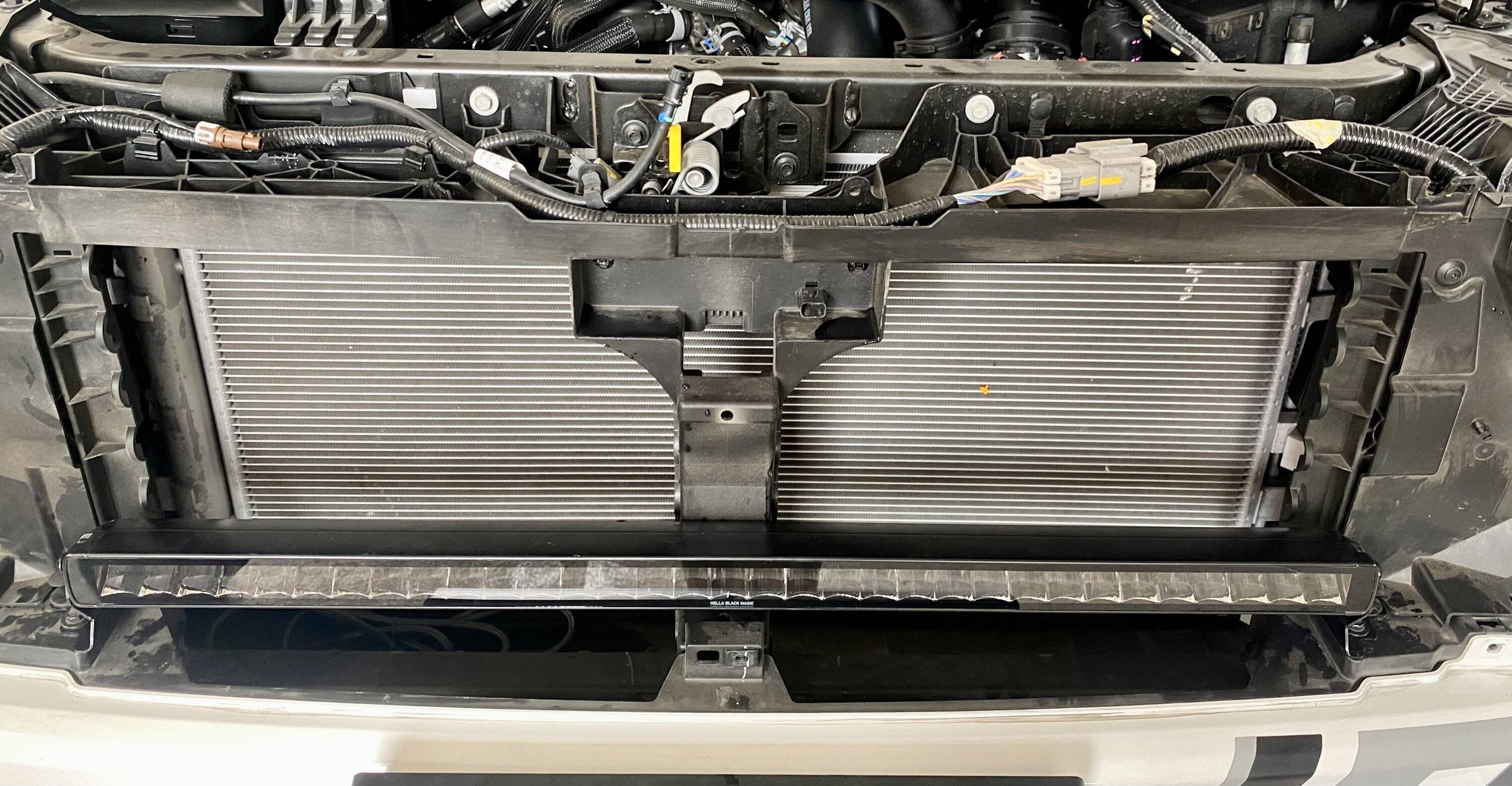

Installed a 30” LED bar behind the grille —easy setup with the original bolt spots. Usually, I opt for Baja Designs LEDS, but this time I chose a budget-friendly Hella Black Magic. It's surprisingly bright, with a beam throw distance comparable to the pricier option. The slim all black design keeps it low-key behind the grille.

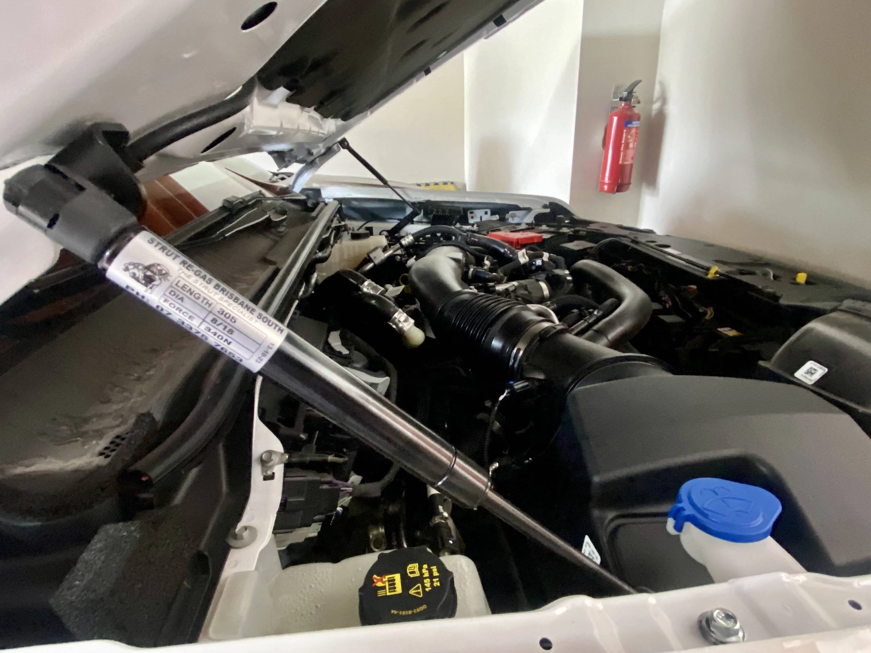

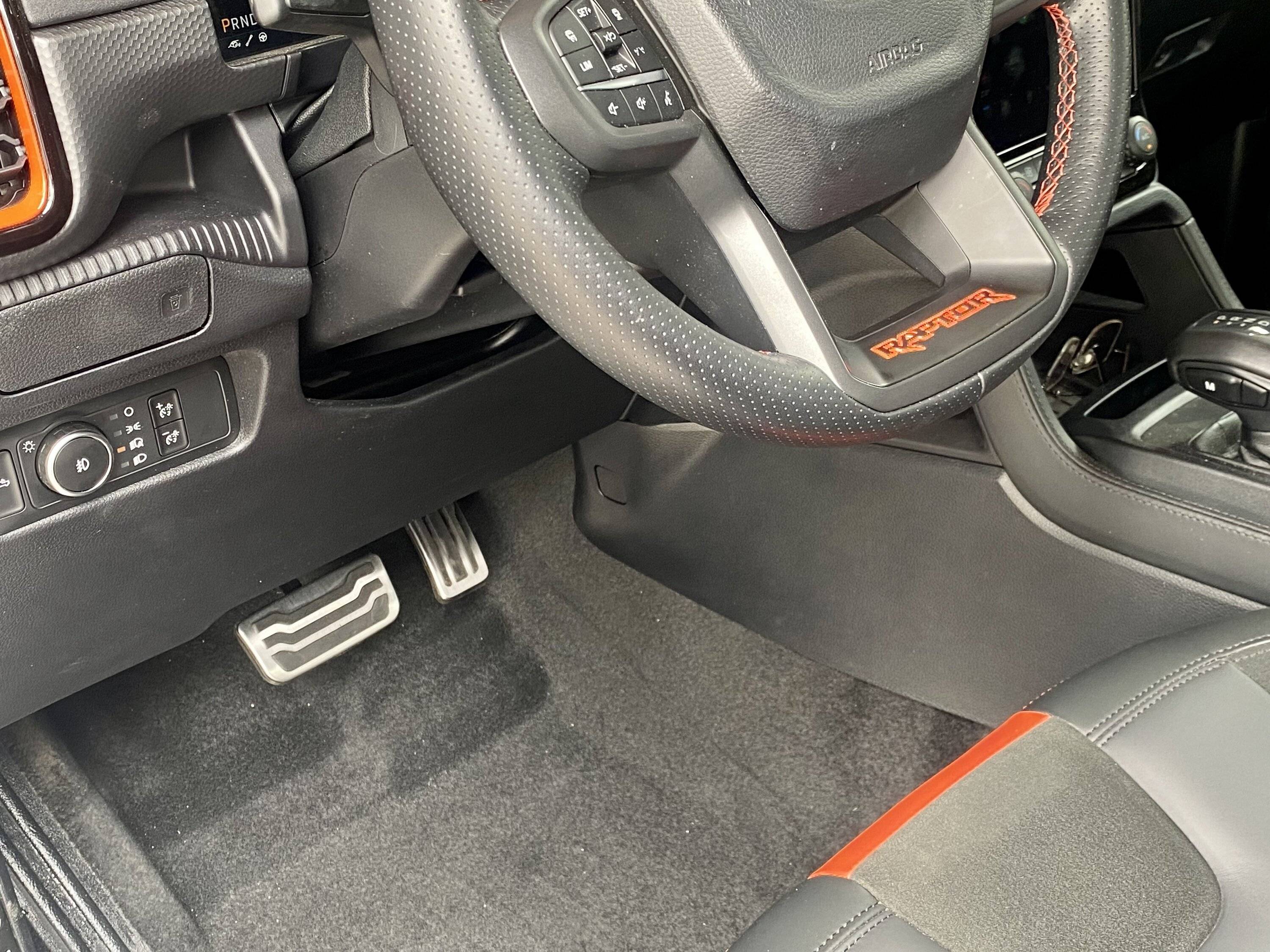

Something I didn't like about this Ranger Raptor, although not a big deal, was the absence of hood struts and aluminum-trimmed pedals, features that the 5G Ranger Raptor had. Thanks to @Joules for his thread on this kit from piratecampco; I ordered one for myself. It works great and is much easier to install than their installation video suggests. Additionally, I bought some aluminum pedals from eBay for the Ranger 5G—great quality for the price, and they fit perfectly.

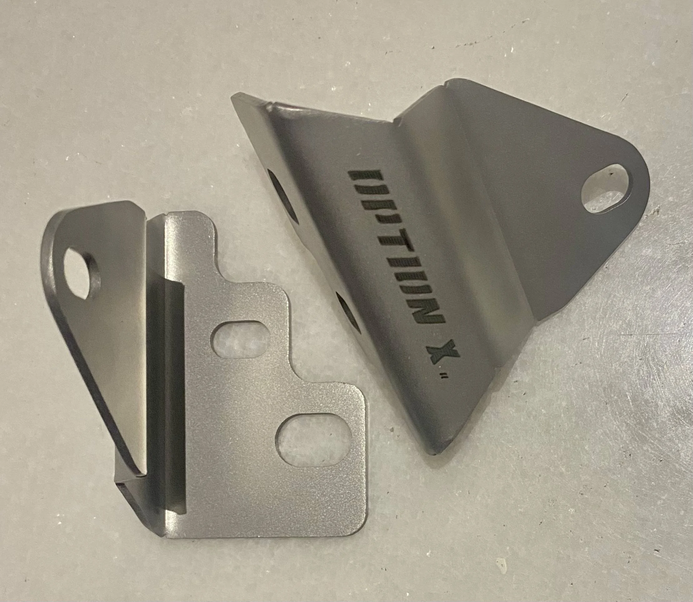

Installed a 30” LED bar behind the grille using OptionX brackets—easy setup with the original bolt spots. Usually, I opt for Baja Designs LEDS, but this time I chose a budget-friendly Hella Black Magic. It's surprisingly bright, with a beam throw distance comparable to the pricier option. The slim all black design keeps it low-key behind the grille.
Nice setup…
Would you share the link for the option x brackets ?
thank you!
This is the hella black magic 30” slim or doble row ?
Would you share the Part number?
thank you!
thank you!
I got the slim 32" P/N 358176311. I assume it’s possible to install a double-row bar, but it must not exceed 55mm in depth; otherwise, you’d have to do some trimming.
