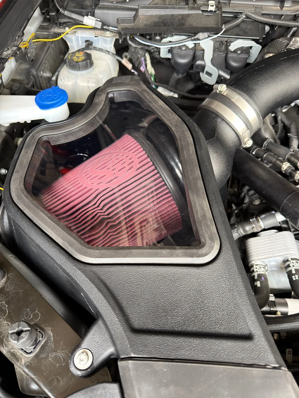

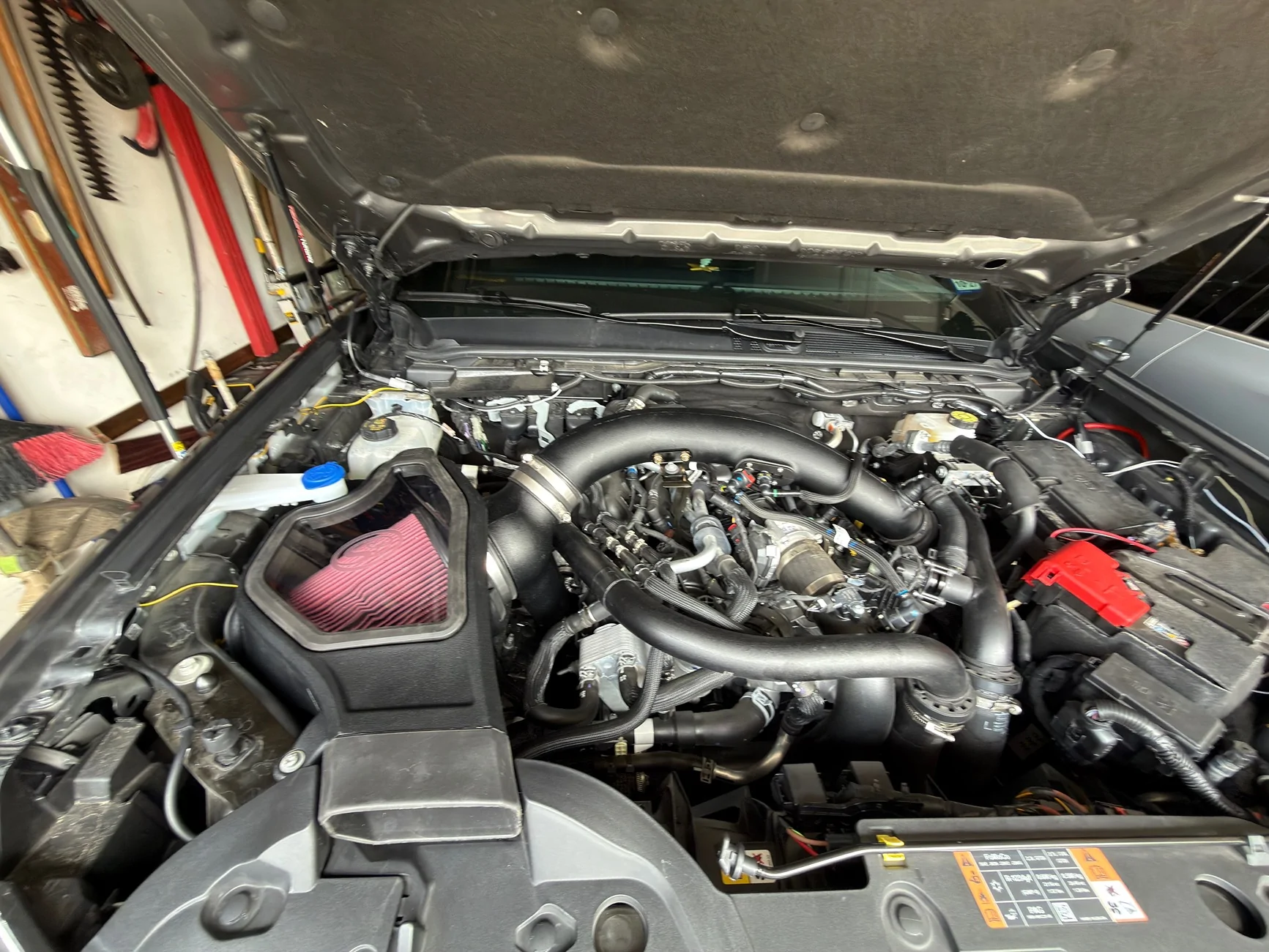

no codes on my install works great
Ford Ranger Will installing a CAI trigger engine codes in 2025 Ranger Raptor? IMG_2657
Ford Ranger Will installing a CAI trigger engine codes in 2025 Ranger Raptor? IMG_2656
