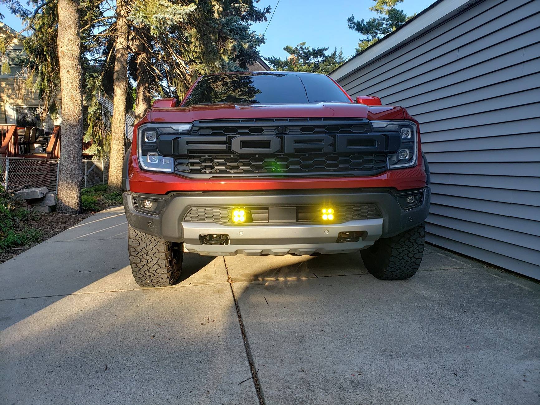

Took a set of Squadron Pro Amber combo pot lights off my super duty added them to my Ranger Raptor this afternoon. Got the idea off another form member so got to give him props on that he did it first just don't remember who it was.

I don't believe so it was just a blank open area I'll find out tomorrow when I drive it.

I just pulled the plastic push pin and ran the supplied bolt and nut thru. On the passenger side I cut the small plate with an angle grinder for better access.

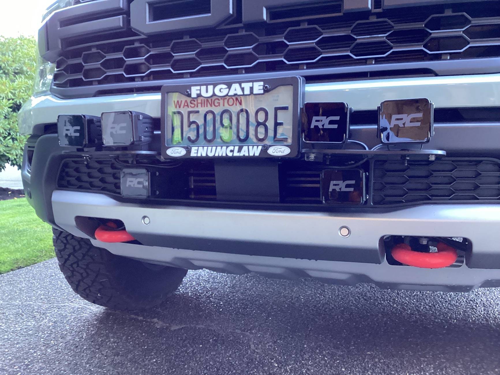

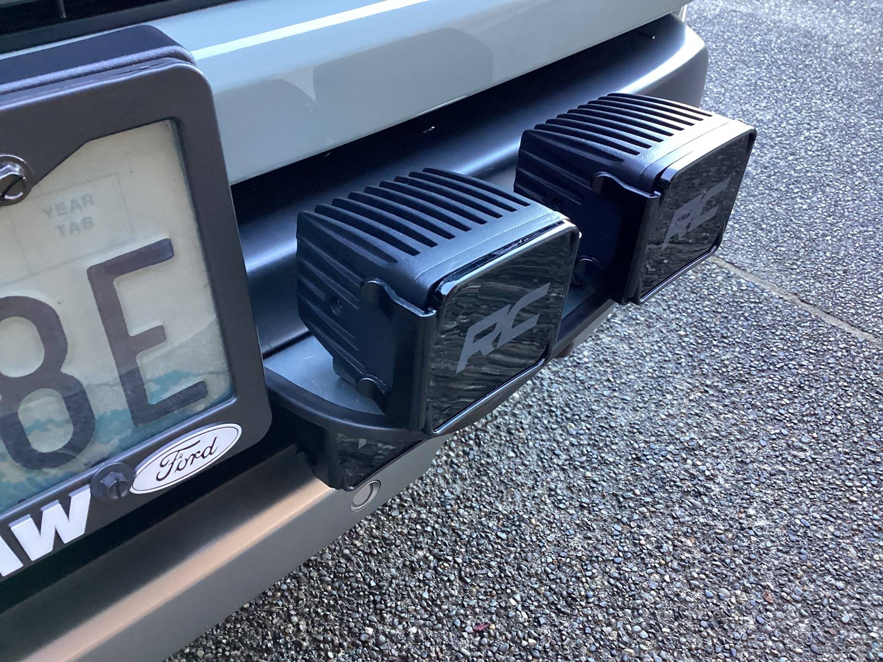

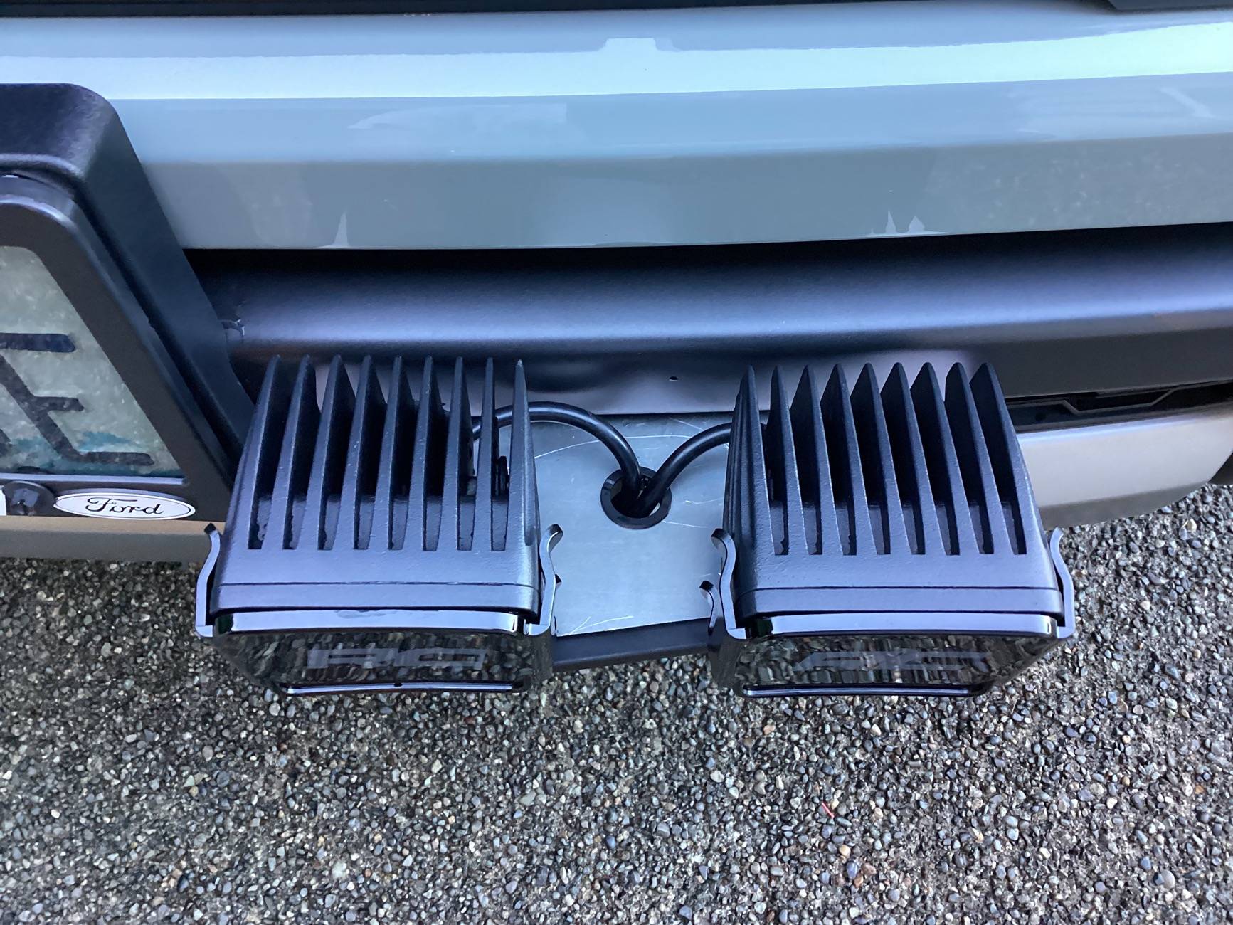

We made them, mounted with rivnut sin the bumper.

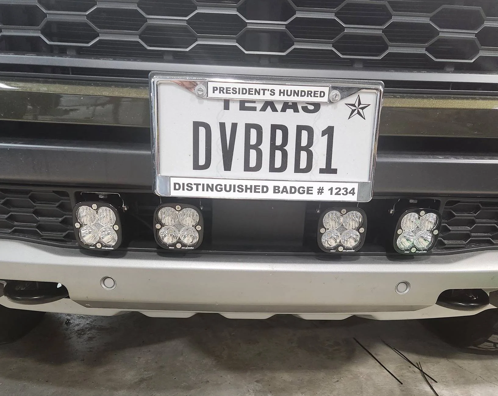

Mine with 4 does not affect either as the former had been through unintended testing. I believe the center part is the one not to be blocked. In cruise control, the car slows down from set point when a slower car is in front, and accelerates back once a lane change is executed.
