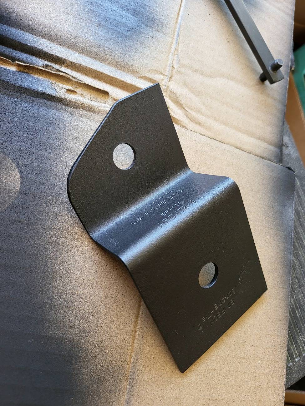

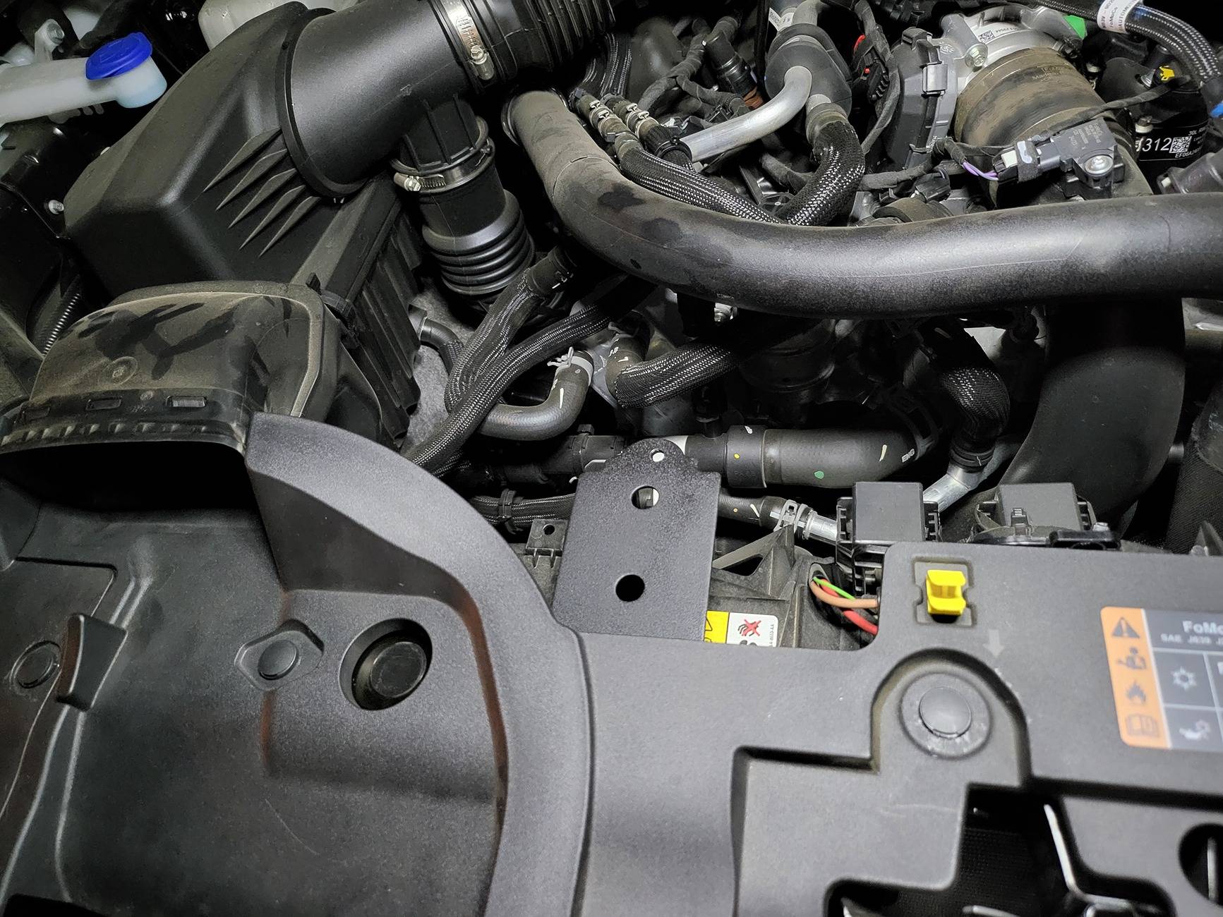

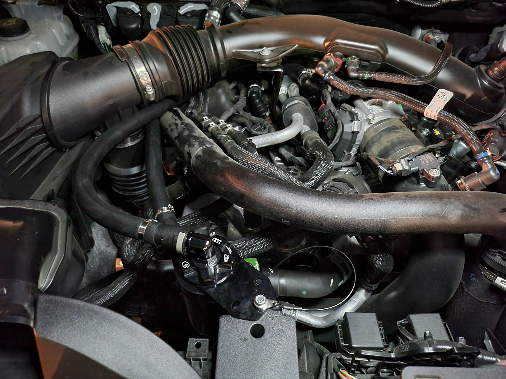

I purchased an Explorer ST catch can from Improved Racing as it has the same motor as our Ranger Raptor.
I fabricated an extension bracket and mounted it to the radiator support. No permanent modifications/drilling to the truck. Here are some pics. Enjoy!
Ford Ranger Ranger Raptor Catch Can Installed! 1000416889
Ford Ranger Ranger Raptor Catch Can Installed! 1000416890
Ford Ranger Ranger Raptor Catch Can Installed! 1000416891
Edit:

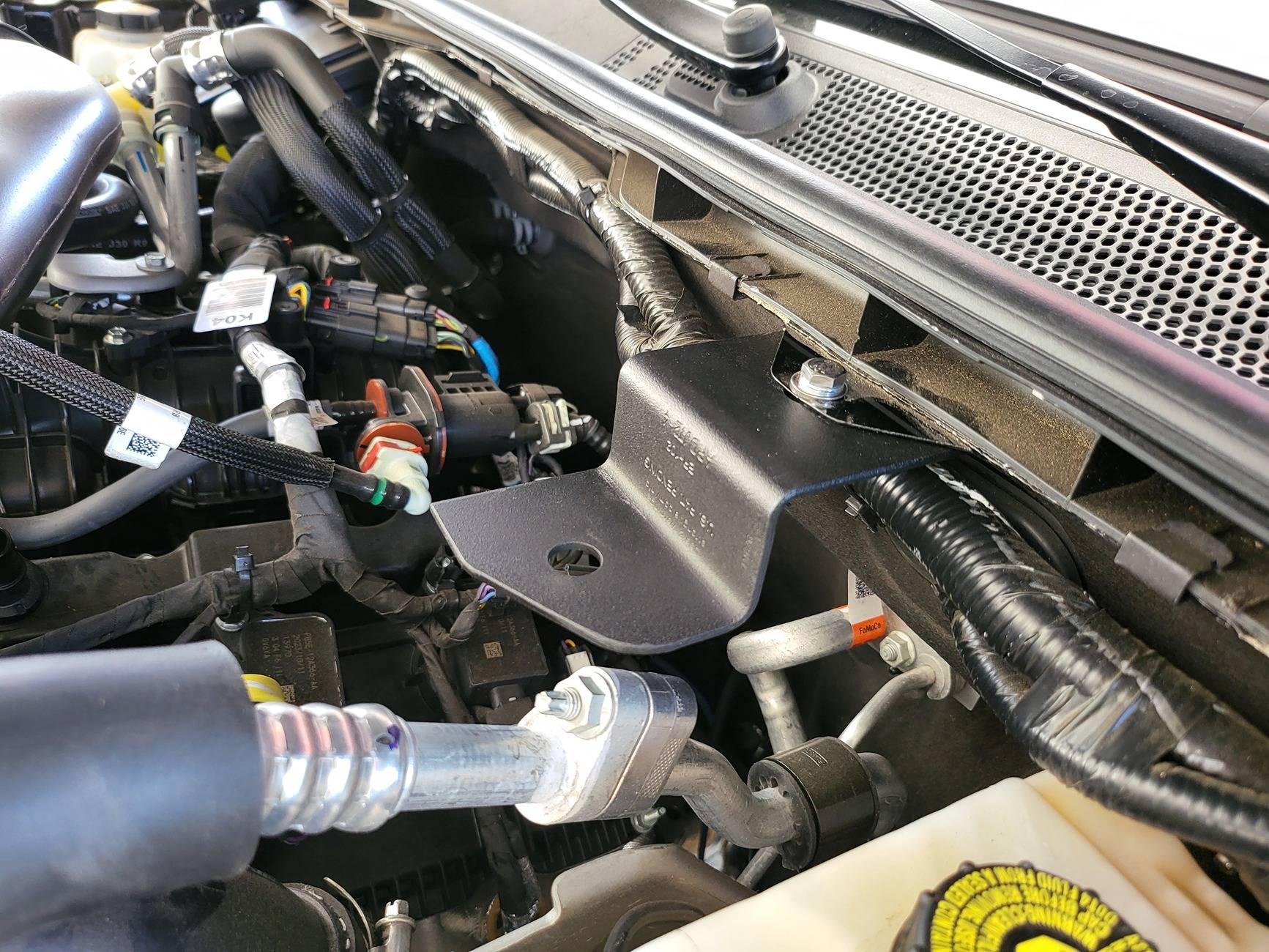

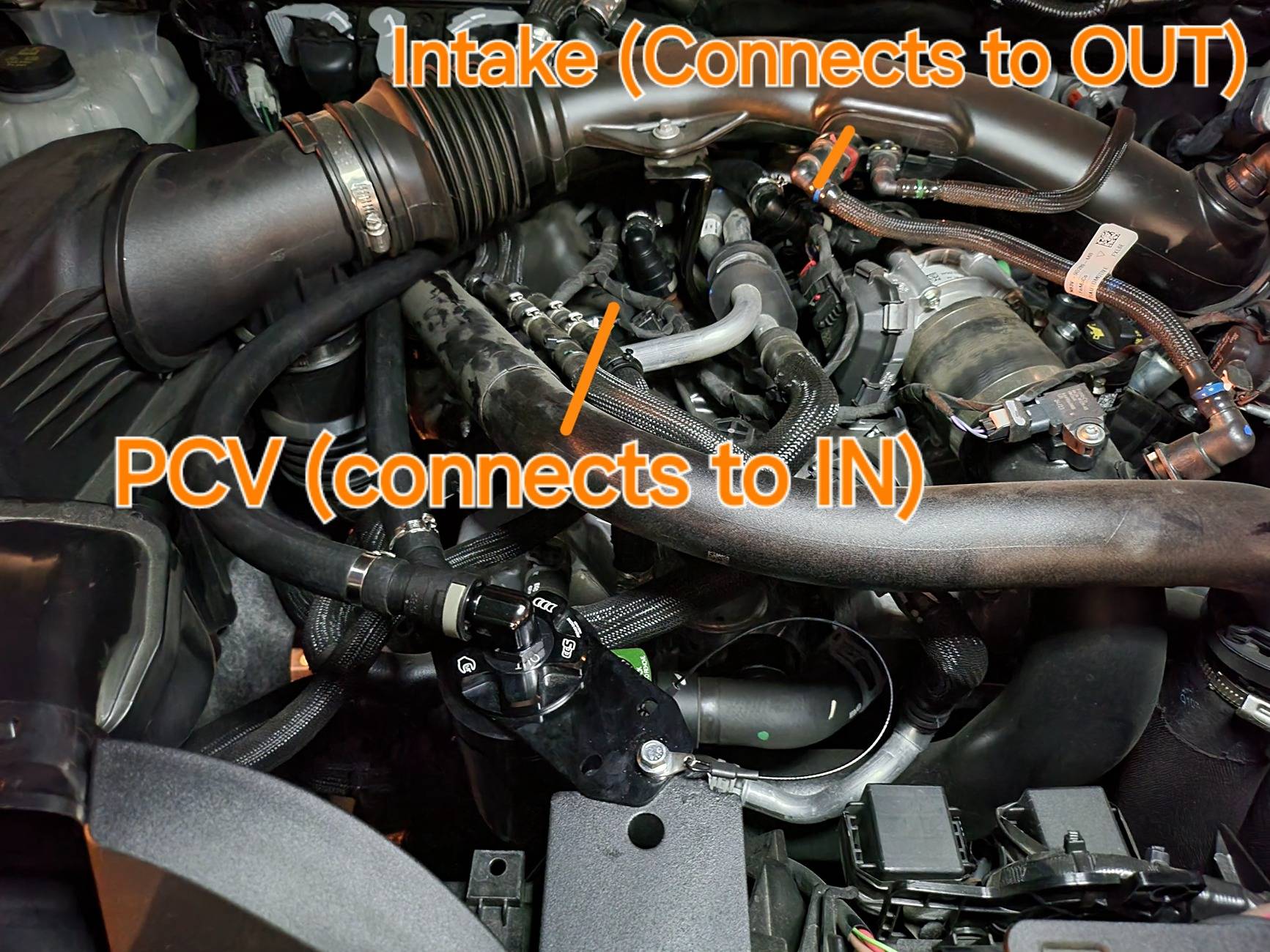

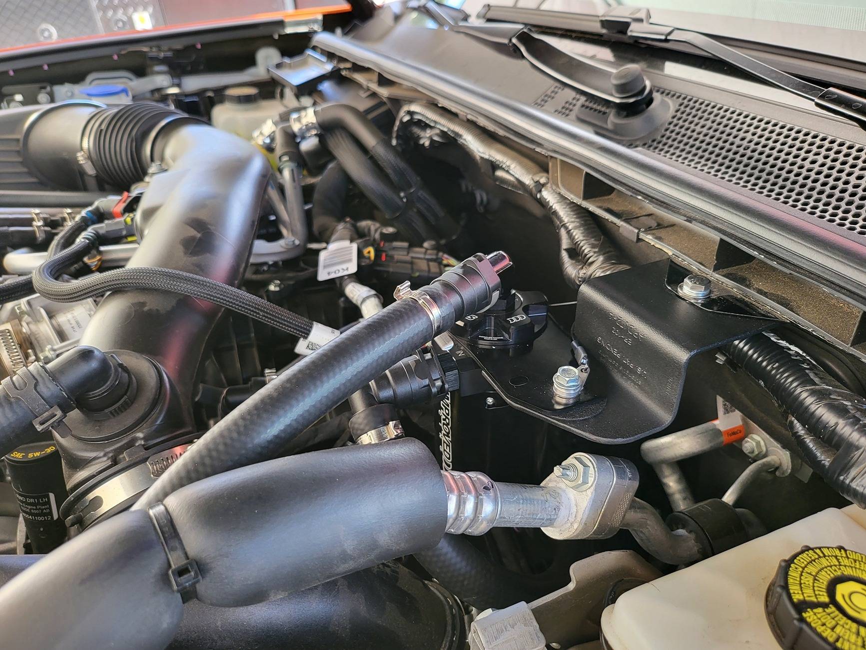

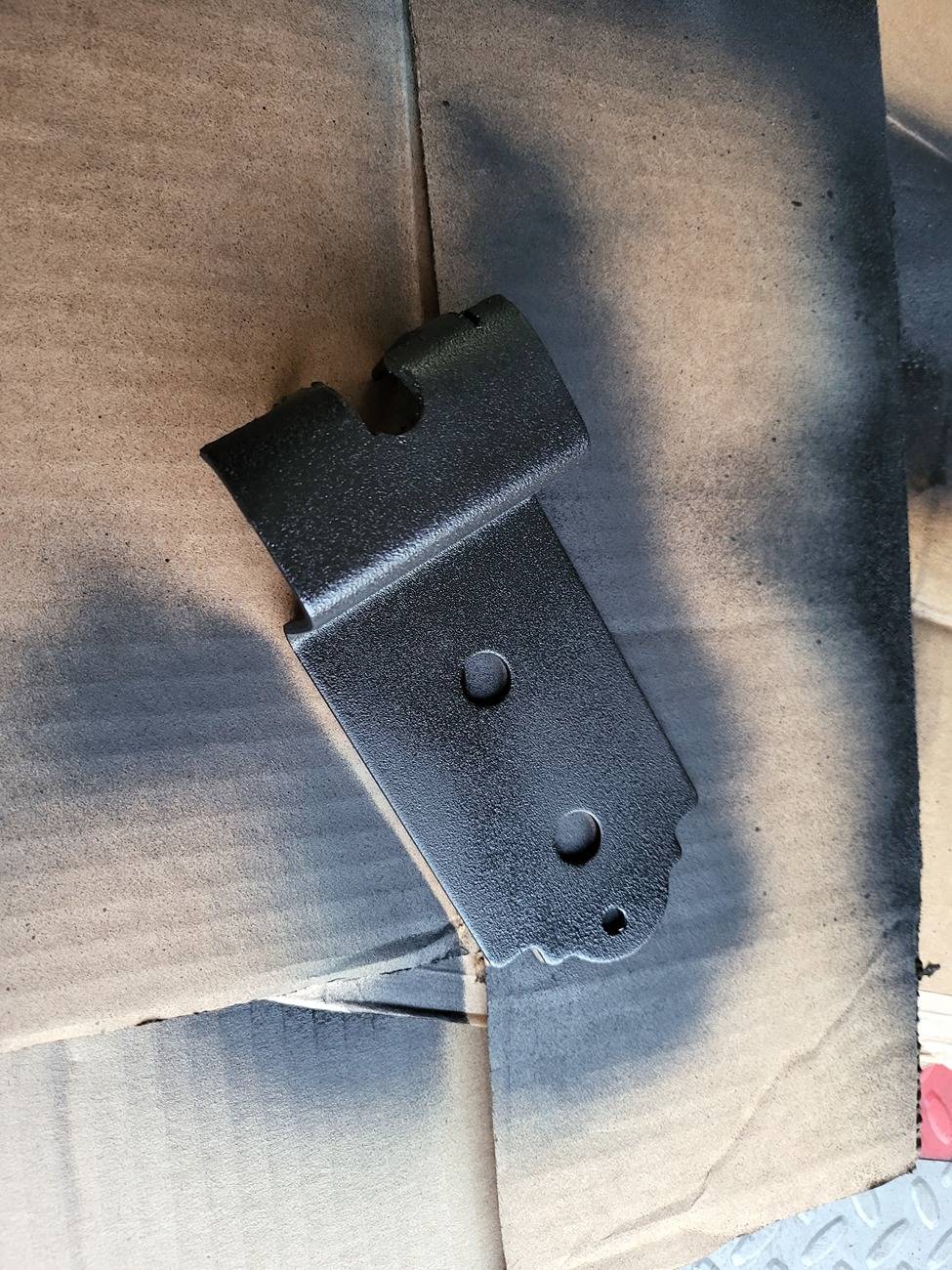

Passenger side catch can for the charge pipes added!
Ford Ranger Ranger Raptor Catch Can Installed! 20240804_140334
Ford Ranger Ranger Raptor Catch Can Installed! 20240804_180031
Ford Ranger Ranger Raptor Catch Can Installed! 20240804_182138

Nice! Easy access too. Good work! I've been tempted to do the same with an existing catch can.

Nice! Can you show where you connected the hoses to on the engine?

How’s the kit working for you so far?
Did the quick connects snap in perfectly onto the Raptor?
No leaks or anything to report?
I might be buying a kit if it’s working good for you

The hose clicked in perfectly on the factory fittings. I'll check to see if I've collected anything later today. Been super busy recently. I'll also try to install the turbo side catch can next week. I gotta make a bracket for that as well. Already decided on a location for it.

Nice work. How are the hose lengths for the locations you chose to mount the cans? Did you make the bracket for the Turbo inlet can?

Hose lengths were just fine. No issues. I made the bracket that connects to the firewall. Not sure if I'll need to reinforce that for offroad use.
