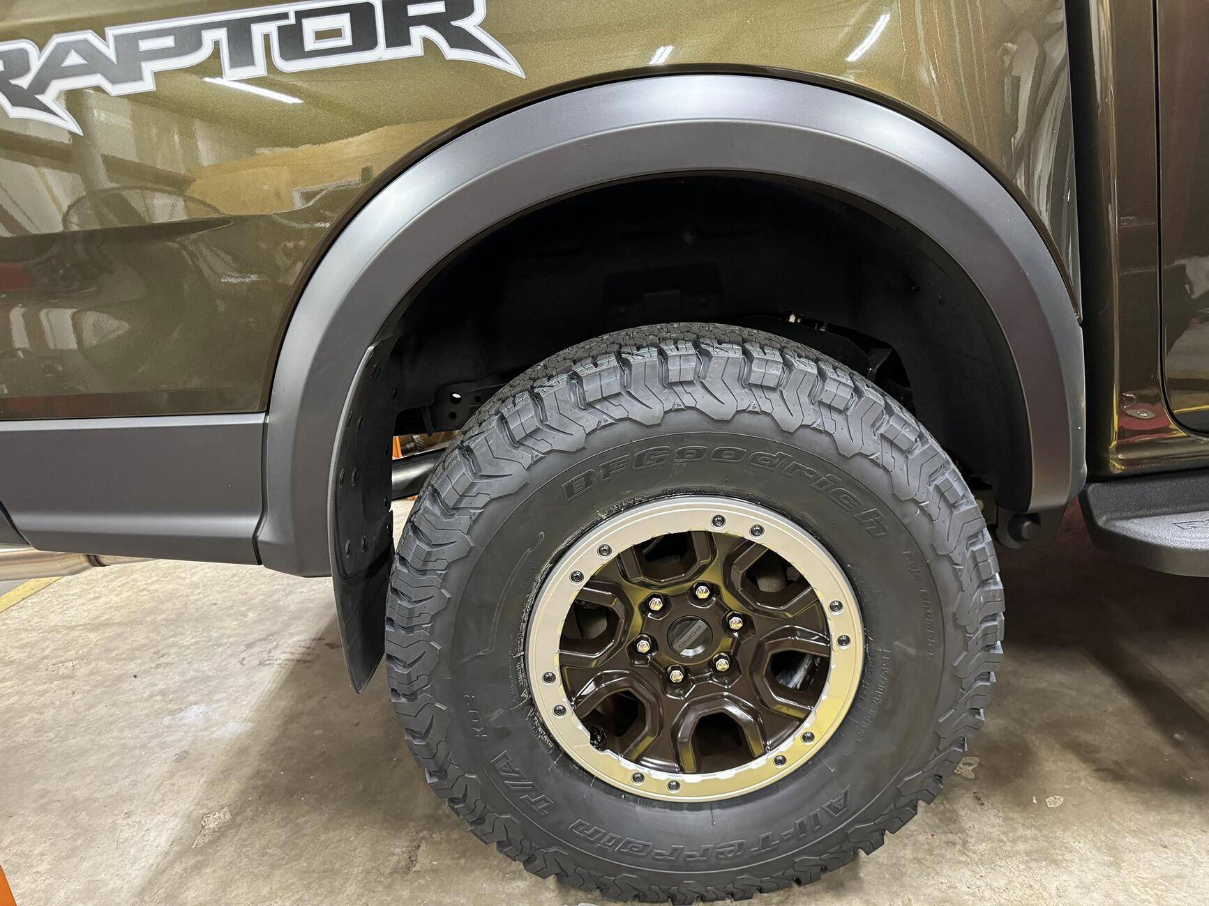

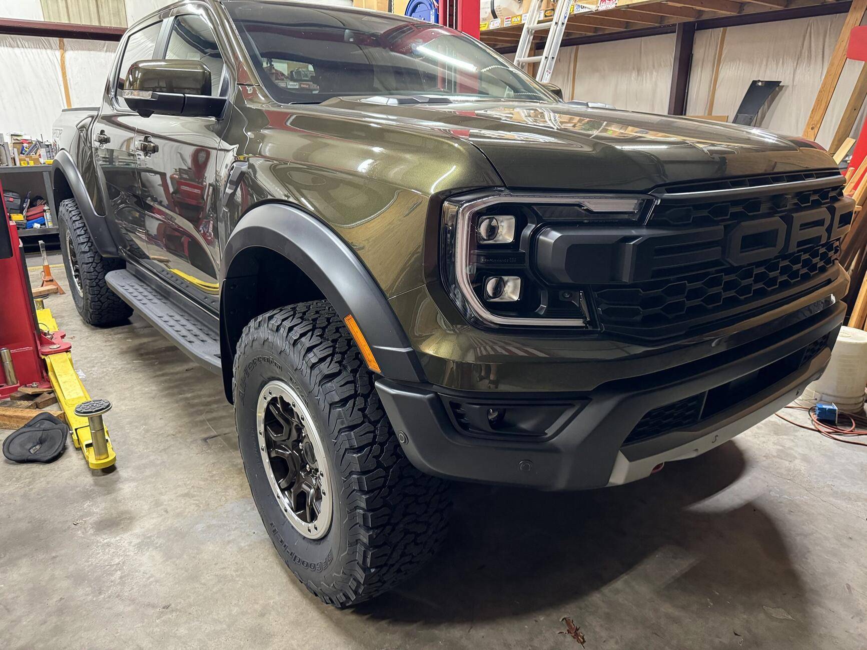

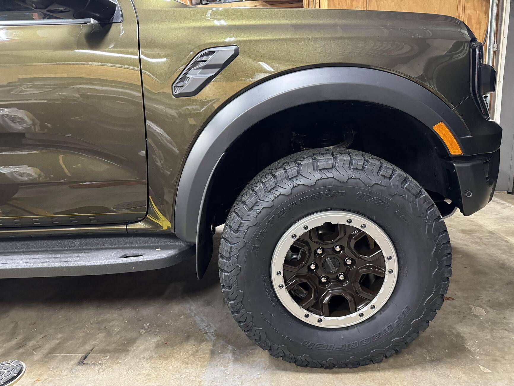

Installed the Rough Country 2" leveling kit along with Bronco Sasquatch wheels and KO2 315/70/17 tires:
Ford Ranger Leveled Ranger Raptor on Bronco Sasquatch Wheels/Tires 1723562280453-zh
Ford Ranger Leveled Ranger Raptor on Bronco Sasquatch Wheels/Tires 1723562342319-q
Ford Ranger Leveled Ranger Raptor on Bronco Sasquatch Wheels/Tires 1723562378950-3k
Ford Ranger Leveled Ranger Raptor on Bronco Sasquatch Wheels/Tires 1723562422440-j8
Removed the front crash bars, and so far have only seen minor rubbing on the passenger side rear crash bar. I suspect they will eventually need to come out because I haven't driven it much since installation.
I have not had the alignment checked professionally, but the camber seems to be straight up 0 degrees according to my angle finder, and my fancy string toe alignment setup showed an initial toe-in of .6 degrees. I set that to .17 and will see how it goes.

Looks good. A little surprised on the rear tire poke.

you know what the offset is on the wheels?
It appears to have more poke from the front view since the fender flare tapers down from the top towards the front of the truck. When I get around to posting some pictures from the back, you'll see the poke is very minimal from the rear of of the truck.

Bronco SAS wheels are +30 offset. Ranger Raptor wheels are +55.
Do you know the offset for the FX4? It would let me no the minimum offset required for every tire width.
