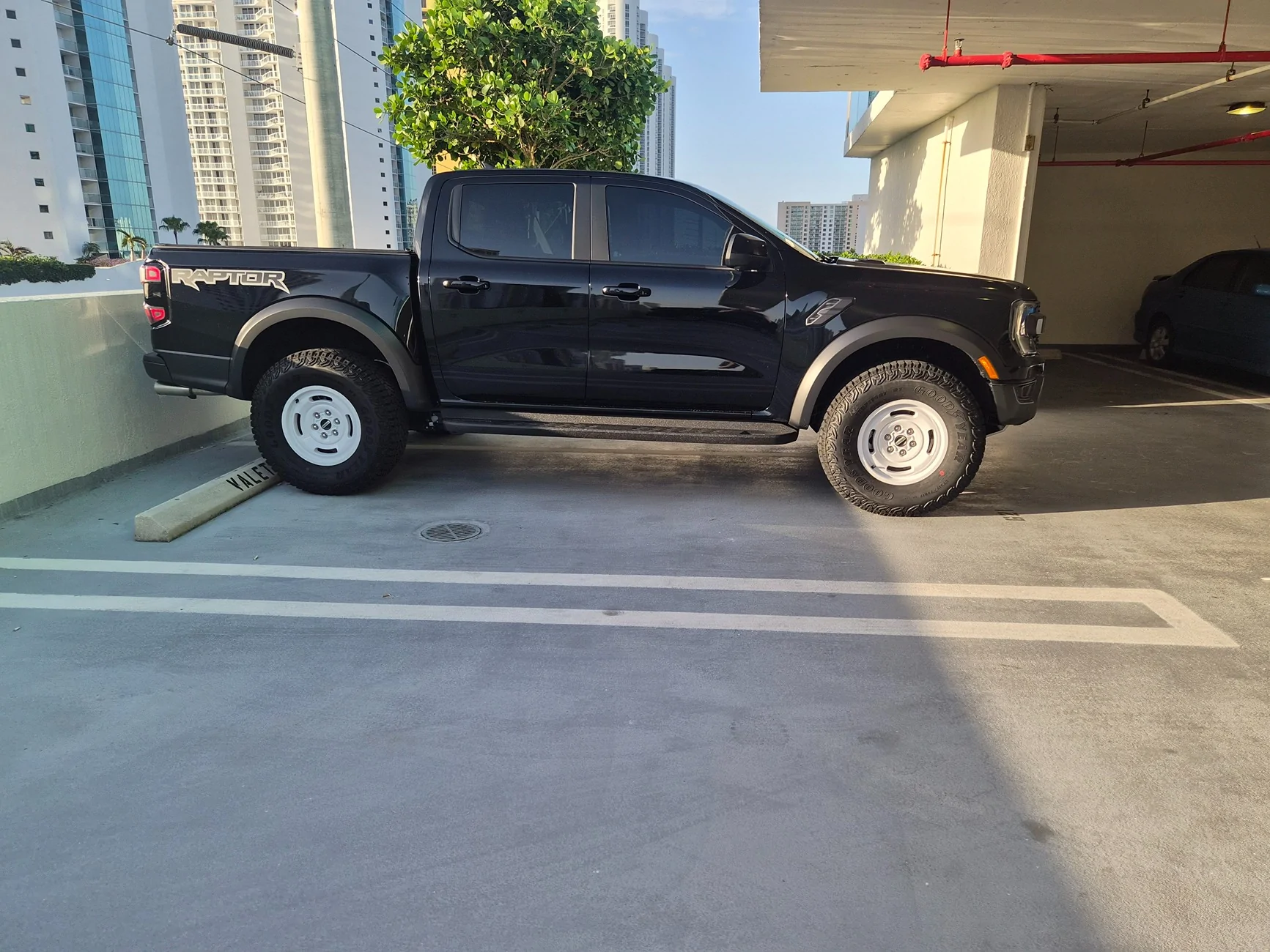

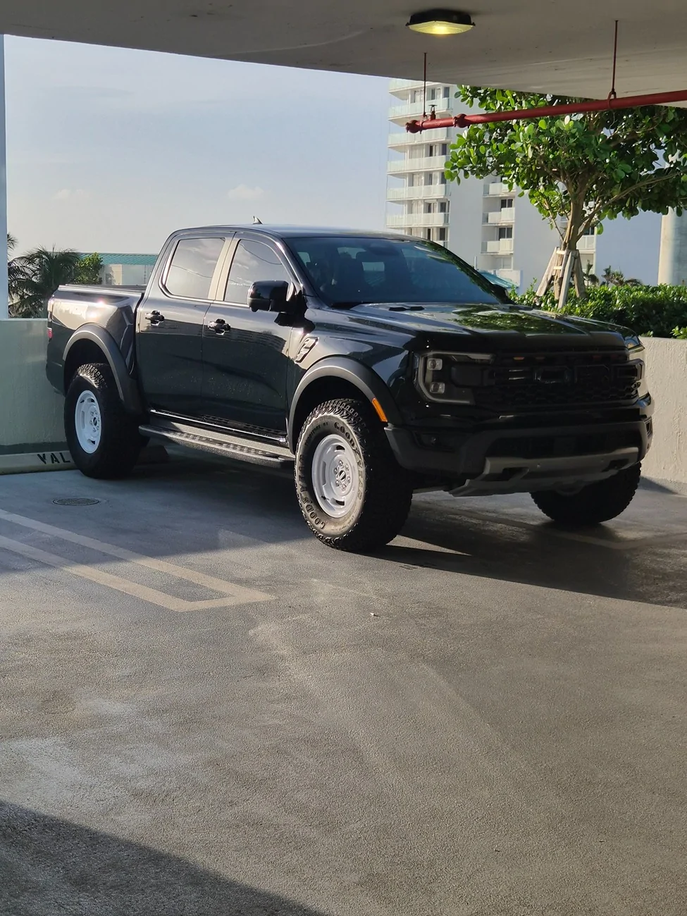

Hi Everyone,
New to the forums although i have been around reading all the great information on here for sometime.
Thought it was time i share something! (not too usefull)
After sometime debating on tire size etc. i decided to buy some take offs from a Bronco Sasquatch in new condition with 315/70/17 tires.
I was iffy about the wheel style and color, but overall i kinda like it.
I installed them and as expected, the real issue are the crash bars. No other serious rubbing or clearance issue that i see that will affect drivability.
Will be tackling the crash-bar removal and install this afternoon and off to re-balance and align the truck on Saturday.
Im not an expert at any of this but here is the info incase it helps anyone.
Bronco Sasquatch 17in +30 offset
GoodYear Territory RT 315/70
(Same bolt pattern and hub size as our RR)
Although i did order a minor lift (spacer kit) i think i may not install and just doing the crashbar work and slight fender modding if needed. I like the way it sits and not need mess with the Fox stock suspension any further.
Not the best pictures but hell, you guys get it =)
Cheers all !

Clean!

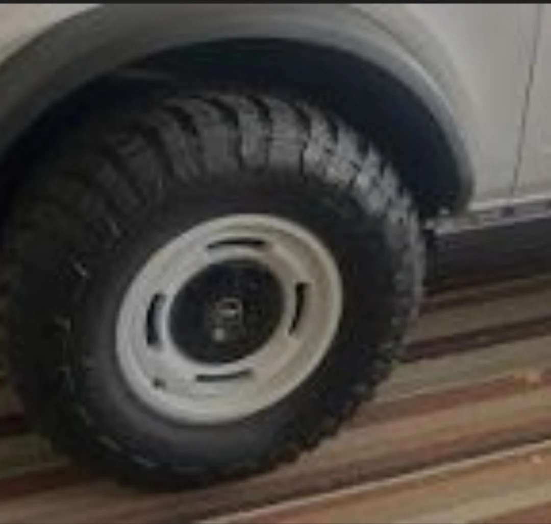

I absolutely love it! I thought about those. Wheels for my Ranger, ended up going with Nomad Field 504’s with a similar, minimalist look.
Looks great!
I ordered the black hubcaps from ford. think it will make the look come together as my truck is black.

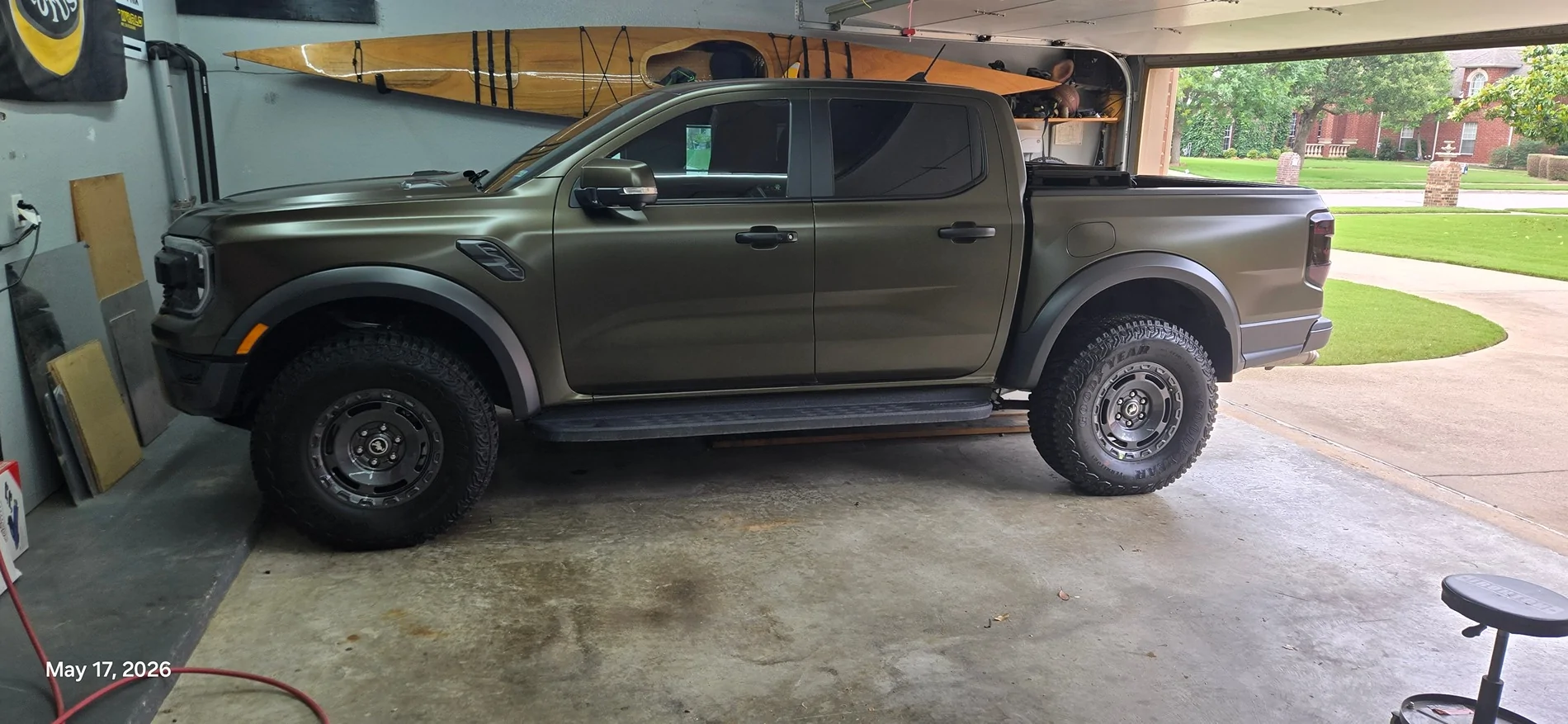

If you plan on jumping it, you'll find that the fronts will touch the top of the wheel well. Other than that, I haven't had any rubbing on mine after removing the crash bars.

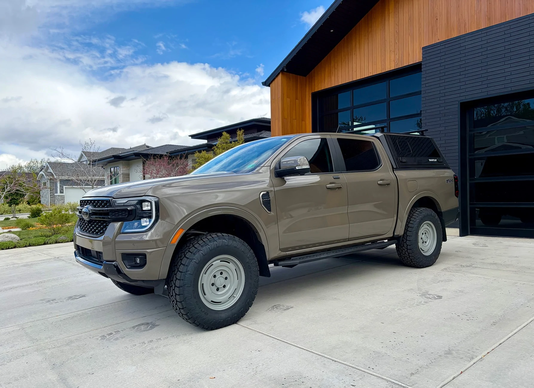

Looks good! I considered some of those Heritage wheels, but liked the look of the Everglades wheels just a little better for my truck.
I installed the high clearance crash bars and am having no issues. I have not been on any trails yet that need a lot of flex, so may end up with a small lift.
