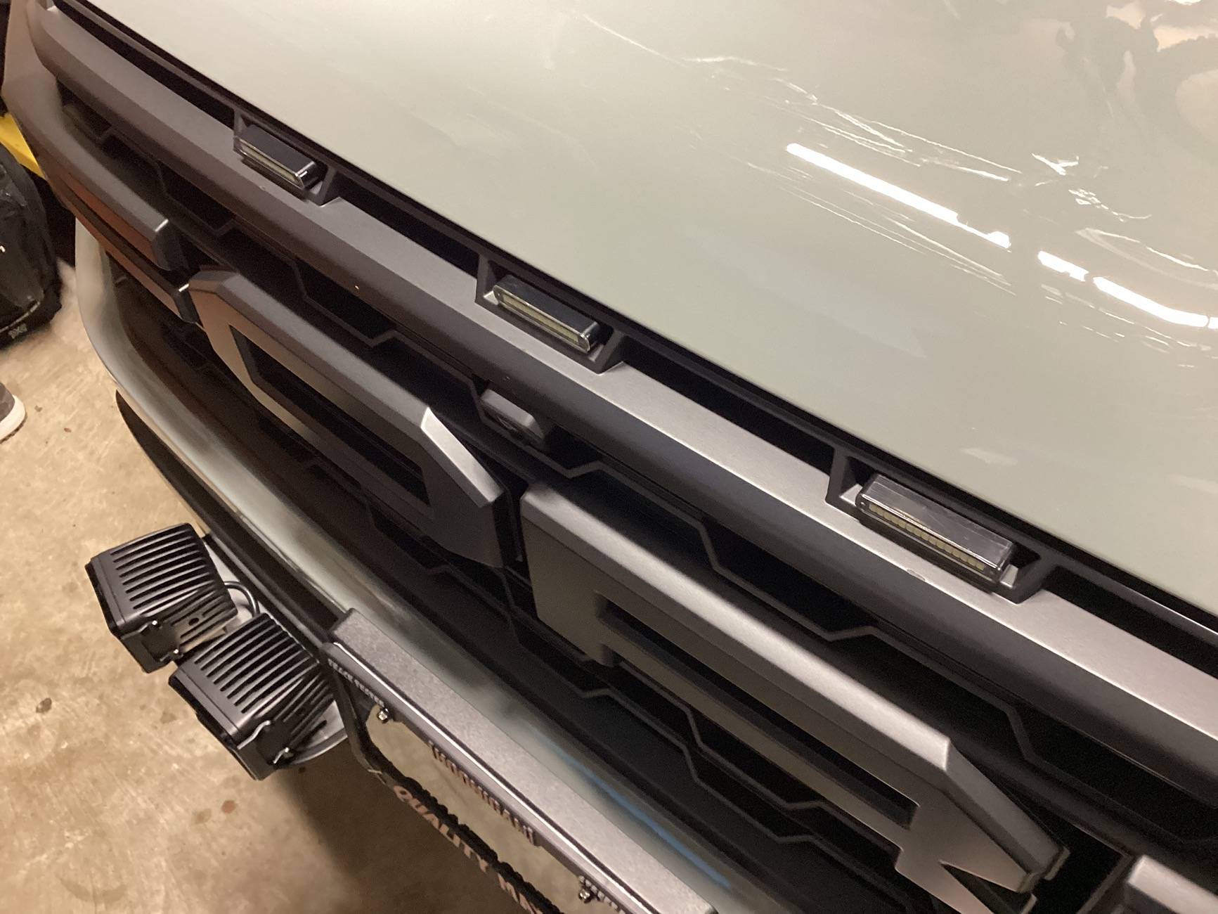

Installed an older set of F150LEDs (@F150LEDsMatt) grill lights that I had from a Lariat I had a couple of trucks back. One had gone bad, I contacted the company to purchase a replacement and boom, three days later a free replacement showed up in the mail, Free, who does that over a year later! Looked into what they offer now and they have a lot of items for Rangers I have. The new generation of grill lights and the heads up display coming, check them out!

That is excellent service. Too many companies underestimate how effective a post such as this is from a marketing perspective. It can really enhance your brand!
They look good, is it the picture or are they actually white lights?

i recommend not doing it to your truck then? ?‍♂
Im not talking about adding those lights in general. I very much want to add “raptor” lights to my Ranger Raptor.
im saying that the fitment and finish of this particular brand’s lights looks horrible.

I’m not sure this will look right on the Raptor

I bought those same ones but didn't install them, they stick out too much. Got a set from eBay, perfect fit inside the slots, but they're not bright enough.

They don't fit very good because they weren't made for a 2024 Ranger Raptor.
But they are a great company to deal with.

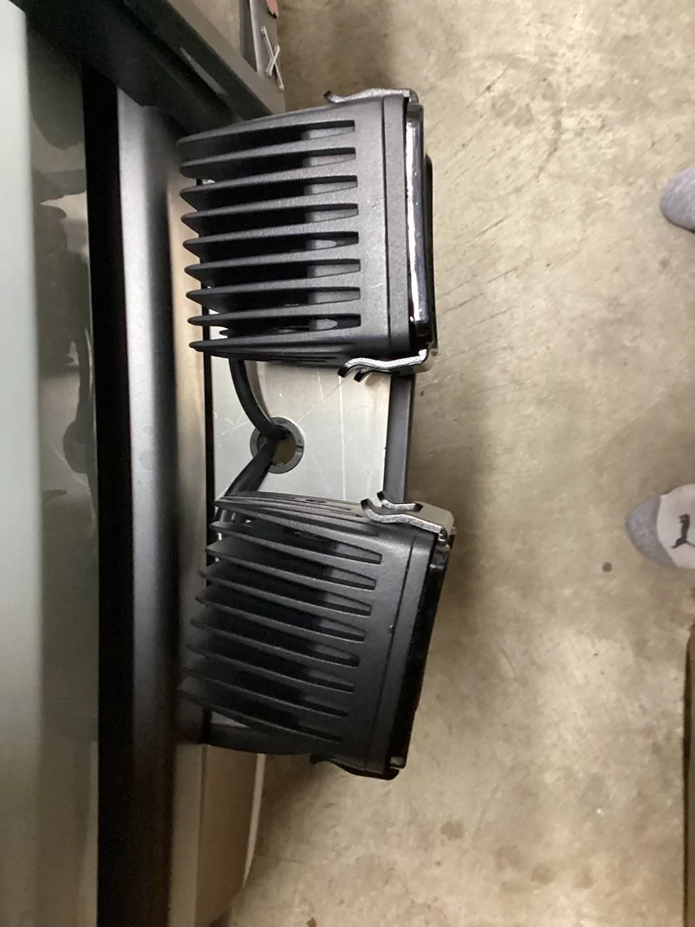

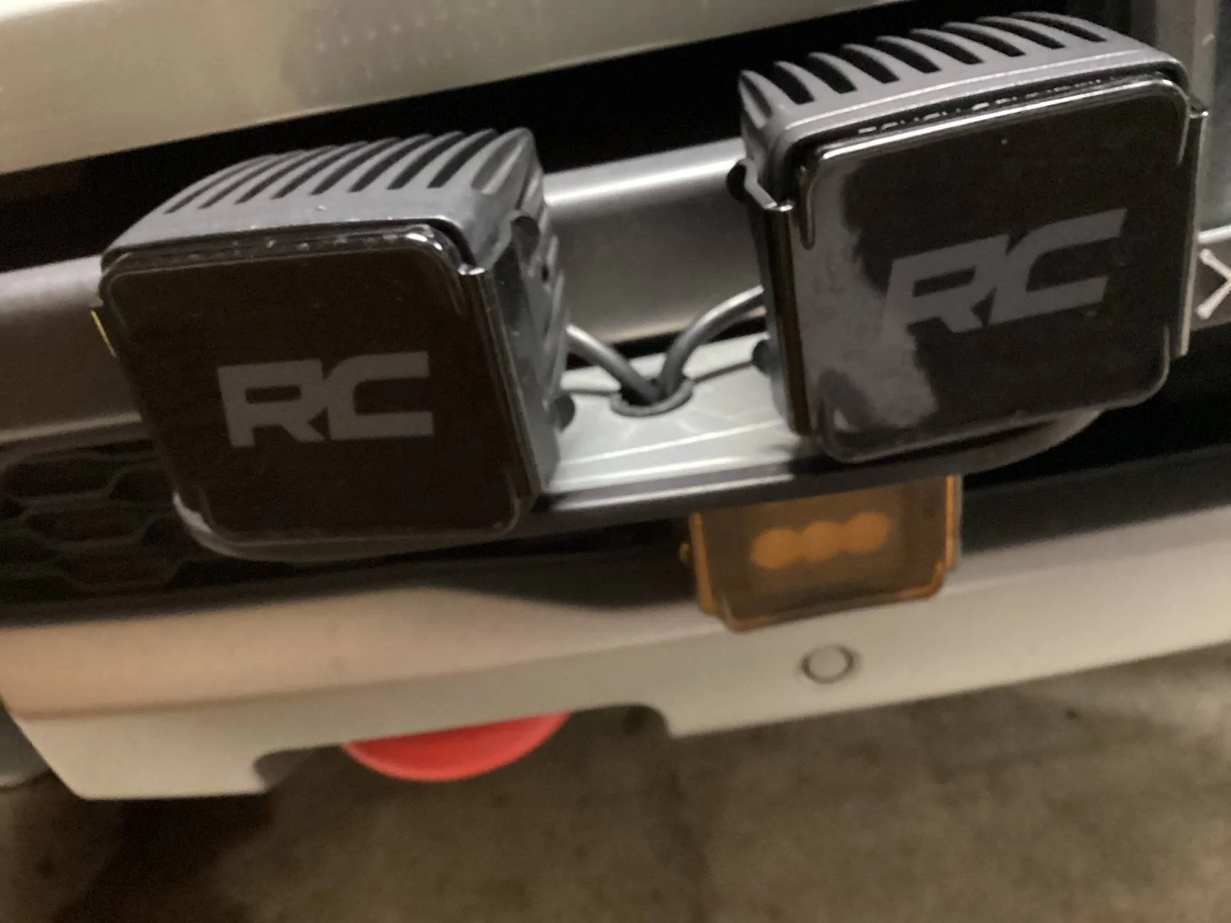

Can you link the front light bracket please?

I made them on the plasma machine 1/4” aluminum trimmed with black door rubber.

Sounds cool. Do you have a print so I can try to replicate? If not then I just want to know where you mounted the inside of the plate to.

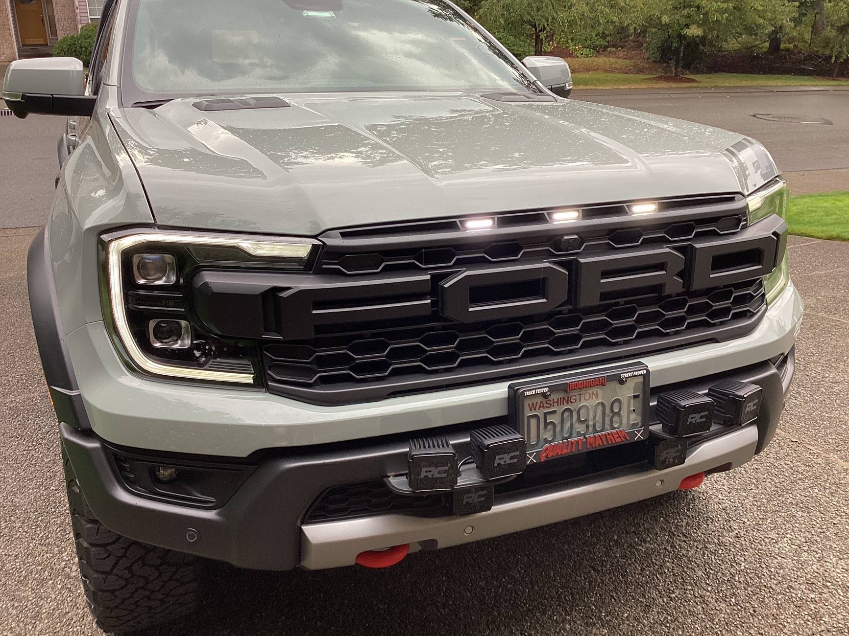

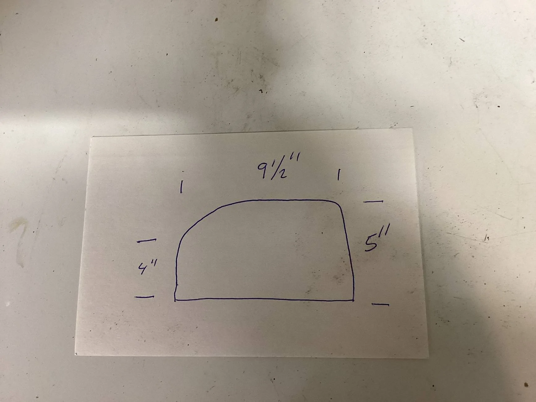

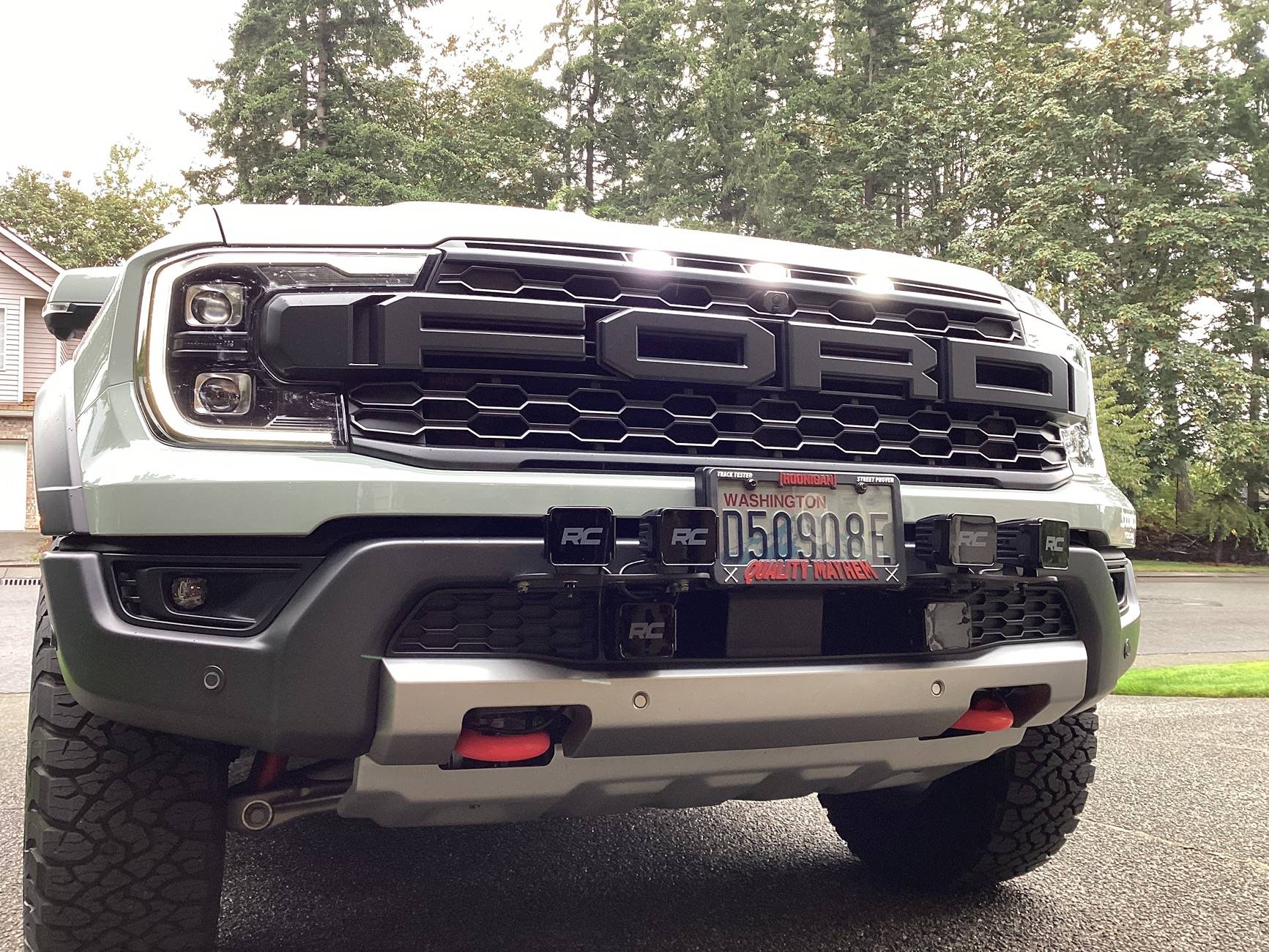

Quick sketch, I didn’t paint the aluminum, so hard to get it to stick and not flake off. In hindsight should have run them over to the powder coater. To mount them I used rivnuts and stainless hardware.
