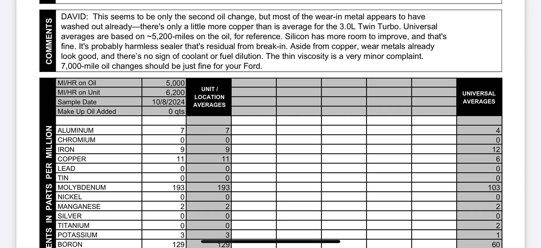

i used blackstone for my first oil change as well... thanks for posting this! i will be doing my 15K mile oil change here in the next month or two and i'll be getting my oil sent off for analysis so i'll post results. glad to see that most of the break in copper and silicone are out of the system on your truck already!

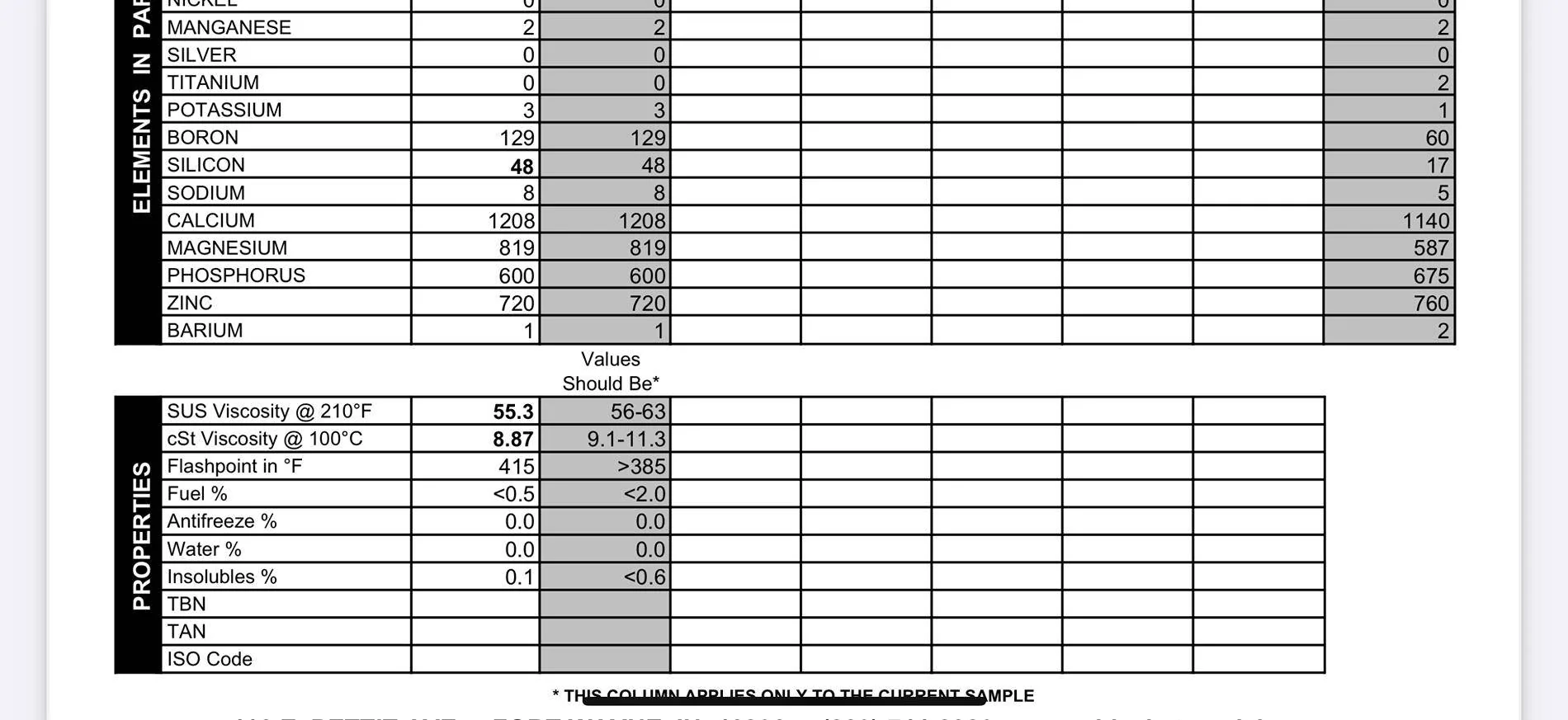

Just got back my results. Looks like I’ll be running 7k intervals
Thank you for sharing this with us. Did you get the TBN as well? It's nice to see how the engine is "breaking in", but I'm curious how well the oil is holding up too.
I recommend getting the TBN too if you're curious how well your oil is holding up; it's a measure of how much of the oil's additive package is left. It's a few dollars more ($10? I honestly don't recall) but I'd rather base my oil change intervals on a scientific analysis of my brand of choice after being used in my engine driven by me for whatever distance interval, rather than a universal recommendation or opinions expressed in forums.
