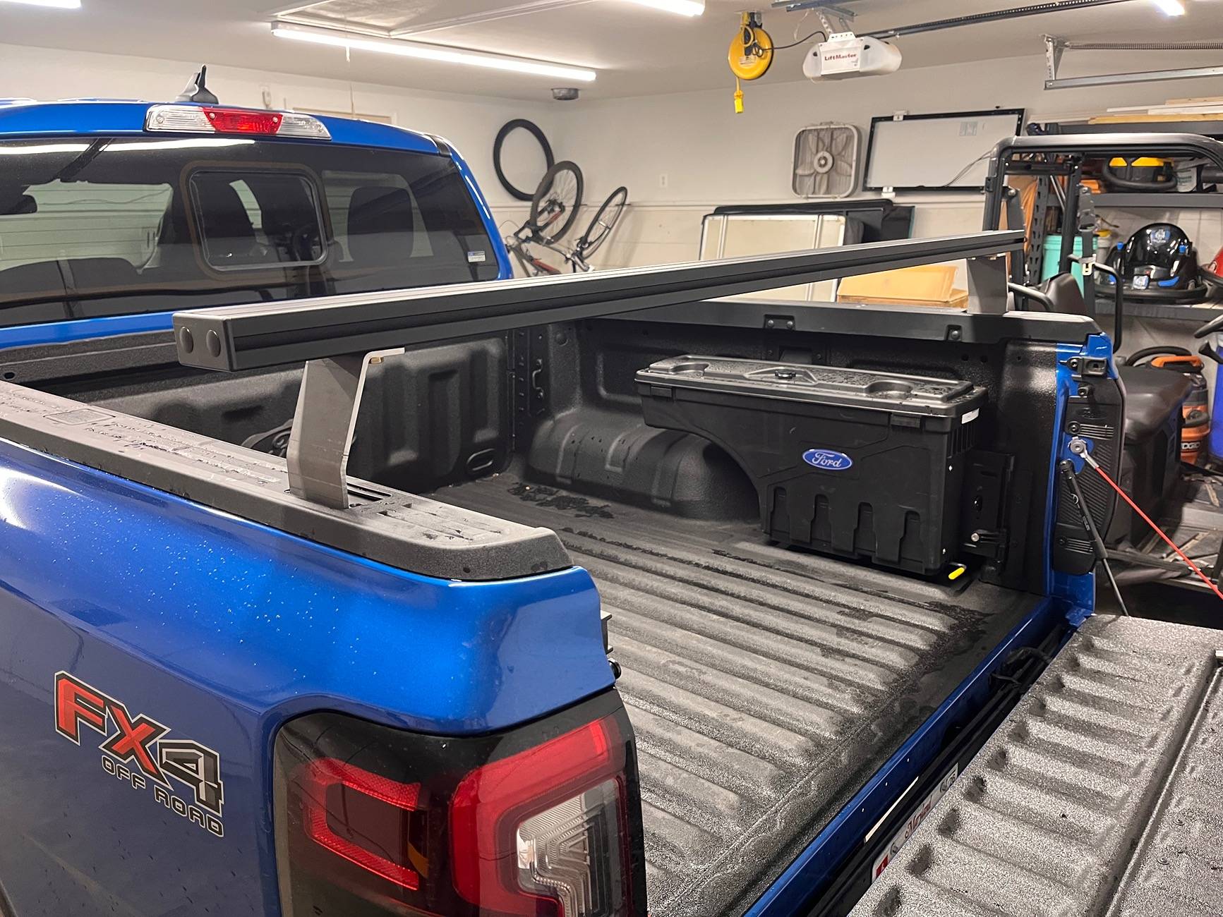

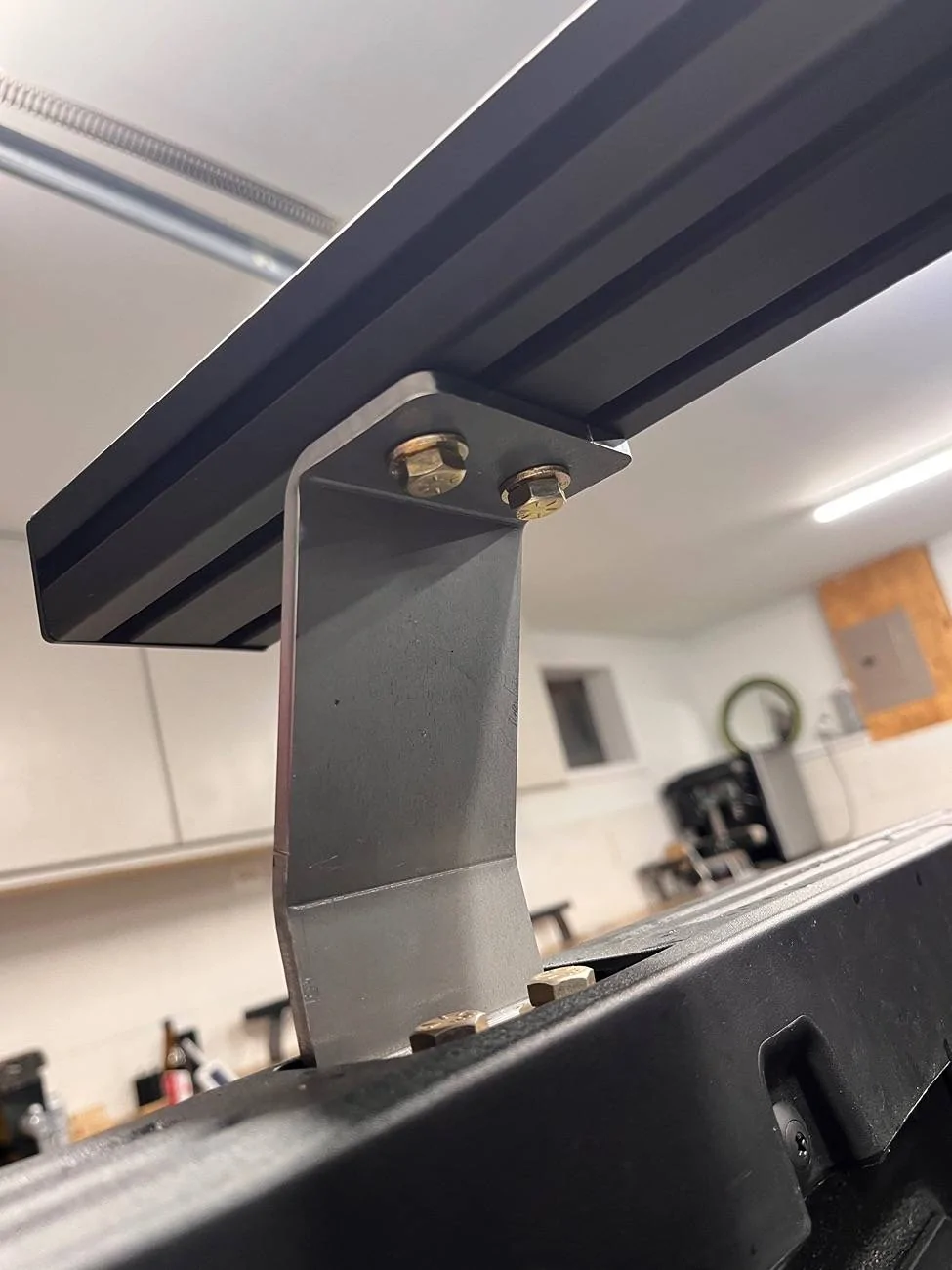

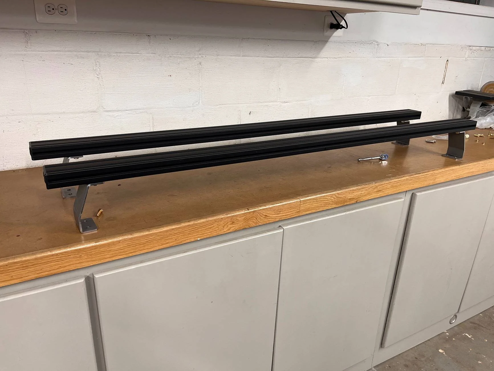

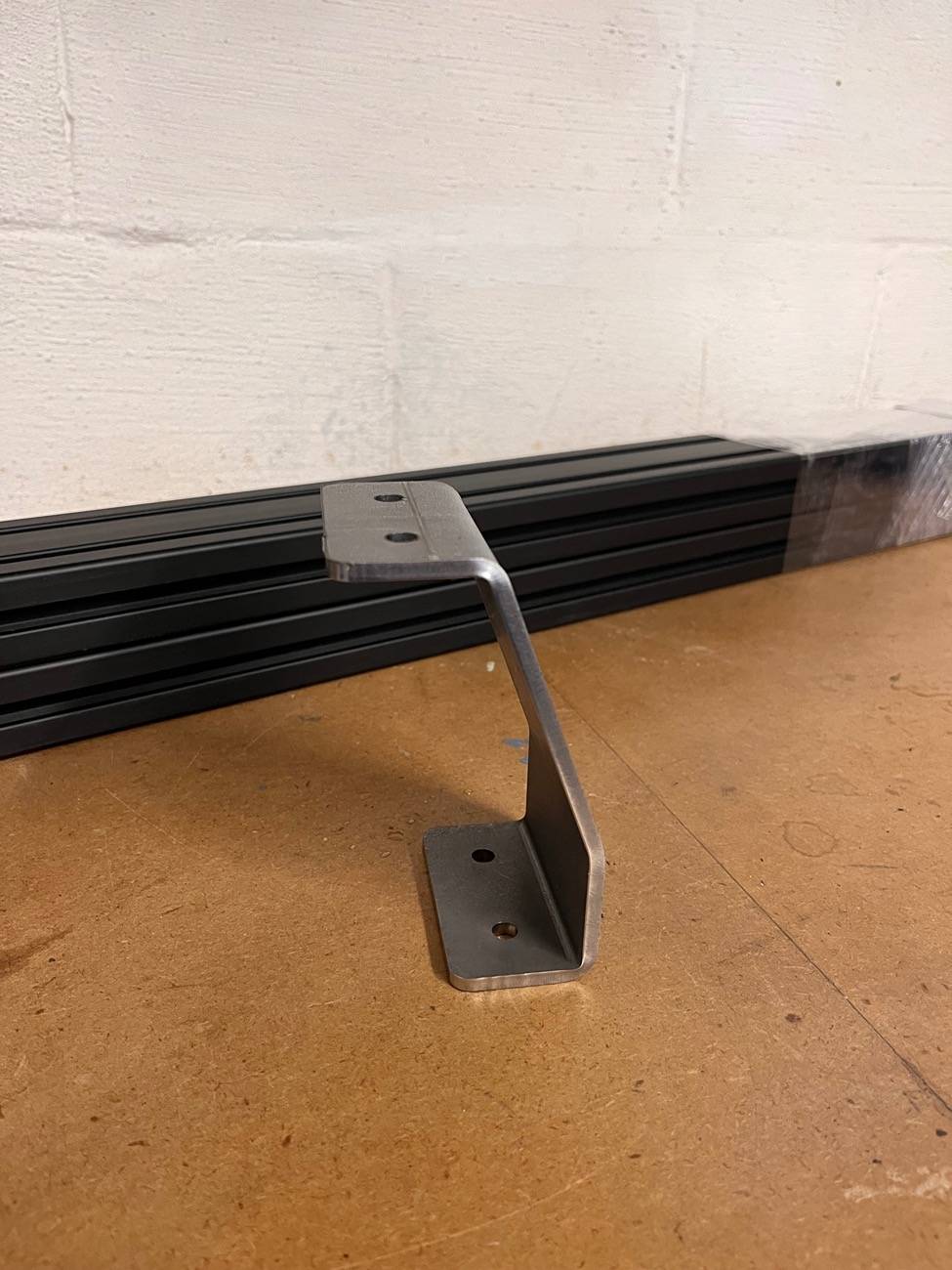

i’ve been looking for bed bars for a while, and none of them take into consideration that our beds are way different than the 5th gen’s.
billie bars is aware and working on some things, so that’s good!
In the mean time. i’m doing my own thing.
the uk rangers have bed bars that go in the stake pockets, so that’s the route i’m going. i’ve seen some other people on here are thinking the same things so that’s awesome.
here is the mock up of the towers- they are low, like 4” off the top of the bed. and have backer plates on top and bottom of the physical bed rail. crossbar is 1530 extrusion at 66”, so it sits just outside the bed cap molding.
here is the rendering-

if this works, i’ll probably design a taller version
Nice work.
But I'm curious - why won't the Billie Bars work? They show on their site that they fit the 6th Gen Ranger.
the molding on the beds float on top and inside, so nothing to clamp to of actual substance.
on top- a spacer is needed to actually carry the load, and unfortunately that means there are only 3 spots bed bars/racks, can mount. unless it’s something like what kbvoodoo has, which is like a peice of zbar that runs the length of the bed rail. i have some other ideas to play with for that. like a peice of 1515 running the bed rail cap.

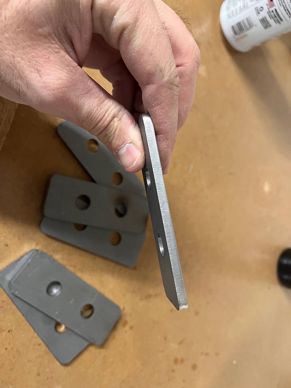

if these work they way i want, i might sell a few sets of towers. no crossbars, or hardware. just raw steel plates and towers.

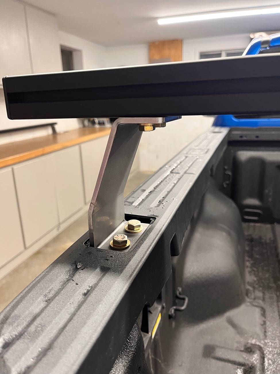

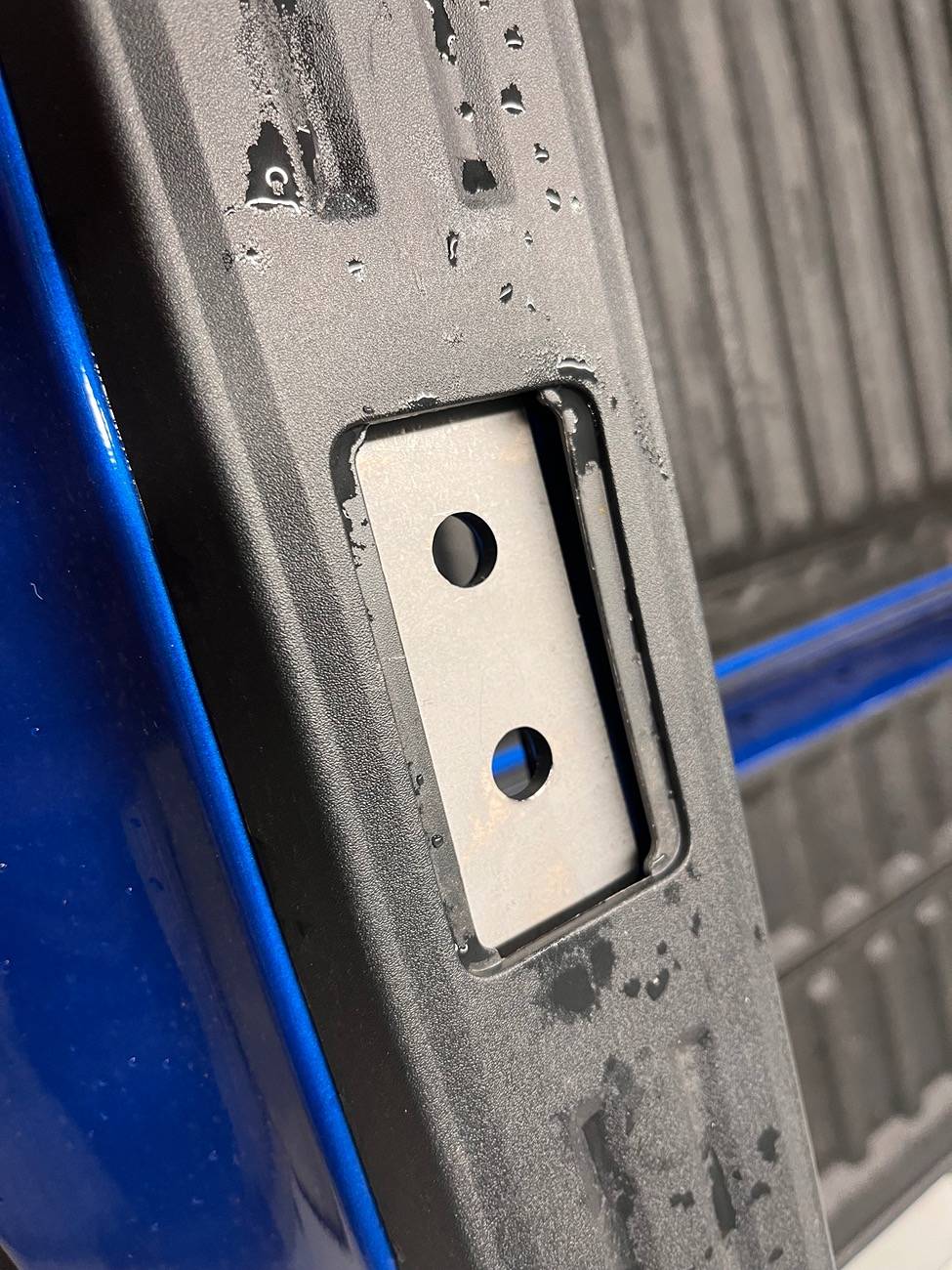

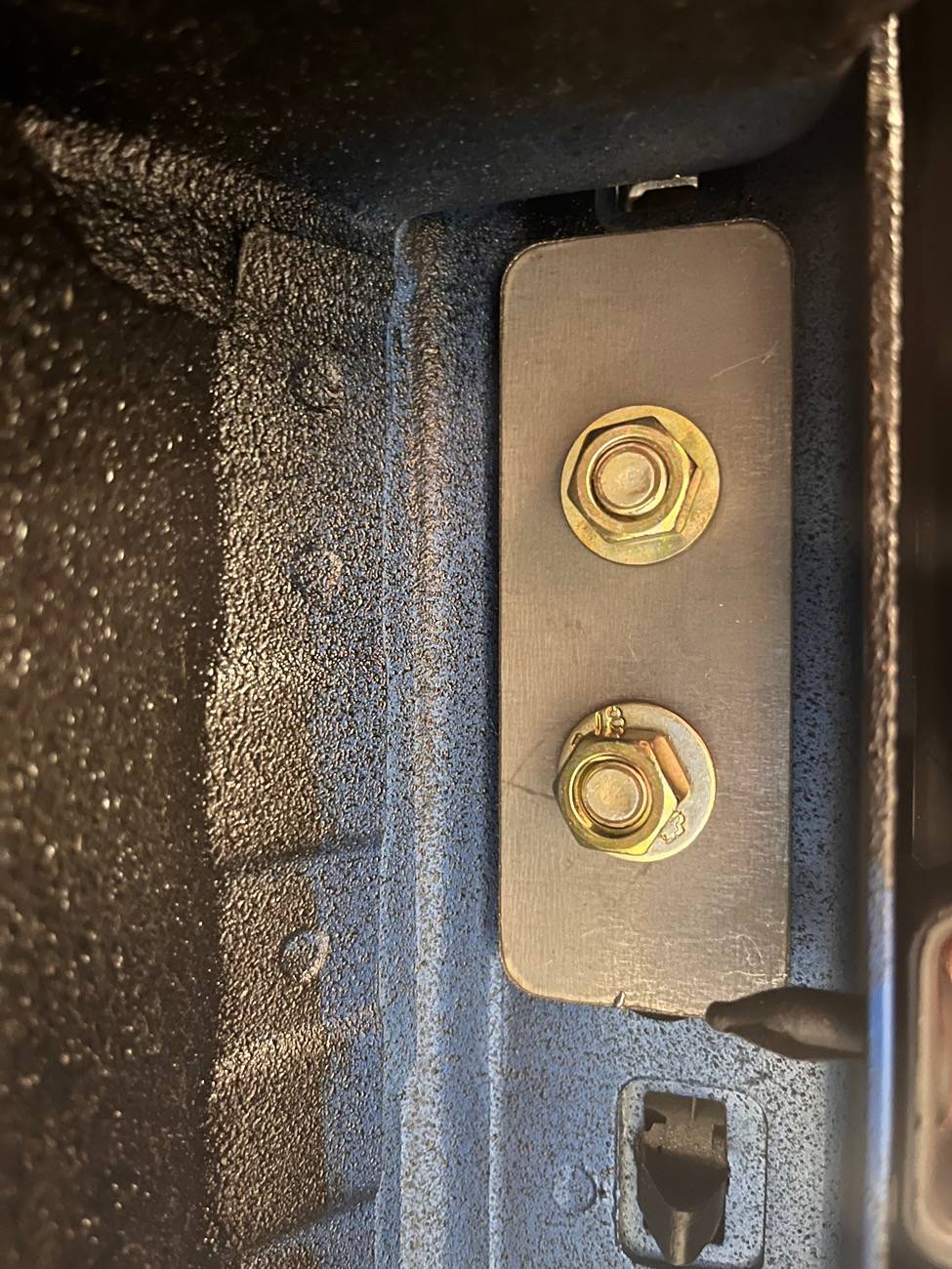

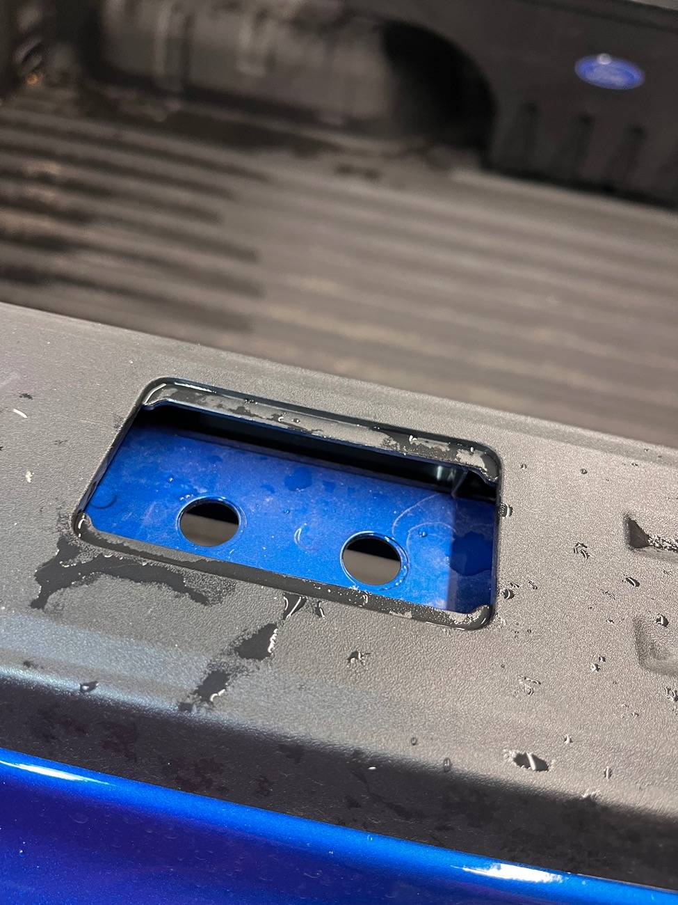

Ford Ranger Custom bed bars project IMG_3590
might have to open up the bottom holes some, but other than that, let’s see how it goes!

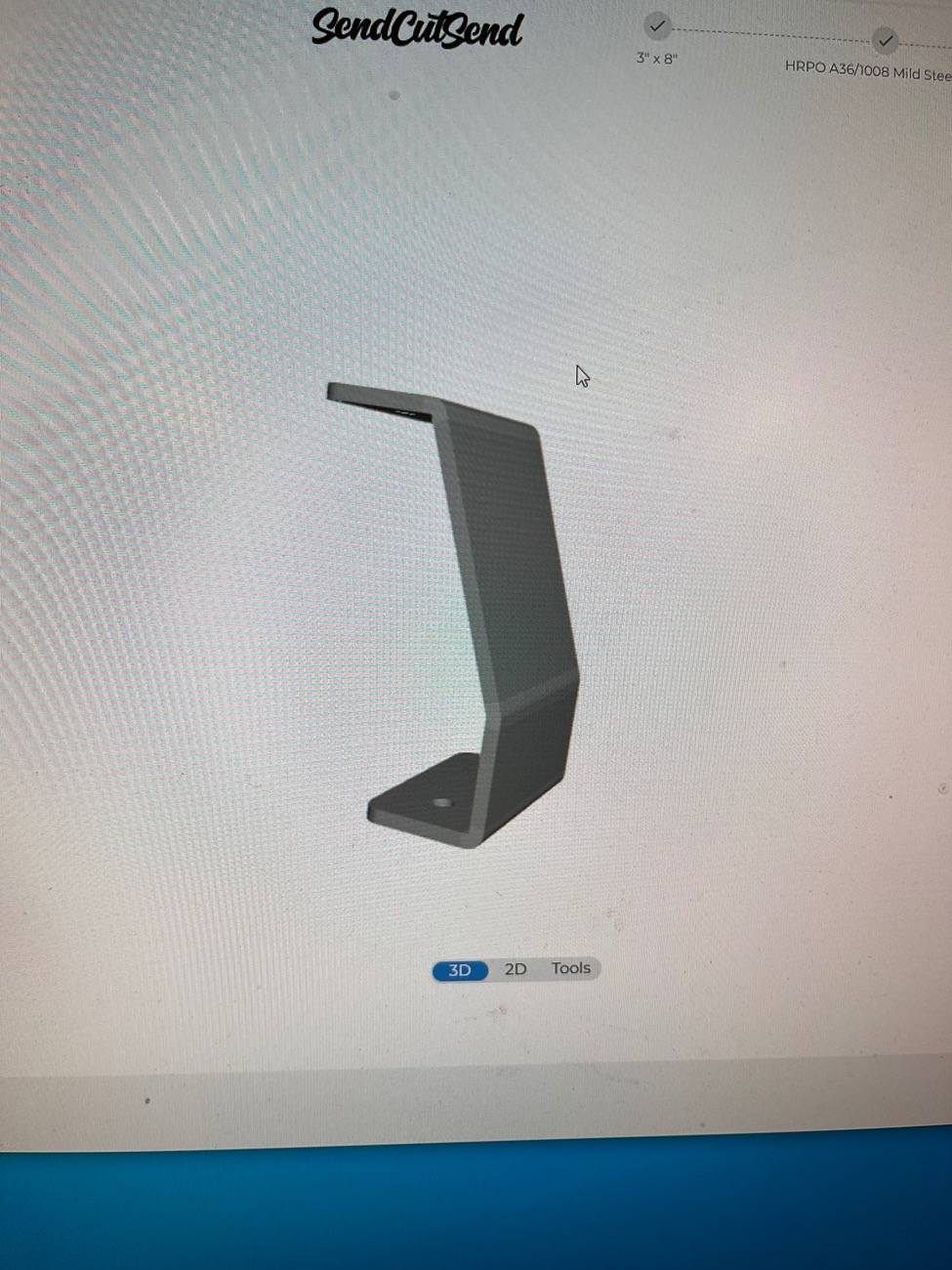

education
Exactly what I’m looking for. Really cool. Can you share a order # or something that would allow sendcutsend to recreate it? Great job ?
