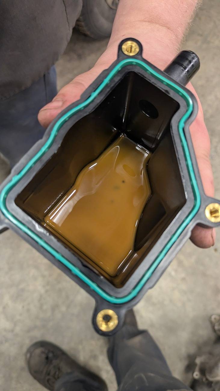

The attached picture was what my catch can looked like after 5000 miles in Montana cold weather a couple weeks ago for its oil change.

Looks great. I remember my FP can looking much worse on my old 5.0 F150. I always had to remove that one in winter.

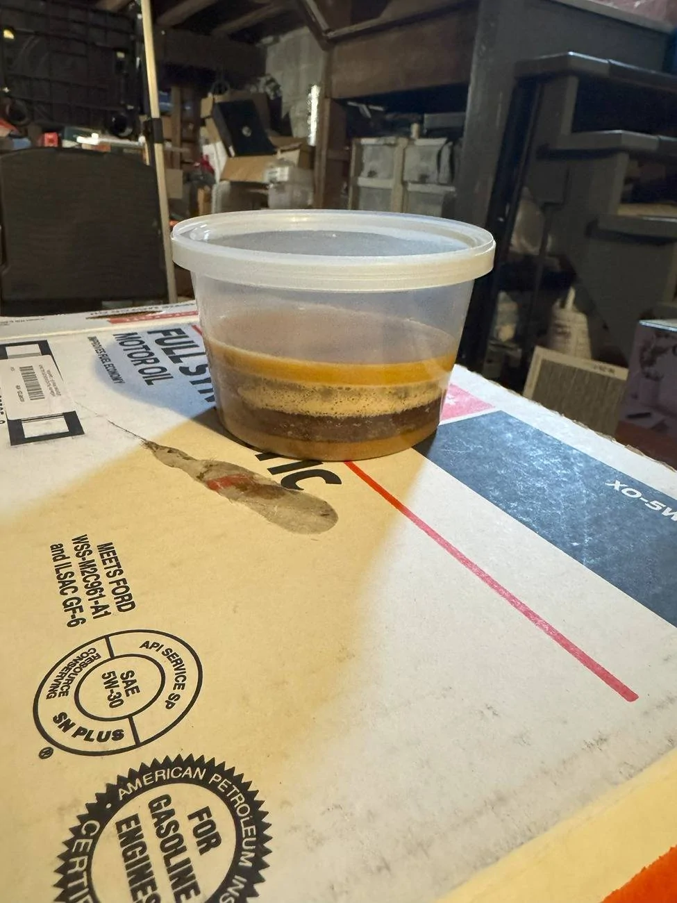

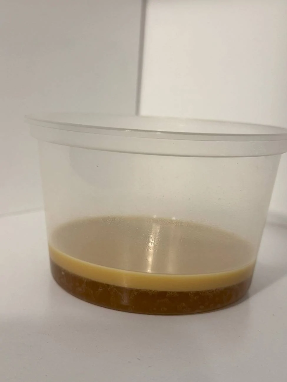

Just a follow-up. Here is a pic of a two week clean out with sub-zero temps. This was with about 1,200 miles. Can was about 20% full.
Mix of 200+ mile trips and 4 mile trips to the office. Remote start used most mornings with average 10 minute idle.
I also attached a pic of combined cleanouts since install in August.
