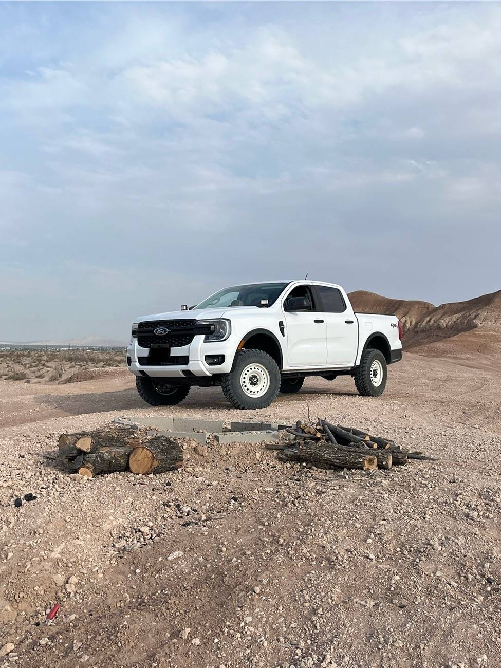

Love the steelies. Planning on doing the same myself once mine gets here; the PN is the same between 5G/6G Ranger spares and the Broncos. Did you pick them up used?
What size tires are you running? Leveling kit?

Sorry for the late response. Yeah the lug pattern is the same on 5G Rangers and on broncos. Front suspension is the same I believe on broncos and 5G Rangers too. I bought those rims from Facebook marketplace from a guy who took them off his 2021 bronco. The leveling kit was from rough country 2.5” on Amazon. It was for 2019-2022 rangers but it fits 2024 rangers. & the tire size I went with 265/75R16 Roadone cavalry M/T on Amazon, pretty cheap aggressive tires. I wanted to buy 285/75R16 originally but I didn’t want to run a wheel spacer. Maybe in the future

I dig it. ?
Details?
Sorry for the late response. Overall I bought everything cheap from Amazon. Road one Cavalry M/T tires 150 each. Rough country 2.5” spacer for 50 bucks. Ditch light bracket & lights from Amazon too. The rims off of Facebook marketplace for 200 for 5. Then I painted the rims with rustoleum spray cans. 2 coats of primer, 3 coats of white paint & 3 coats of clear coat.

What is the tire size?
Sorry for the late response. 265/75R16. Originally I wanted to buy 285/75R16 but I wanted to play it safe and I might’ve needed a spacer to clear the UCA. No rubbing at all and there is plenty of space with 265 size

Thanks for the updates. I still dig it. Post some more pictures when you get a chance. How's the Rough Country lift treating you?
