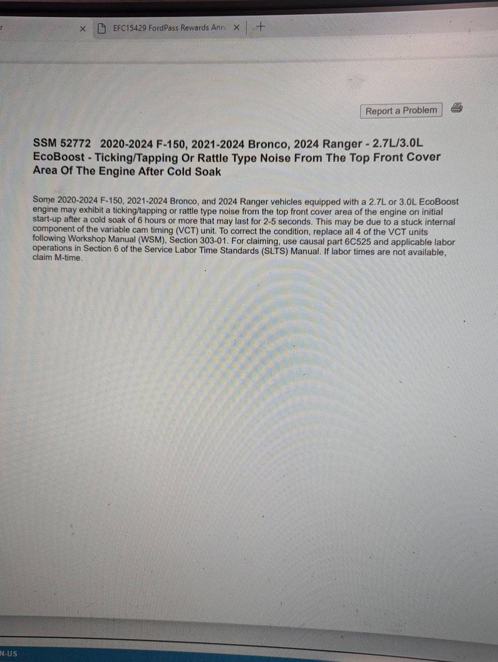

I know the 2.7 is a better fit for this truck but before I order my Lariat I want to be sure the Cam phaser issues are resolved. When I go on the Bronco forum people are still experiencing them failing even as late as 2024 and with a supposed redesigned part. This has been going on forever and it seems the 3.0 is worse but now Ford has admitted the problem on the current engines. I drove a 2.3 and the power is acceptable unloaded. I wish Ford was using the new 2.3 they are putting in the Mustang with the direct and port FI but they are not yet. Do we think they will switch to this engine when existing engines and parts are gone? Thoughts?.........

This is my second 2.7. Never had an issue with cam phasers and not losing any sleep about it.
The 2.3 is okay. The 2.7 is exceptional.

I had a 2018 F-150 2.7 liter ecoboost with the newly designed ports to eliminate the carbon buildup they were experiencing, and it ran strong for 53,000 miles before trade in. Then I had 2022 F-150 with the 2.7 ecoboost I traded in for my RR, and that ran strong as well. Zero issues with both motors. Total work horses. I thought I heard on one of these threads, where the company that was making parts for the camphasers, had a hard time holdings specs on their machined parts, or something to that effect. I'm not really familiar with these, but that's what I thought I remembered hearing somewhere in one of these threads. I wouldn't be concerned with you 2.7.

Well, I guess it isn't an issue, until it is. Seems to be a roll of the dice chance, like the 5G Ranger transmission failures or water in plug well #4 on the 2.3.
