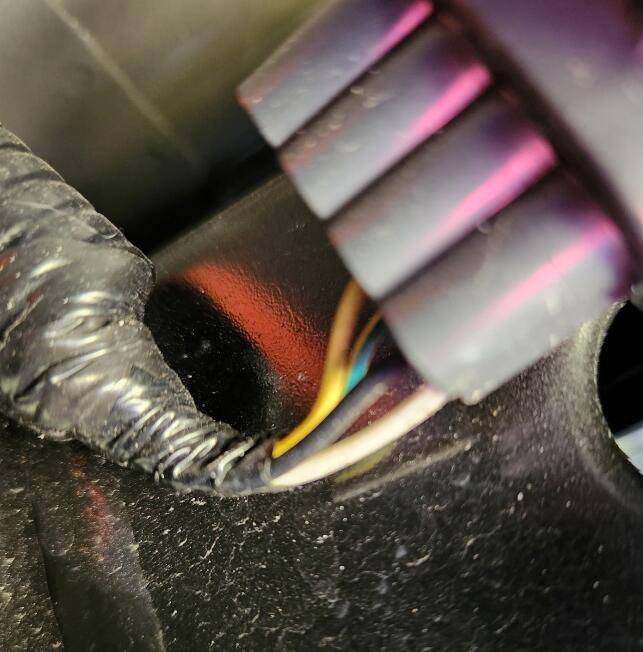

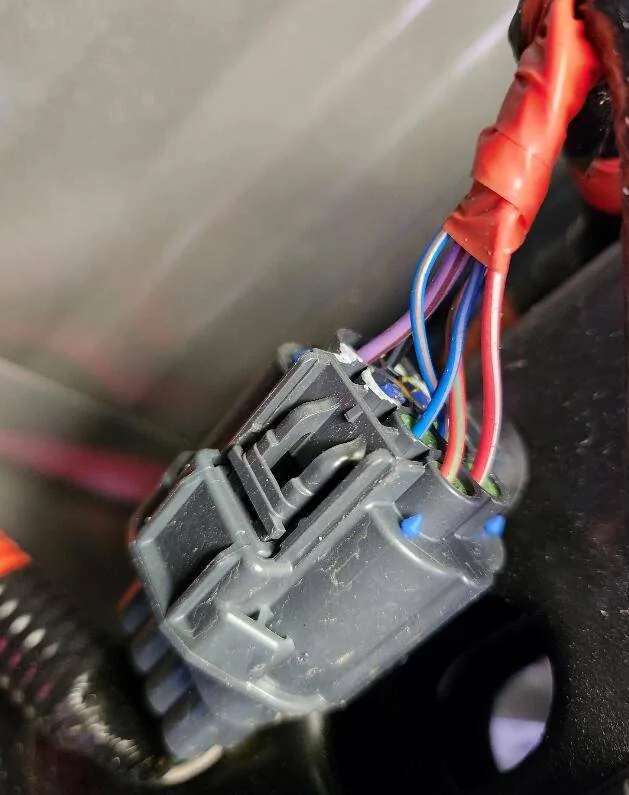

I don't have the resources to track down wire harness part numbers. My gut tells me that if you had the wire harness and hardware, you could add the stock 12V plug to the 2025. The plug coming off the main harness is 8 pins, 2 (purple) wired pins are unused and 4 (reds and blues) going to the 120V bed power plug. 🧐
If someone has schematics and part number hunting resources, it seems plausible to me.
Plug from main wire harness

Male Plug Going to 120V Bed Power

I think the factory method is out the door. The parts from 2024 are discontinued.
