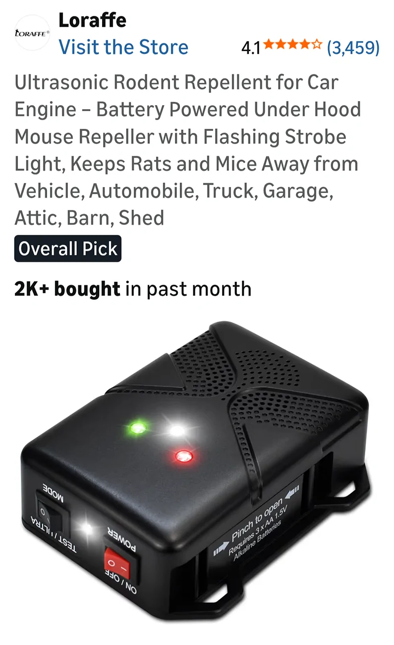

I've been using using something like this for four vehicles now.
Ford Ranger 2025 RR Engine coolant over temperature on cold start. Screenshot_20260324-180331_DuckDuckGo
