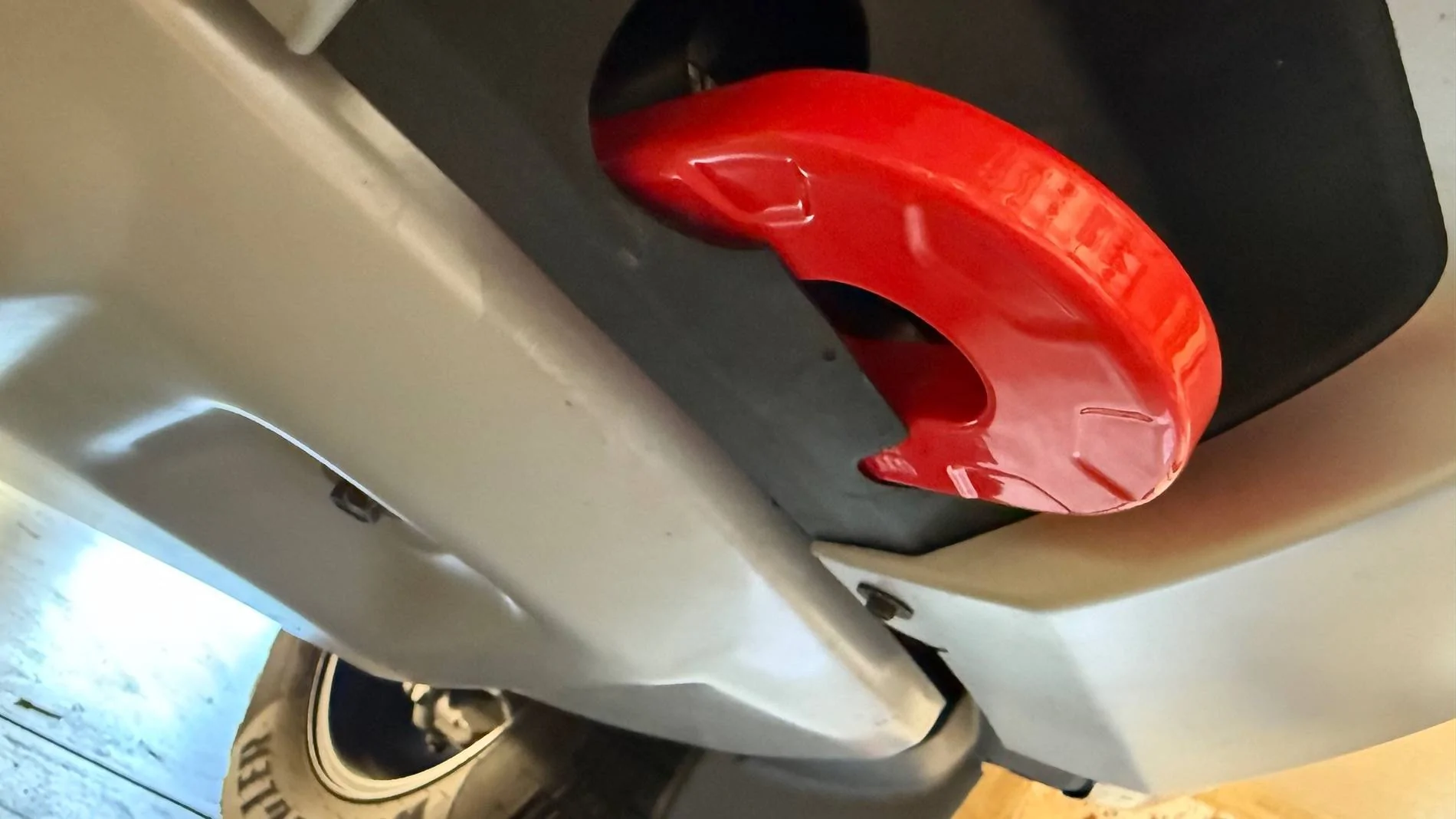

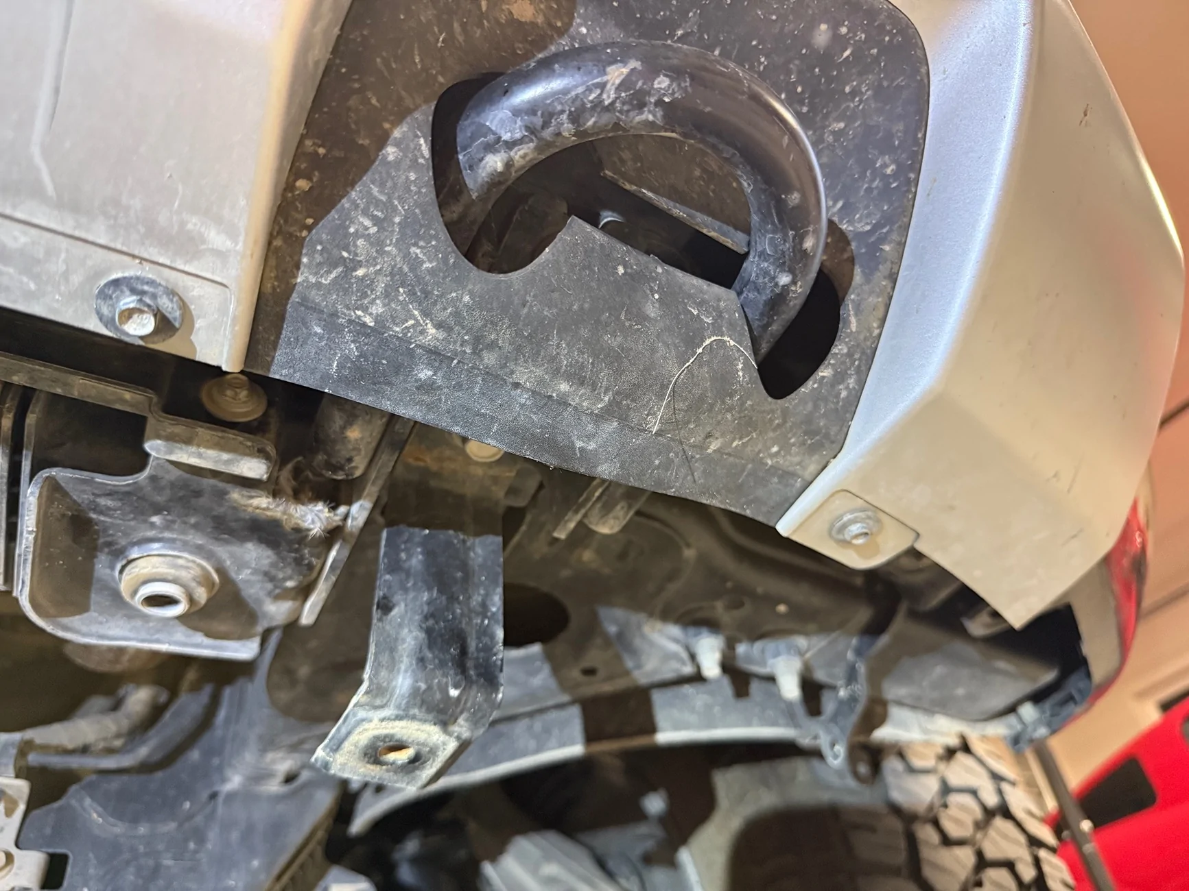

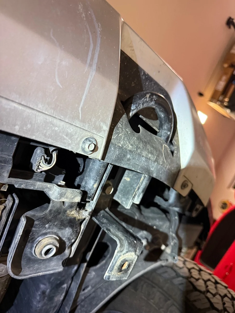

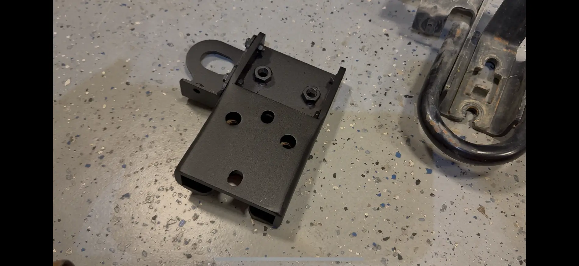

This evening I had a chance to install the @RIVAL 4x4 recovery points on our 24 FX4.
Right out the gate you can tell this kit is BEEFY. Not just the red recovery points themselves, but the mounting blocks. The factory recovery points are better than nothing, but these are on a different level.
Stock ones are mounted with stamped steel, the Rival Kit is all thick welded steel.
I have spoken with Alex from Rival at length about these and he tells me that this kit is based on the Australian market kit. And that in Australia if a recovery point is red it means something. It means that it has a minimum working load limit. In the states they are red or orange or yellow to match the OEM trim preference.
For years the Aussies have had the cool parts that we cannot get stateside. Thankfully Rival is doing their part to bring that engineering to us.

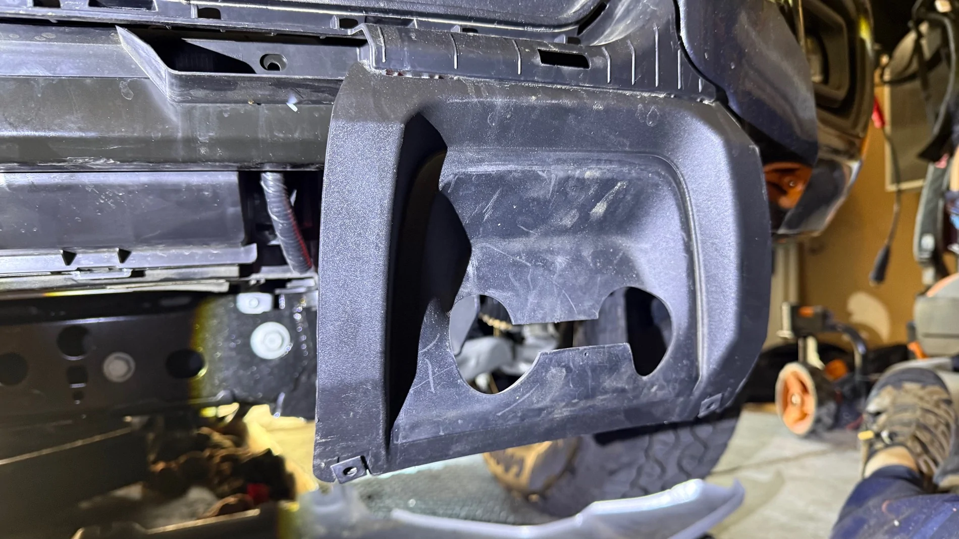

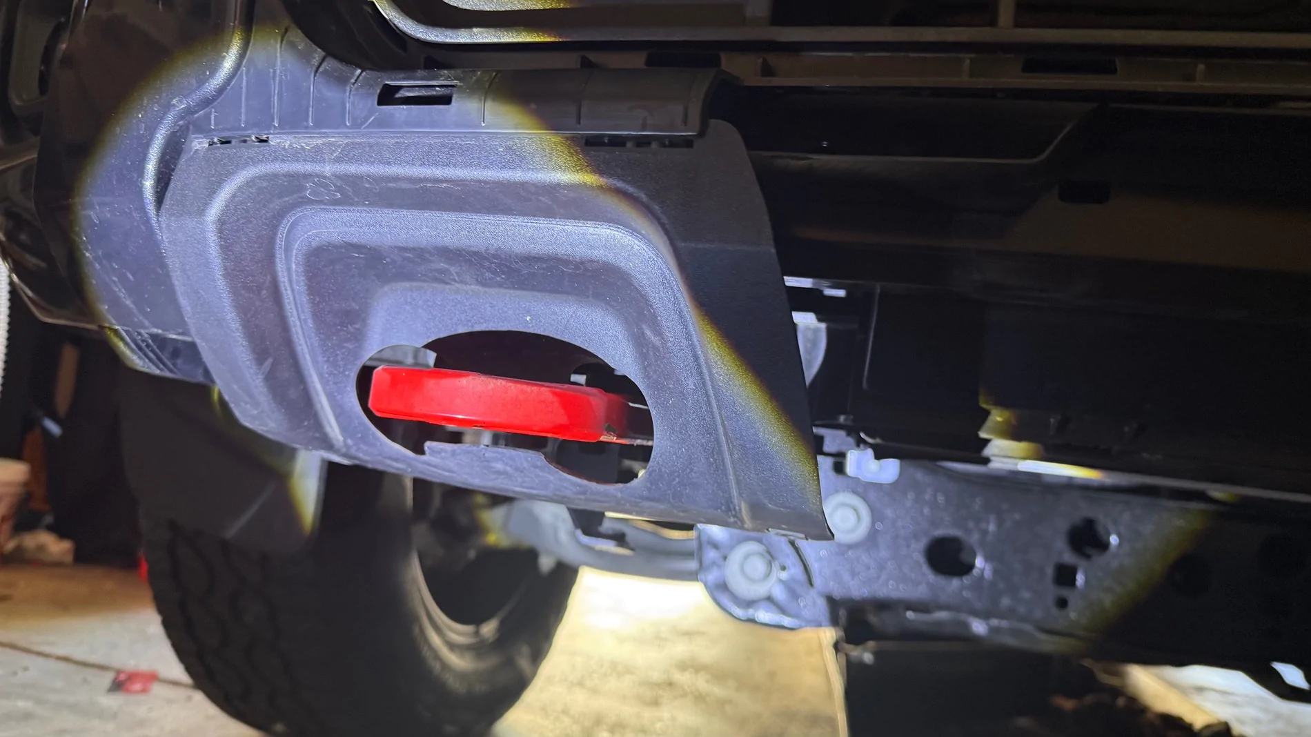

Was this the factory rubber filler panel? Raptor don't come with them and it's a huge gaping hole around the hooks.

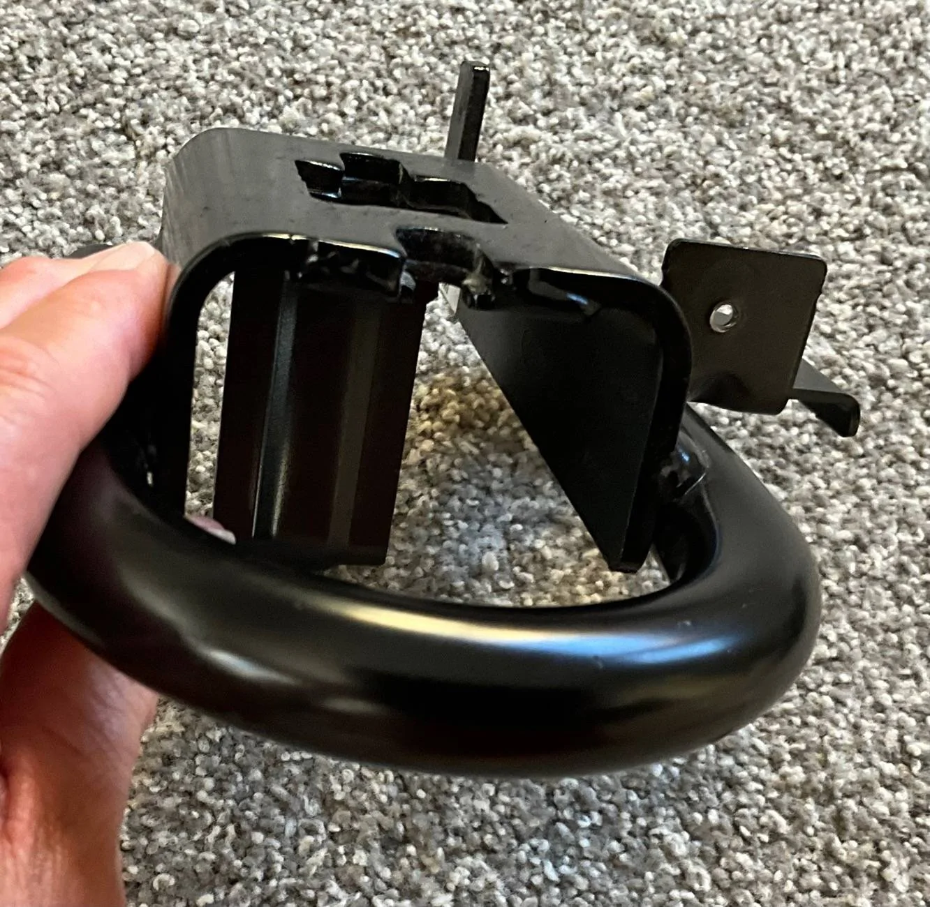

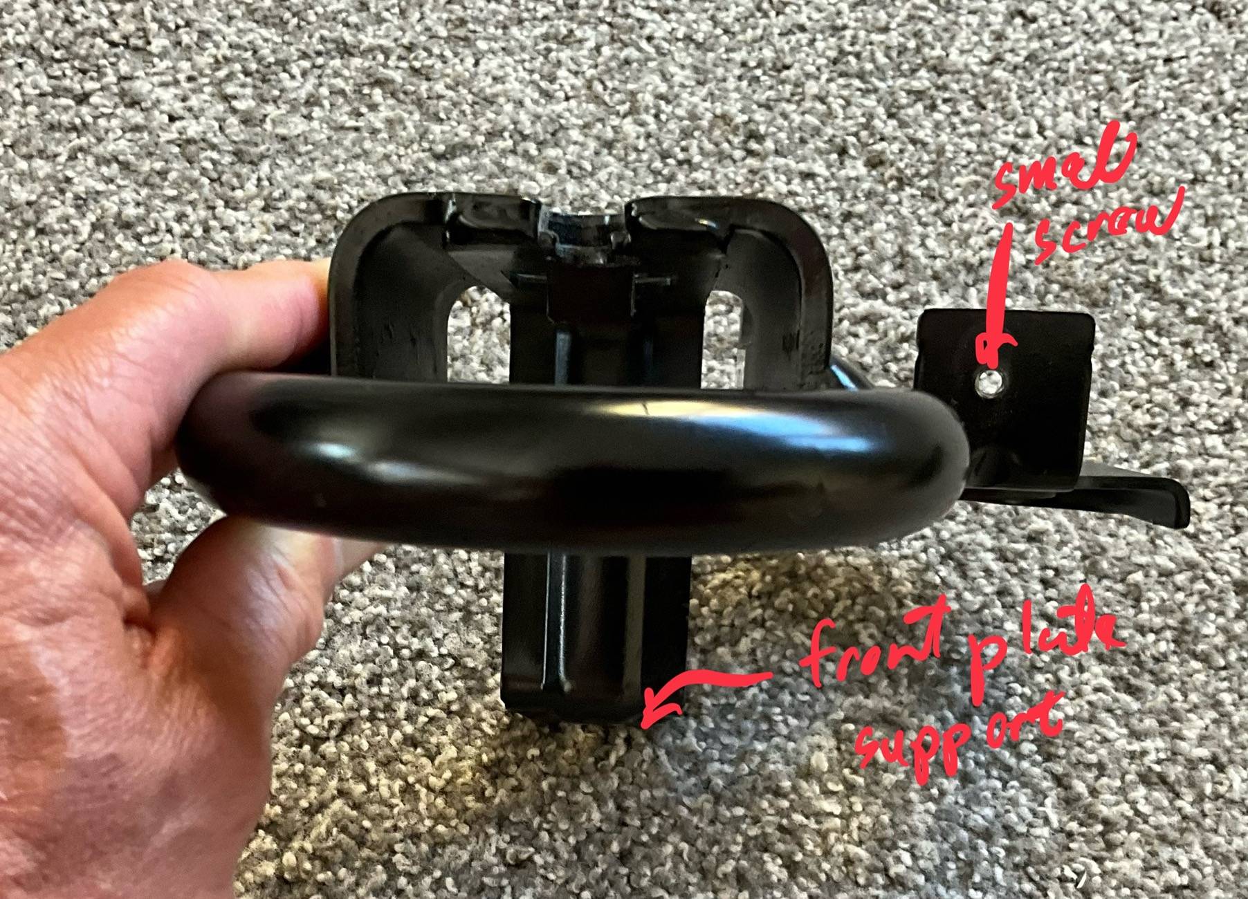

I guess what I don't understand about buying aftermarket hooks like Rival's....isn't the stock hook rated to withstand working limits including the truck's payload? Why do we need these aftermarket hooks? Why are we assuming the OEM hooks wouldn't hold? Wouldn't that be a HUGE liability to Ford if they didn't hold? Someone educate me here.

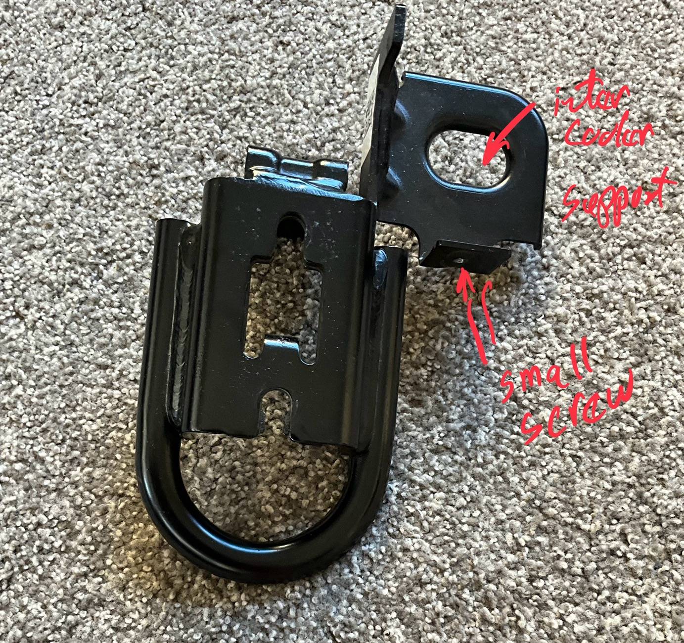

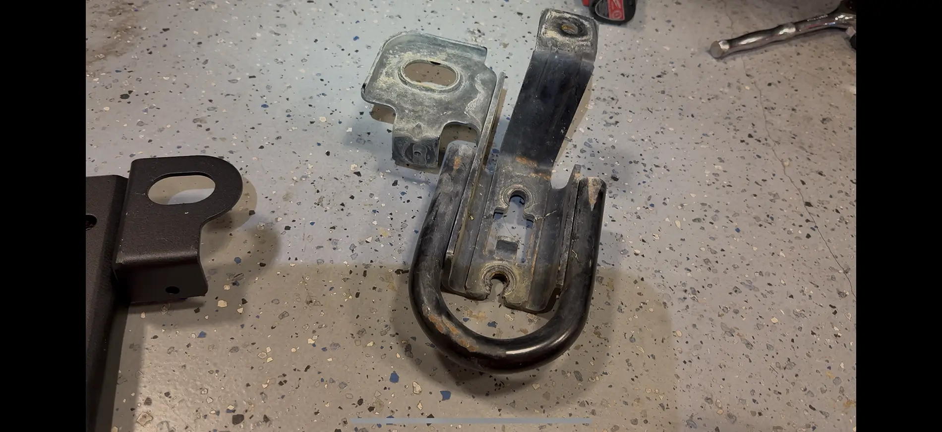

I think the OEM tow hooks are just fine. I installed the rival hooks also but after taking off the OEM hooks and having them in hand they aren’t that bad, it is a substantial chunk of steel.
i did see a video of someone and I can’t find it, with a bent tow hook and can’t find it now.
I think if you pull straight on the tow hook, the OEM is fine. The rival is probably stronger if the load is off axis.
ultimately both designs are connected to the fram with the same two bolts.
i did find this video And the guy agrees with me but i have nothing to support my claim. I personally think rival could do some marketing by showing a video comparing the designs tested to failure.
yes that is that is the OEM piece that comes with non raptors with tow hooks. it is held to the truck and to the front fascia by two bolts
the rival instructions tell you to trim the tongue, I just left mine as stock.
