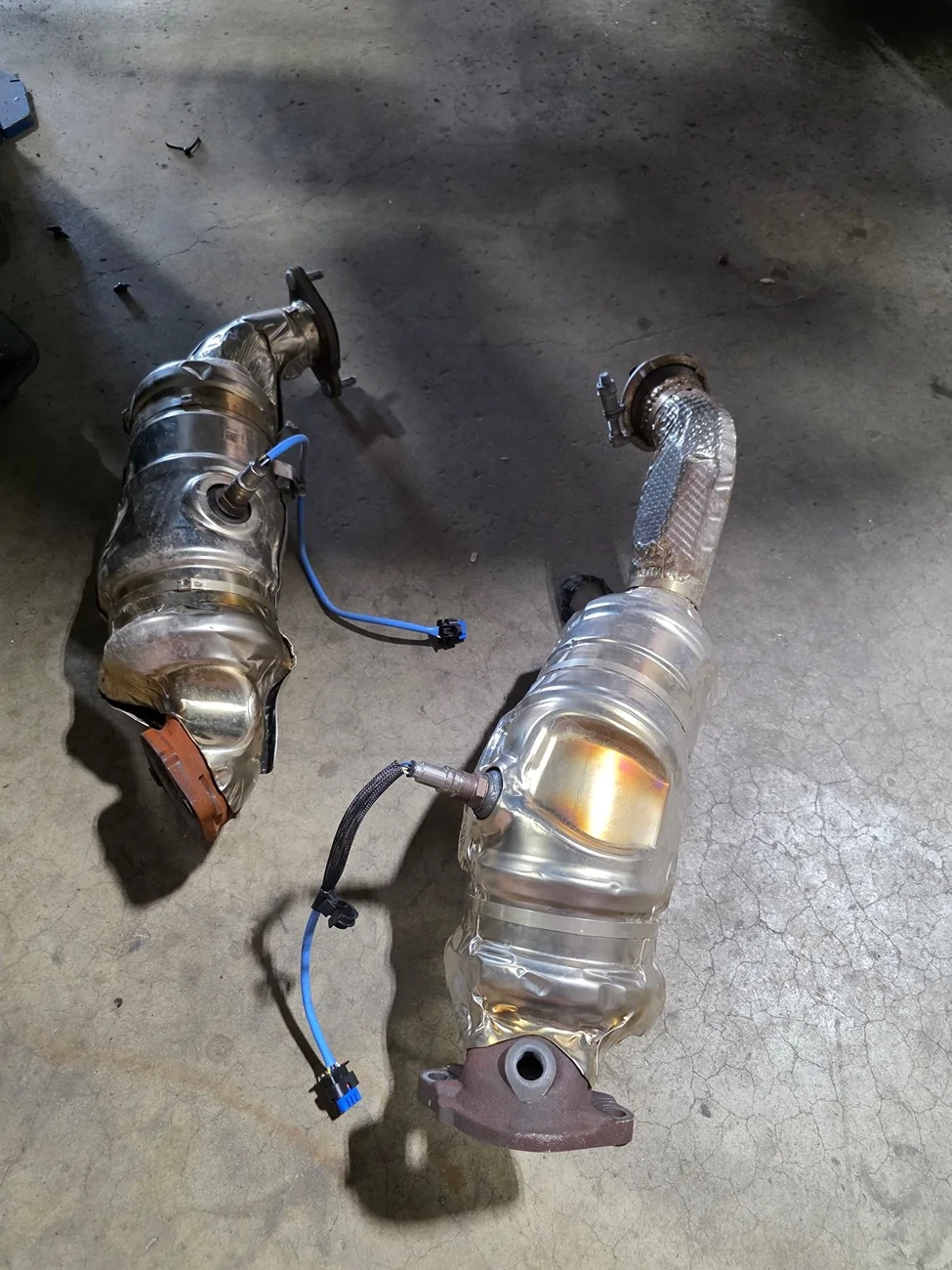

No, I’m not going to dyno after each modification. Some items such as the turbos and downpipes/cats logically make sense to change both at same time—as you have to remove the original cats/downpipes to change the turbos. Changing turbos, you have to drain coolant—might as well install thermostat and Water Heated AIG catch can. Logistically, it is difficult to do all of those dyno runs after every modification.
I do have a draggy, and made a few test runs before mods and I can use it to gauge improvements later.
I am also using the same or similar parts as several have done before—I am not recreating the wheel. I have spoken with several different builders and received assistance on parts and process. One vendor on here, DirtDerrick, helped me immensely getting my original plan together while I was waiting for my truck to be built—it didn’t include new turbos at first. We had a plan to make way more power than I thought I originally wanted. I bought parts from DD, and piled them up in my office before my truck arrived. Then, I got my truck and I don’t know what happened, first time I drove it, it was so fun, I wanted more. I watched some videos of 600hp RRs and got bit by the bug. Final straw was while I was at Raptor Assault school, DirtDerrick sent out the advertisement for the Garrett Powermax turbos and my build changed directions rapidly. I had just received the SPD downpipes I ordered from him a day before I went to Raptor Assault—and didn’t even have time to install them yet—and I thought, “While I’m in There”, might as well add some new turbos. We talked, new plan, and I had to have a set immediately.
Parts being installed now: Process West Stage 2 Charge/Crossover Pipes/Intercooler, Cold Air Intake, Turbosmart Blow-Off Valve. SPD Catted Downpipes, Thermostat, AIG Air/Oil/Separator (AOS), and new Tune.
Other non-engine stuff installing at same time, Mishmoto Transmission Pan, Process West Trans Cooler, Faust MotorSports Rear Shock Guards, Sensor shields, Lower Control Arm Skids, Rear Differential Skid.
I did my first oil change at 2000miles. I also took a sample of the oil and sent it to Blackstone Labs for analysis. I did not want to add performance parts to a sick engine (a lot of new car engines seem to be having all kinds of problems). The report came back with a clean bill of health —it had elevated levels of copper, iron, and silicone—which is exactly what it should be for a new engine properly breaking in.
The dyno run conducted last Friday provided data for the tuner, and gave me a baseline for all the modifications.
