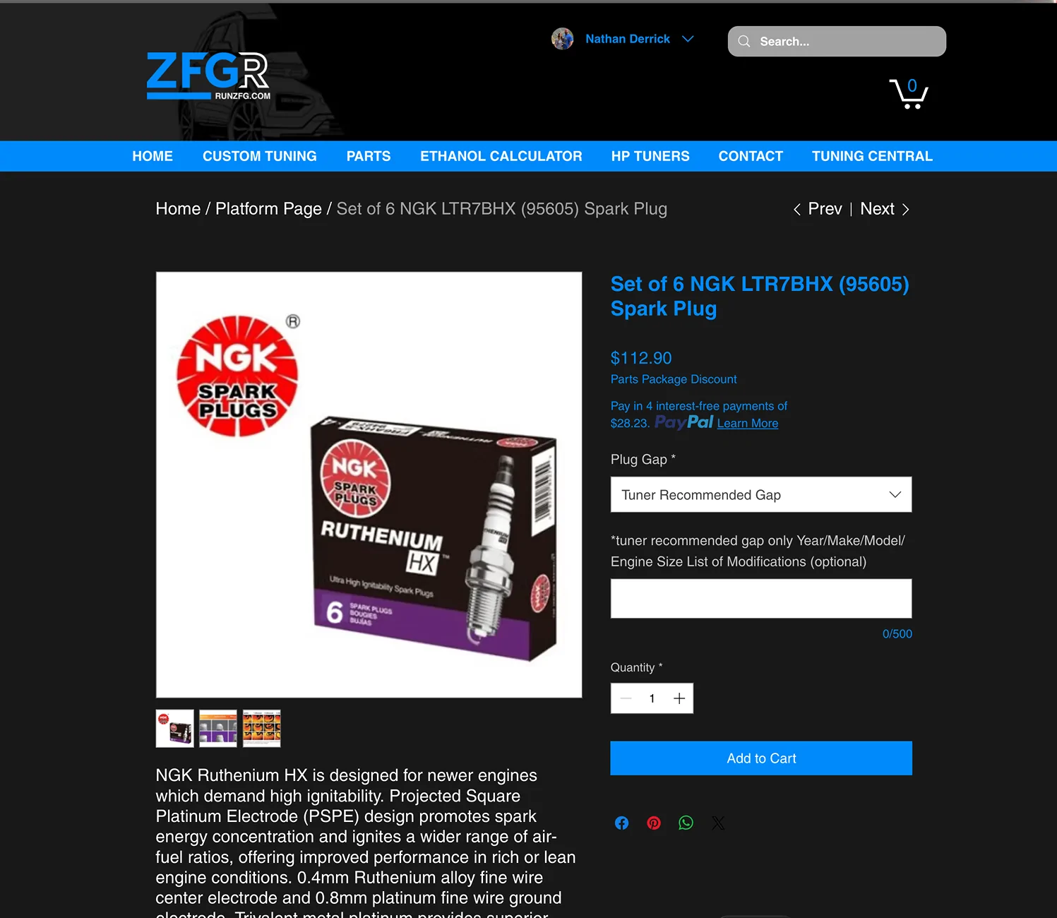

Hey if you haven't already, with everything you're doing, these plugs. I get them from ZFG and have him gap them based on my current mods, that price is with ZFG gaping them.
I think I’m getting old—I couldn’t find them on your website. As usual—no rush, I just need them before Dyno on Monday. I know humor doesn’t transfer very well in text—but I have a big grin on my face.

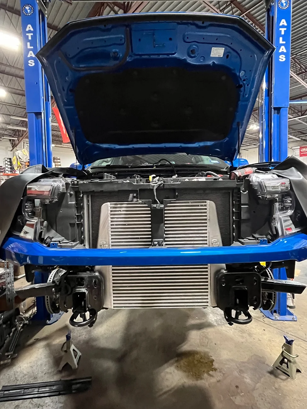

Process West Stage 2 Intercooler installation. The entire front end of the truck had to be removed to install the huge intercooler. Not shown in the pic, I also installed the PW trans cooler. The guys at the shop seem to be doing an awesome job.

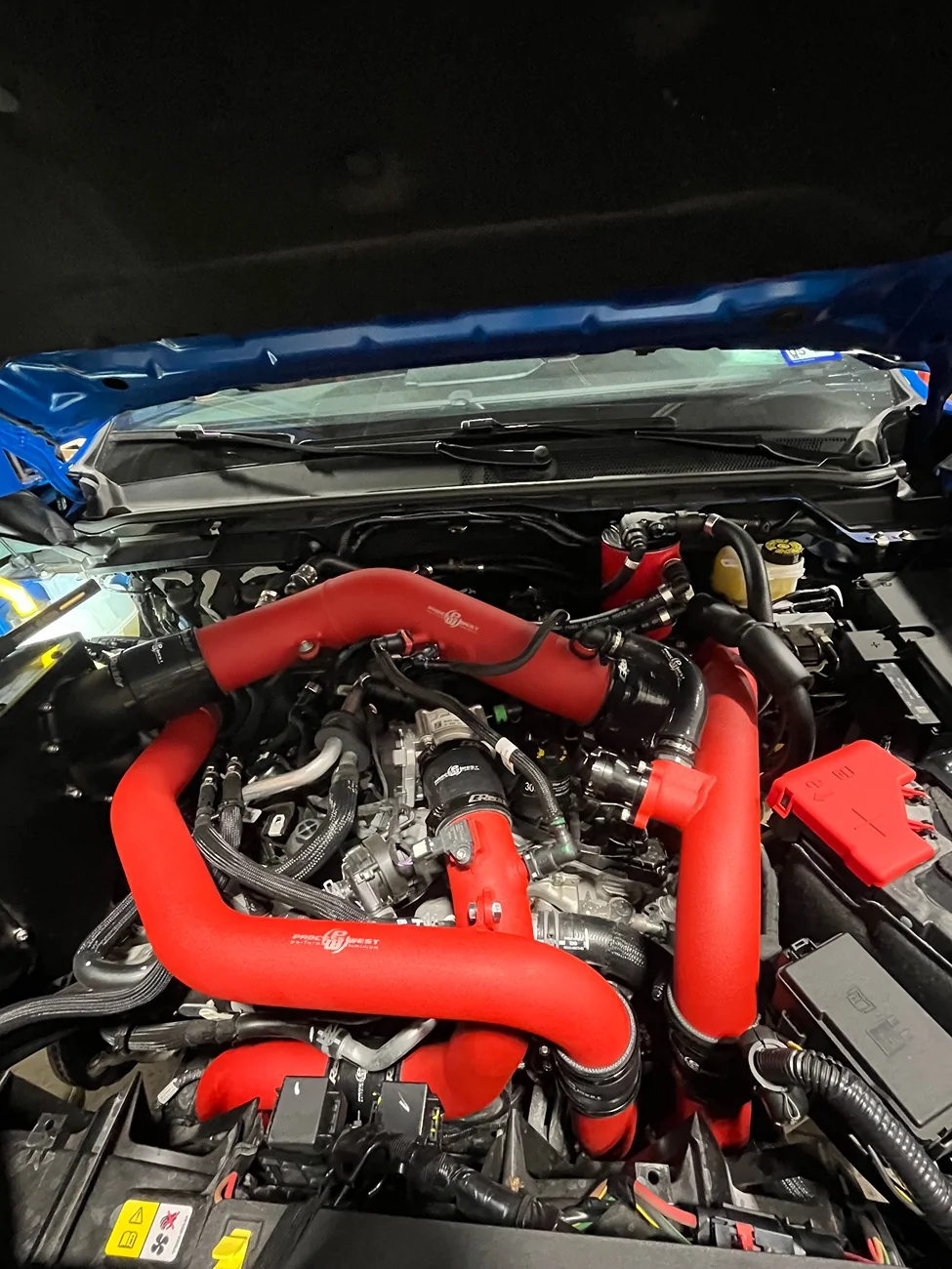

Process West Charge/Crossover Pipes installation. The red pipes really stand out and add some “pop” to the engine compartment.

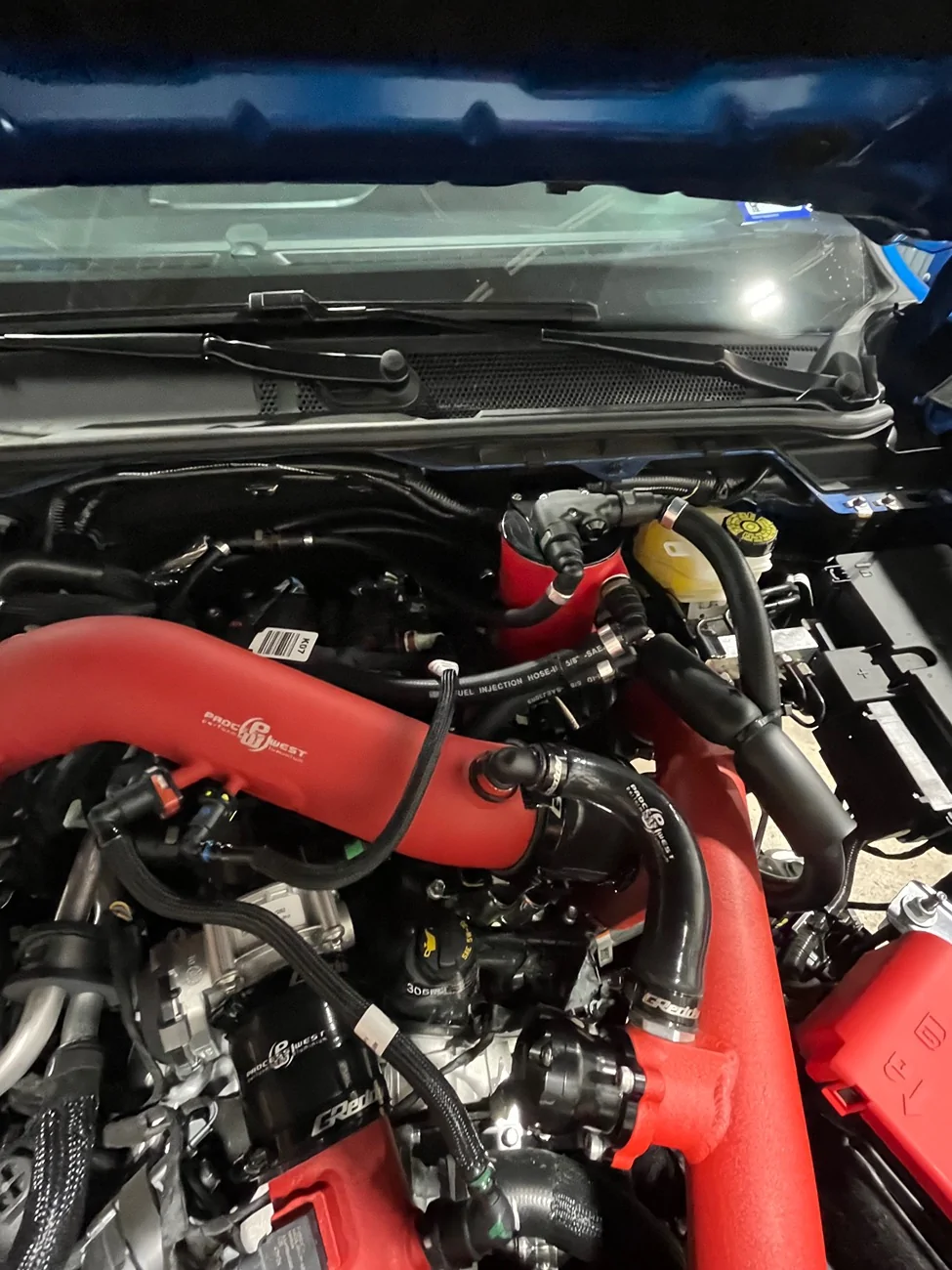

Also installed is a Turbosmart blow-off valve. On the firewall, just to the left of the master cylinder, is a Red can. That is a IAG brand Air Oil Separator (AOS)— basically, it’s an oil catch can that is connected to the cooling system and heats the collected oil, removing the water, and returning the oil back to the crankcase. Supposed to be maintenance free, in that you don’t have to dump the oil, and should function in cold weather. We will see.

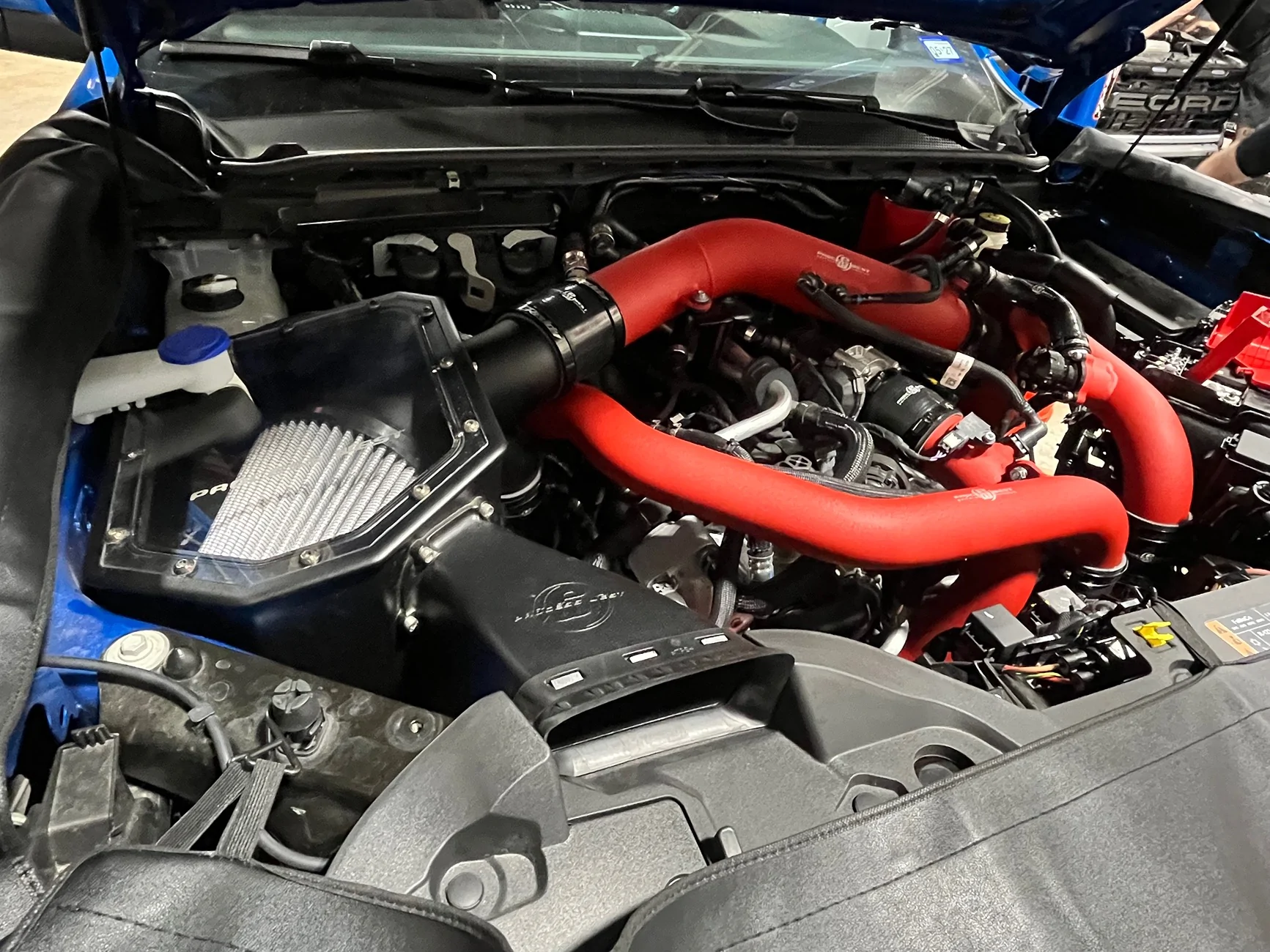

Installed the Process West Cold Air Box. The air filter was changed from oiled cotton to an AFE dry media filter.
