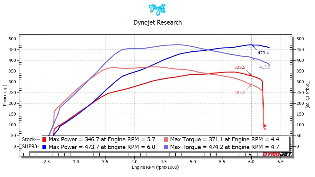

Fresh 93 fuel. The blue lines are last runs today (474Whp). Red lines are the baseline from when the truck was stock (347Whp). A 127 hp improvement. There was more power to be had, butt, the injector pulse widths were too wide and the fuel pressure dropped from 3600psi to under 3000 psi. It needs more fuel. I tried to overnight a set of injectors and pump from Nostrum a few days ago—but one component of the kit will take up to 3 weeks for them to get from their supplier—I’ll have to wait. The Tuner, Cody from Stanghi.com, thinks there is a lot more to be had with more fuel. video
The video is of the 474whp run. Sounds nice on “normal” exhaust mode. The SPD Cat/downpipes can be heard-kind of a growl- if you compare the video sound from the video at the beginning of this post when it was stock and this one at 474whp. The truck is far more aggressive—in stock video, I could barely tell the Truck’s wheels were moving—in this video, you can see the truck squat and rise under torque. I pick up the truck tomorrow and I will see if I can get a draggy run to compare to the I made when the truck was stock. Thanks to my industry experts: Texas Motorworx, Nathan, Winfield, Kyle, and Nick—for answering all my dumb-assed questions and pointing me in the right direction.

I find it odd that your HP and torque don't cross at 5252. I thought that was a physics rule.
Goosetuned
Gold Sponsor
Winfield
Apr 14, 2025
441
683
AZ, NM, TX
Professional Tuner
Torque scale is off. Use the HP to back calculate real torque values.
This happens for various reasons related to the dyno not being setup properly.

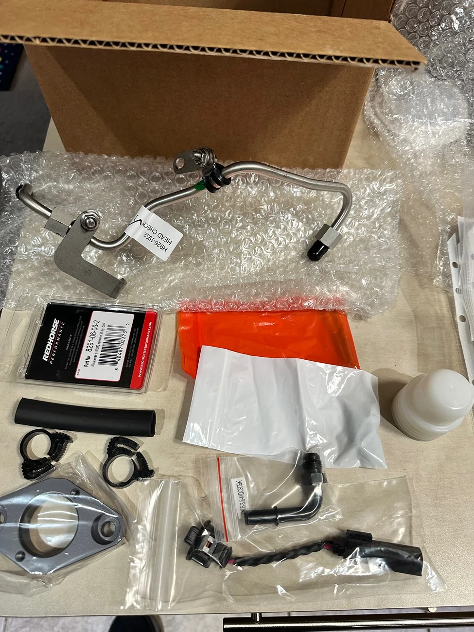

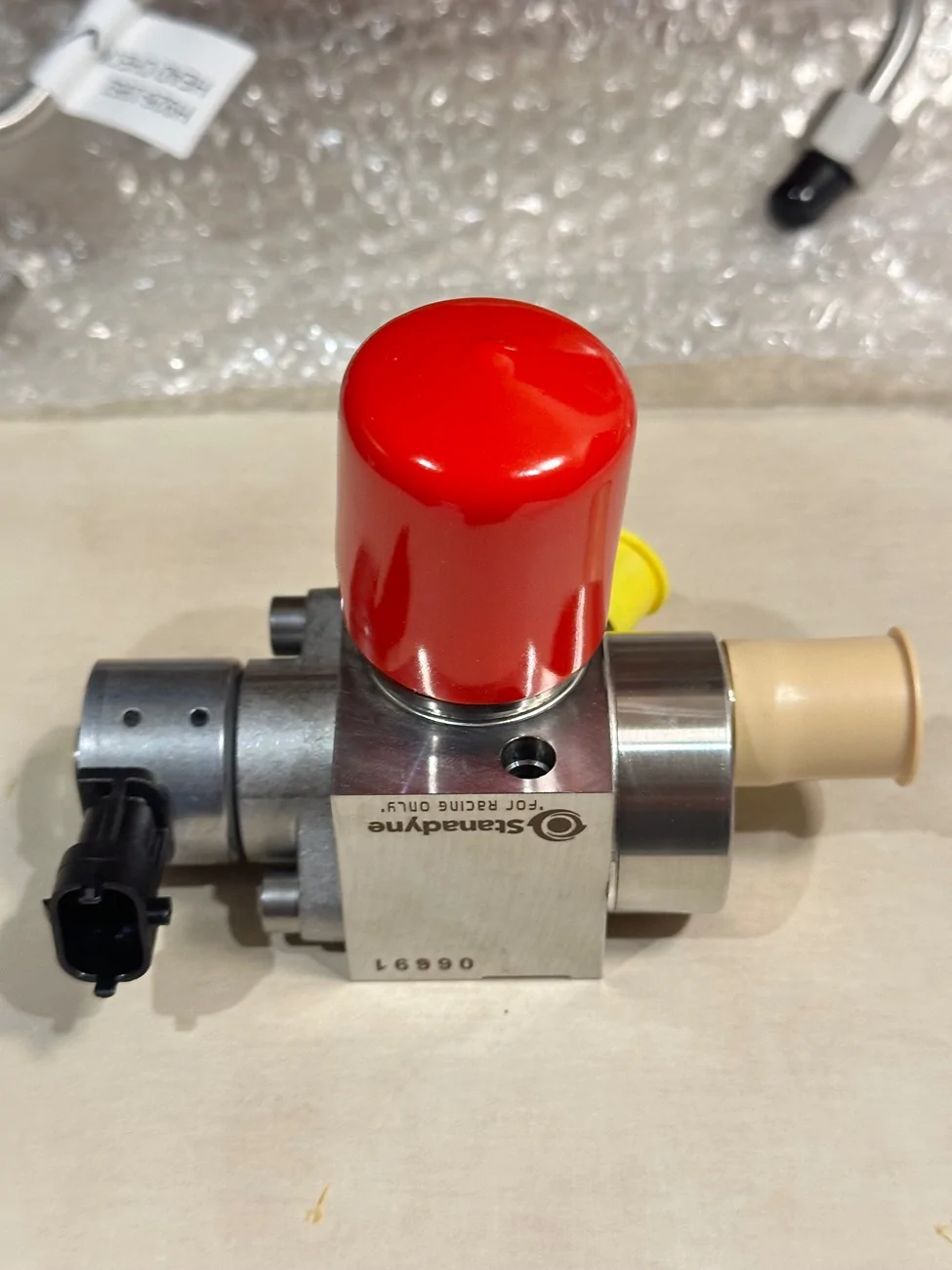

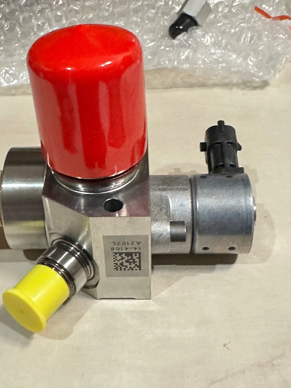

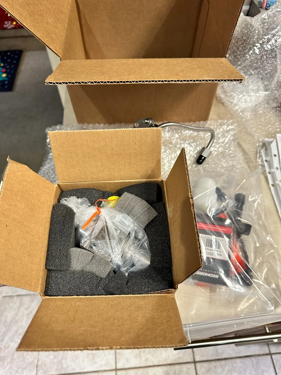

In December, the pump and Injectors arrived. The boys at Nostrum, Frank and Nick, run a class act. Their products arrived so well packed, and every piece has its own serial number (pump and each Injector). The kit is built to the highest caliber--when you see it in person, it is understandable why it costs so much.
Ford Ranger Ranger Raptor on Dyno + Turbo Upgrade tempImagewqoYF

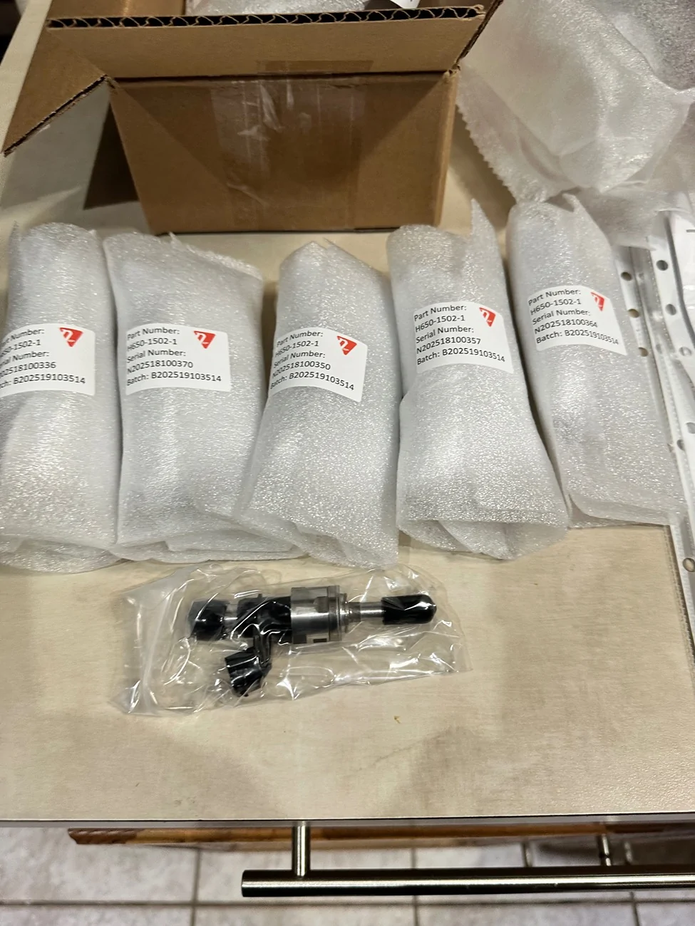

The injectors are individually wrapped
Ford Ranger Ranger Raptor on Dyno + Turbo Upgrade tempImage4wIV4
The pump looks like a piece of jewelry

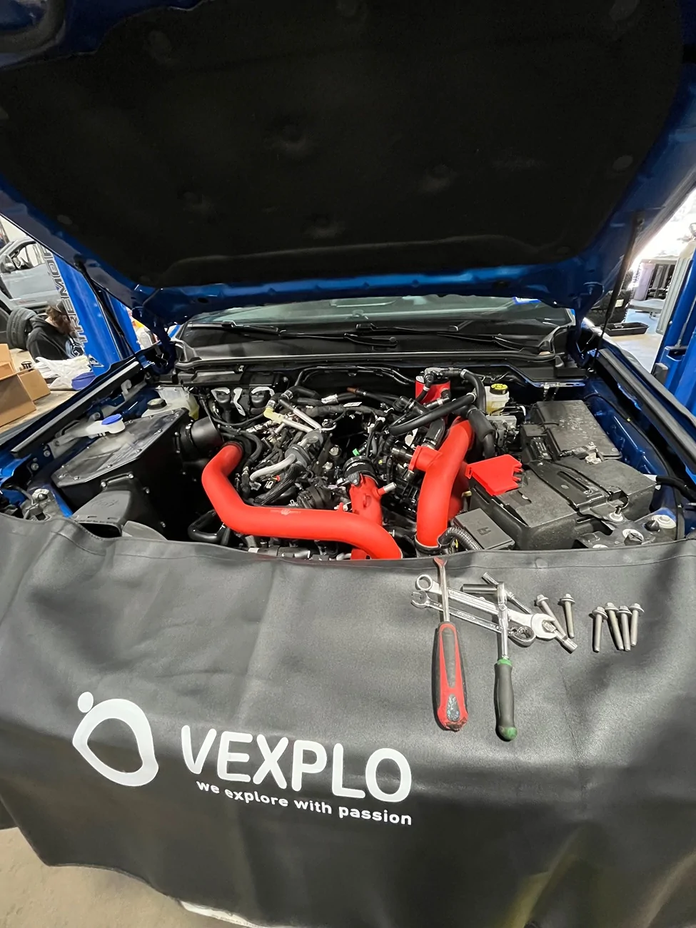

The entire top of the engine has to come off for installation
Ford Ranger Ranger Raptor on Dyno + Turbo Upgrade tempImage666jMR

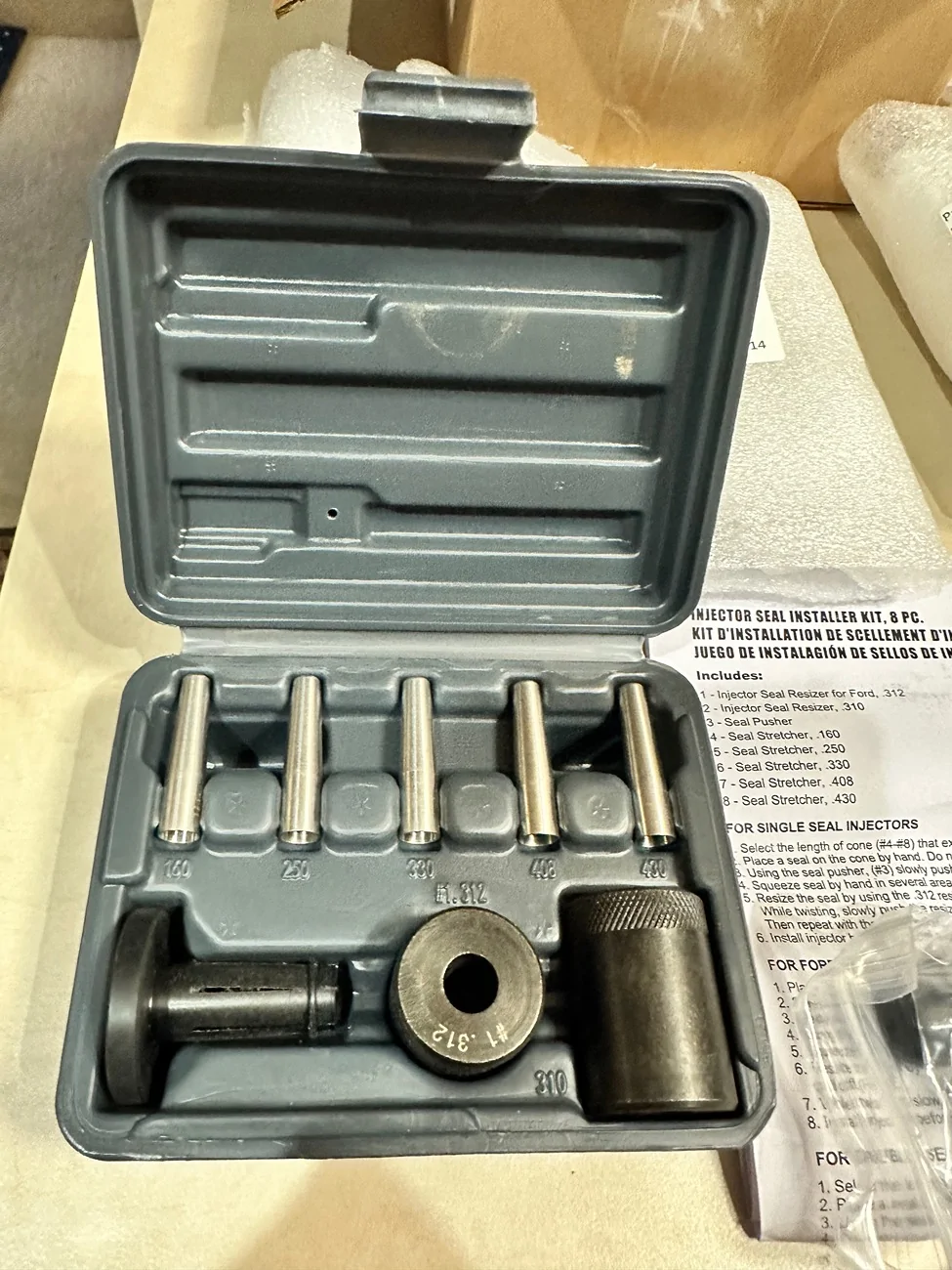

Special tools to install the injector seals, not so much to install them on the injector (they come installed--but the long tapered tools spread the seal to install them on the injector. You need this kit because you have to shrink/swedge the teflon seal to install the injector in the cylinder head.

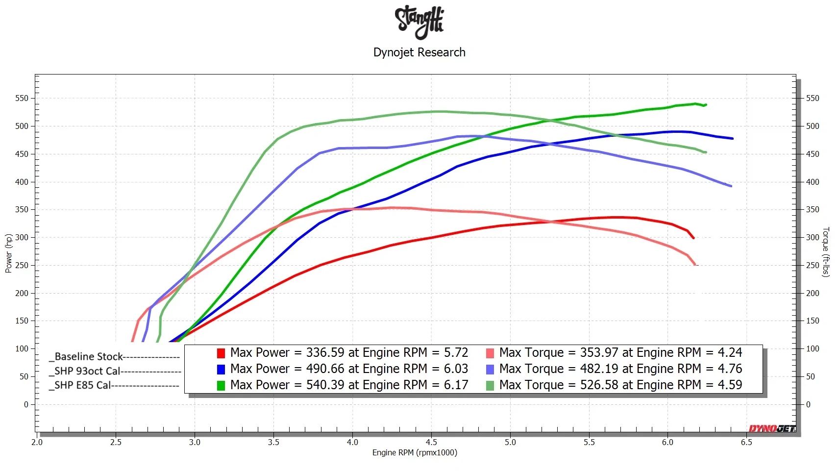

So, without rambling on here is the latest dyno chart.
Ford Ranger Ranger Raptor on Dyno + Turbo Upgrade 7DD73C4A-3C74-4206-957B-FB71E69B98FB_1_102_o
The Red lines are 93 octane, 337whp, and bone stock, at just under 2000miles on truck
What is missing here, is the October tune, at the beginning of this post, where we made 474who and 474lbft of torque with turbos, cats, intercooler, etc, at about 2500miles on truck

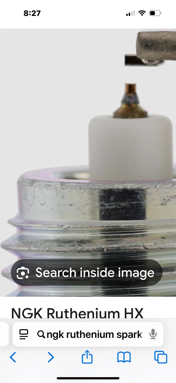

The Blue lines 93 octane, 490whp are after the Nostrum "X" series fuel system and Ruthenium plugs at about 3500miles on truck
Green lines are e85, 540whp and were at the same time as above.
Here is truck at speed on the dyno, on 93 octane tune
Lessons learned: Don't modify a brand new truck. There are slight year to year changes that the aftermarket doesn't quite know when the new year first drops--sometimes you wind up being the guinea pig.
The engine has a lot more power capability. We didn't go for peak numbers and tried to get the highest, and flatest torque curve over the entire rpm range. There is more to be had. If you look at the charts, on e85, I barely sacrificed torque beginning at about 2750rpm (about 150rpm higher than the original torque beginning at about 2600rpm)--that is negligible and better than any other performance vehicle I've owned and built. All the power made is right in the zone where a street and Offroad vehicle need it most--it makes over 450lbft of torque from about 3400rpm all the way through about 6300rpm. That 3000rpm power band where the boost starts spooling hard is right where you spend all of your time driving at. A huge part of the curve is over 500lbft of torque.
In tuning, there appears to be a hard stop somewhere in the 2025 computer for the waste gates and the blowoff valve, I don't remember the exact number the tuner told me, but I think it was 30 or 32psi that it won't allow us to go over--at some point they will crack it and I'll get another tune At present--I tried to look at the dash gauge to see where at what psi boost stopped--but, its about all I can do to look where I'm going and turn the steering wheel when I am at max boost. I want to know, but I don't want to crash to find out--next time I have the wife or kid with me, I'll have them watch the boost gauge.
E85 is about 100-105 octane, it can take way more boost and timing. But, for right now, we are just going leave the engine where it is and just drive it--it still doesn't have 4k miles on it yet. We have some Offroad Events, Baja Runs, and Texas Raptor Runs we want to attend this summer and are hoping to make Domo next week. We are waiting for the new Fox Racing shocks we have pre-ordered to arrive and we can build out our suspension, steering, bump stops, wheels, etc.
E85 is harder to get during cold weather, and can be as low as e55 at the pumps at different times of the year. We can use our HP tuner MPVI4, the TDN (Tune Delivery Network) with our cell phone to change the tune back to 93 octane, or lower gas if we can't find e85 or the quality is poor--or the temperature is too low to run (it can be hard to start a cold engine on ethanol in the winter).

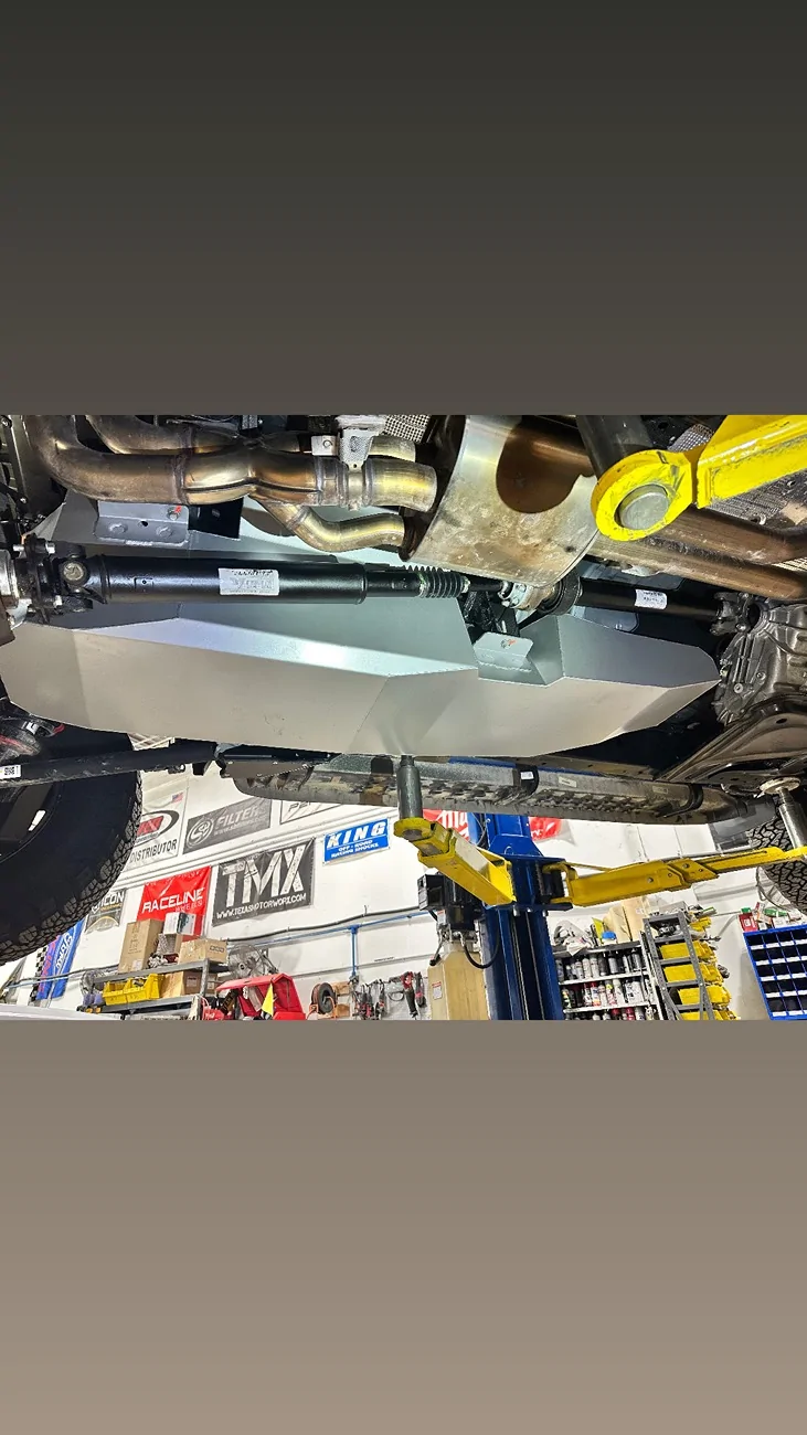

Not being negative, but my mind goes to fixing the fuel tank reading, & what happened to the driveshaft? If it was like mine, the rust stopped holding it together. You actually got a painted one.

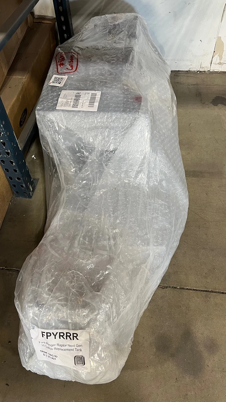

Thanks for the compliment—you want to know about the Long Range America 35 gallon tank? If I could go back to the beginning, the first mod I would buy is that tank. Our trucks only have 20.3 gallons from the factory. We wind up with less than a 300 mile range. With that tank, you get over 500–mine said 565 miles to empty on 93 octane. It’s not super hard to install, but it is a lot easier to do on a lift with a transmission jack. Takes about 6 hours with skilled (the shop I used had installed several of these tanks before in F150s, Super Duties and one Ranger Raptor)—it still takes them 6 hours.
I purchased my tank from the manufacturers distributor in Boise Idaho last year during Black Friday. I paid less than $2400 including taxes and delivery. I saved $200 by not having residential delivery and sending it to a commercial address—the shop I had do the work. If you have a 2025+ truck, you will need to have a tuner program the gallon capacity in the ECM to have correct gauge readings. Your fuel gauge, distance to empty, and mileage won’t be correct until you do.

My driveshaft was never rusty—it was bare steel, because my truck has never been in the rain. It has spent most of the 8 months I’ve owned it in various shops having work done. The shaft started clanking and spewed the grease out of the U-joint, Ford warrantied it with another bare steel replacement. When I had it over at TMX on a lift, I was bitching about how Ford didn’t even paint our driveshafts—one of the guys there immaculately masked off the shaft, around all the stickers and painted it like you see in the pictures.
