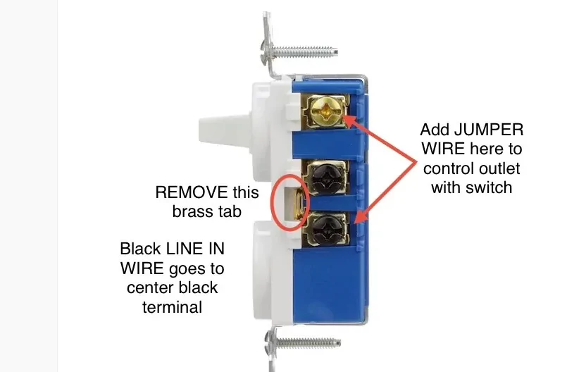

Curious though why you broke the tab on the device and added a jumper as opposed to just feeding the top screw with the line?
edit: ooops I just noticed there is a pilot on the switch, does the pilot stay on all the time if you feed the top screw?
Ford Ranger Battery tender charger mounted high on garage wall combo devic
