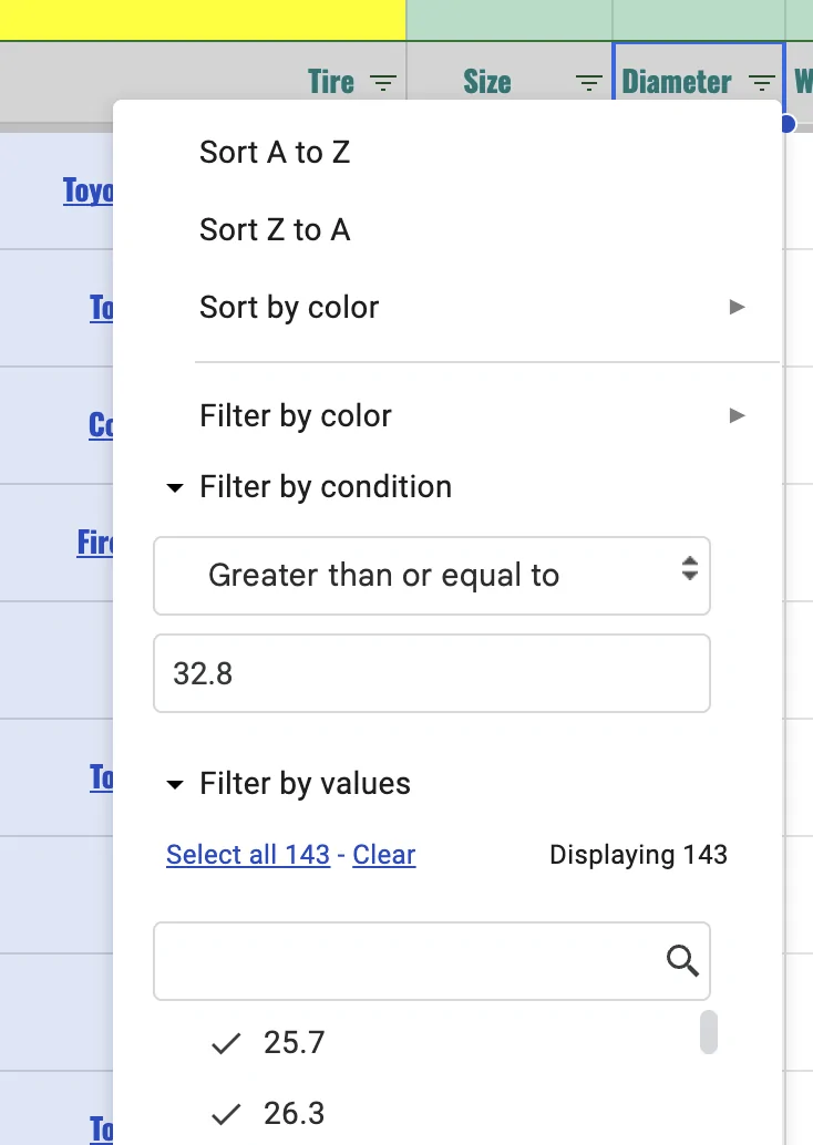

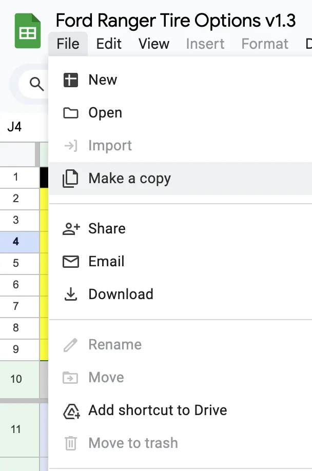

INSTRUCTIONS:
  1. Click on the link below to open google sheets
  2. Go to FIle > Make a copy. Now you can edit and sort.
  3. Modify red cells to calculate combined weights or custom tire dimensions
  4. Filter & sort tires by clicking on the header arrows in row 10

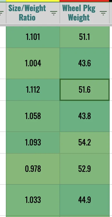

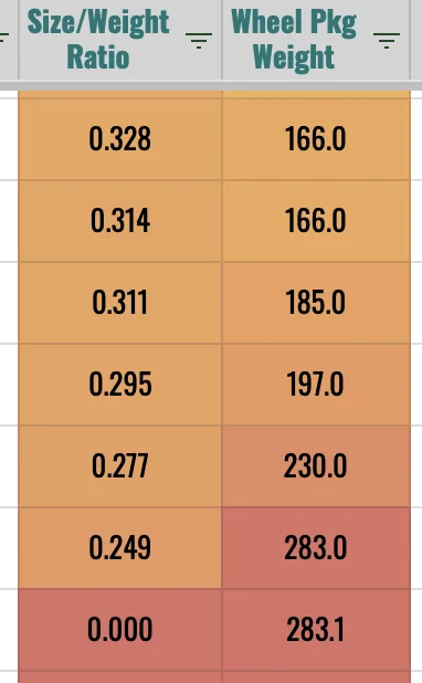

SOME COLUMNS ARE COLOR CODED BASED ON WEIGHT
"Greener"
means a lighter setup
"Redder" means a heavier setup
Ford Ranger Ranger 6G Wheel Calculator 1764324844422-bm
Ford Ranger Ranger 6G Wheel Calculator 1764324726030-pg

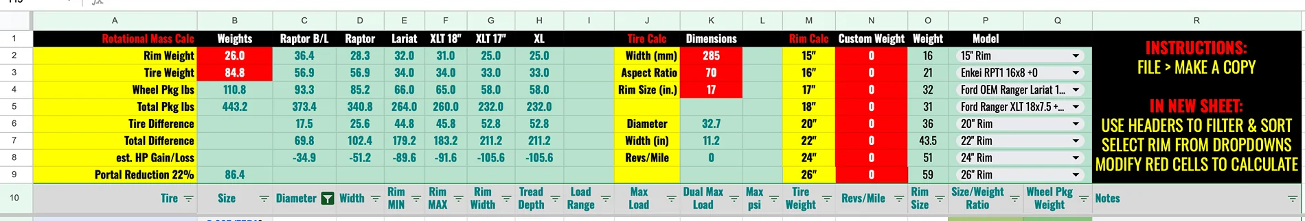

v1.3 CALCULATOR ADDITIONS
  • Rotational Mass
  • HP Loss\Gain
  • Wheel package weight
Users can now calculate the best combined wheel package weight for rims 15"-26" with all matching tires.

v1.4 RIM SELECTOR ADDITIONS
You can now choose rims from a drop down for various sizes and the sheet will auto magically calculate the wheel package weight for any tire that will fit on the rim!!! If you want to use a custom weight, simply change the custom weight field in the Rim Calc

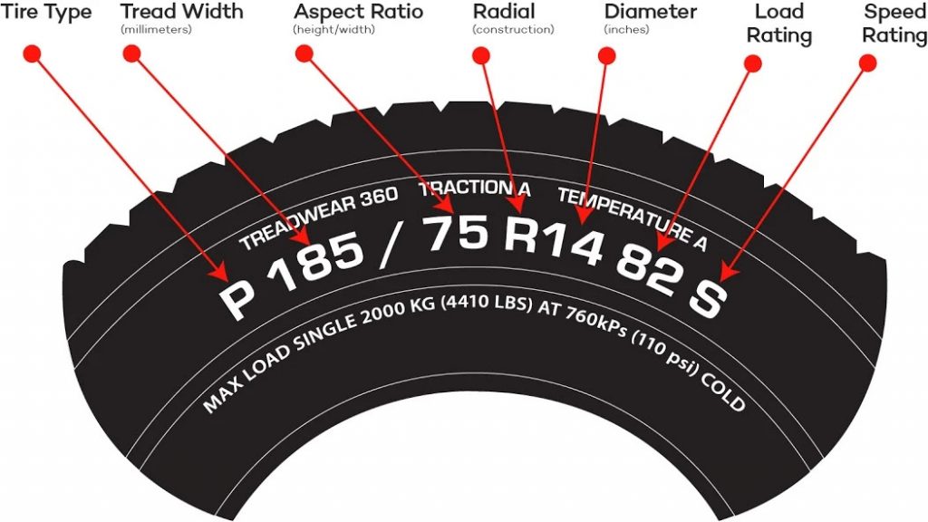

Tire Code Cheat Sheet
When tire shopping these codes help you figure out what the hell you are buying
Ford Ranger Ranger 6G Wheel Calculator Tire-code-1024x576
Here's the coding breakdown for a suitable 6G Ranger 35 inch tire:
P 315/70R17 128/125S F RWL
P - Tire Class
  • P: Passenger Car
  • LT: Light Truck
  • C: Commercial trucks
  • ST: Special Trailer
  • M/C: Motorcycle
  • T: Temporary (spare tire)
  • XL, HL, or Reinforced: Tires with a higher load capacity than normal for their dimensions
  • KO: 'Key Benefit: On and Off-road' - Versatility in both on-road and off-road conditions
  • KM: 'Key Benefit: Mud' - Enhanced traction and durability in muddy environments
  • KX: ‘Key Benefit: Extreme' - Enhanced performance in extreme wet and dry conditions
  • KT: ‘Key Benefit Toughness’ - Enhanced traction and durability
315 - Section Width (tread width)
  • Nominal width of tire in MM
70 - Aspect Ratio
  • Ratio of the sidewall height as a percentage of the section width of the tire.
  • To calculate Total Tire diameter:
    • calculate twice the sidewall height (2 * width * aspect ratio)
    • convert to inches, then add rim diameter
    • In our example: (2 * 315 * 0.7 * 0.0393701) + 17 = 34.36 inches
R - Construction
  • R - Radial
  • B - Bias Belt
  • D - Diagonal
  • Omitted - cross ply tire
17 - Rim Diameter
  • Rim size the tire was designed for (inches)
128/125 - Load Index and Range
  • 128/125 = 3968/3638 lbs
  • The 2nd lesser number is the load rating for a dually configuration (in case of a blowout)
  • Load index rating can be looked up at tirepressure.org
S - Maximum safe tire speed
L75 mph120 km/hOff-Road & Light Truck Tires
M81 mph130 km/hTemporary Spare Tires
N87 mph140km/h
P93 mph150 km/h
Q99 mph160 km/hStudless & Studdable Winter Tires
R106 mph170 km/hH.D. Light Truck Tires
S112 mph180 km/hFamily Sedans & Vans Tires
T118 mph190 km/hFamily Sedans & Vans Tires
U124 mph200 km/h
H130 mph210 km/hSport Sedans & Coupes Tires
V149 mph240 km/hSport Sedans, Coupes & Sports Cars Tires
W169 mph270 km/hExotic Sports Cars
Y186 mph300 km/hExotic Sports Cars, Track & Competition
(Y)186+ mph300+ km/h
F - Load Range and tire ply rating
  • A - 2 ply
  • B - 4 ply
  • C - 8 ply
  • D - 10 ply
  • E - 12 ply
  • F - 12 ply
  • G - 14 ply
  • H - 16 ply
  • J - 18 ply
  • L - 20 ply
  • M - 22 ply
  • N - 24 ply

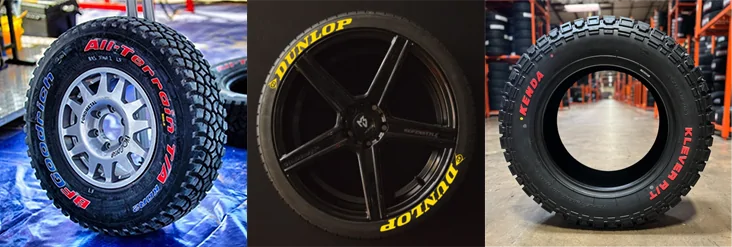

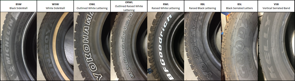

RWL - Lettering Designation
BSW\WSW\OWL\ORWL\RWL\RBL\BSL\VSB
Ford Ranger Ranger 6G Wheel Calculator 960px-Examples_of_different_tire_sidewall_markings
Some mfg may also have special color codes. For example RRL (raised red lettering)

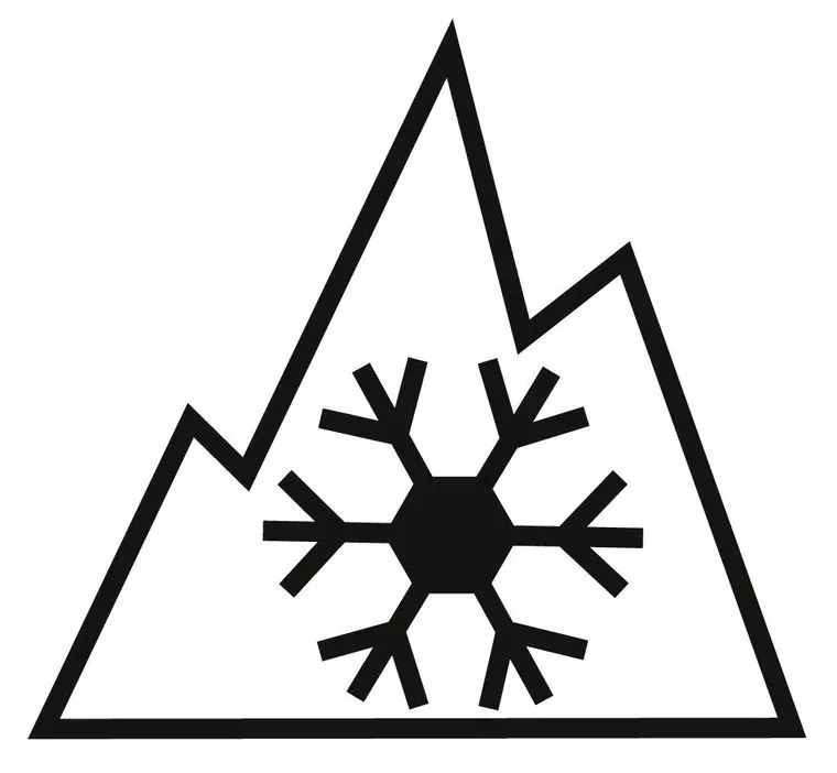

  • 3PMSF
    • Three-Peak Mountain Snowflake
    • Ford Ranger Ranger 6G Wheel Calculator 1761942465613-kz
    • USTMA and RAC certified to meet severe snow service requirements
    • Able to exceed snow traction beyond a M+S branded tire
    • Unable to match traction and ice performance of dedicated snow / winter tires
    • Certification on medium-packed snow only. Braking, turning & ice traction not tested
