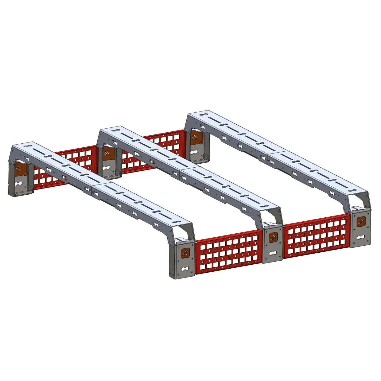

Hey everyone,
After a lot of discussion, feedback, and real-world use cases shared here on Ranger6G, we’re excited to officially release our Ford Ranger & Ranger Raptor 10" Tall Bed Rack RAIL System.
This product exists directly because of the conversations in this forum around bed racks, roll-up tonneau covers, and the need for more clearance for certain cargo setups.
Why we built it
Many Ranger owners running roll-up tonneau covers like the BAK Revolver were being told that bed racks simply were not compatible. At the same time, some builds needed more vertical clearance than a low-profile rack could provide.
Instead of forcing compromises, we designed a taller version of our Bed Rack RAIL System that:
  • Clears roll-up tonneau covers like the BAK Revolver and similar designs
  • Provides additional height for taller cargo
  • Retains the same modular foundation as our standard rack system
Key details
  • 10" tall configuration
  • Bottom of rack sits 212 mm (8.35") above the bedsides
  • Top of rack sits 265 mm (10.43") above the bedsides
  • Uses the same cross rails as our standard Bed Rack RAIL System
  • Fully compatible with existing American Adventure Lab accessories
  • Designed, manufactured, and assembled in the USA
If you already own our standard Bed Rack RAILS, we also offer the 10" risers separately so you can convert your existing setup instead of replacing the entire rack.

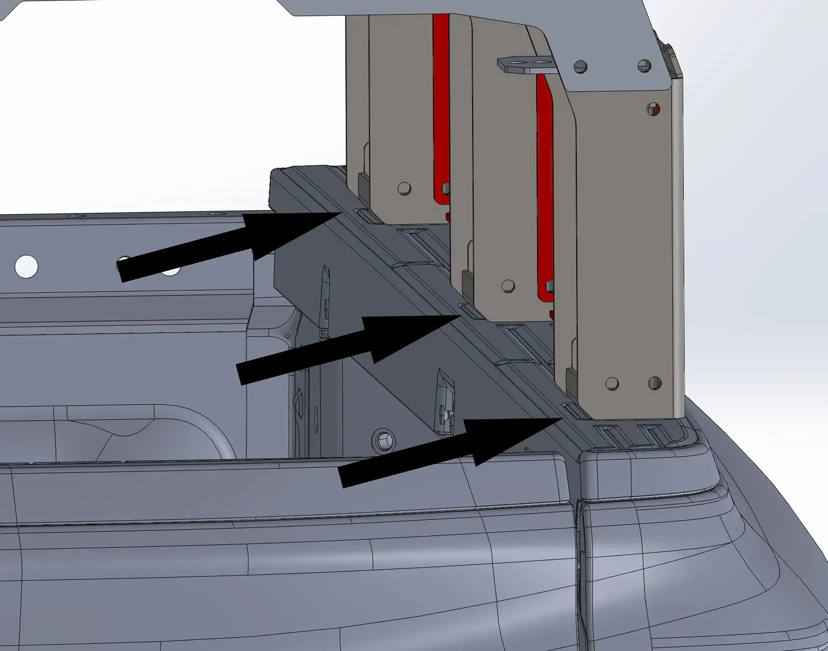

I guess the next step is something to get it or separate support above the roof line for a canoe, sup, surf board, lumber, pipe, ladder, etc?
and do you have a side view of how much of the rail is covered?
that was the issue with the angled support covering too much of the rail so it interfered with the tonneau cover on the rail.
which I am pretty sure you fixed with this design.
and can you run a cable up through the bed rail through the bracket for lighting or a radio antenna?
I would be open to either way (separate attachment to get items above the roofline or new/taller risers. I'm a little concerned that if we just made taller risers that these crossrails would be too long. They work well at this level, but I'm not sure they would work well (they may be too long and stick out from the sides too much, visually) that high at the roofline. So, that may force the new riser system to be an attachment. The cool thing is that if we did it that way, it would also work for the low rack as another level of attachment surface. Might be some interesting things to come out of that.

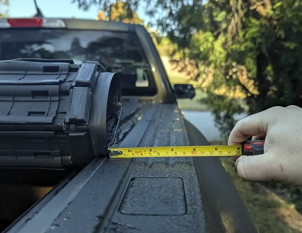

You're correct to question the bedside coverage. I did design around that. Here are a couple of images to help show what is different about these risers vs the low profile risers.
Huge thanks to @clarke for going to the trouble to get these measurements. It was crucial in getting this to market without having a truck w/ tonneau in the shop.
If you'll notice in the rendering below, special provisions were made to chamfer the bottom of the legs and shorten the mounting component (that sits between the outside flanges of the risers) to more than accommodate the sealing flange of the tonneau cover. You can just see the edges of the covers for the attachment holes poking out below the inner edges of the risers and in the photo from @clarke those caps are fully visible outside of his tonneau cover.
As for running a cable through, unfortunately, Ford did not provide provisions for that. There are only two holes in each of the mounting points. We have to use both holes for longitudinal stability. Running wires will be up to the customer to figure out based on the tonneau cover they have. Usually, you can run the circuits behind the cab and up the front end of the rack eliminating the need to go through the bedside all together.
