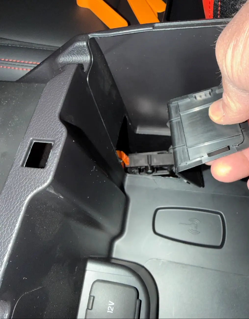

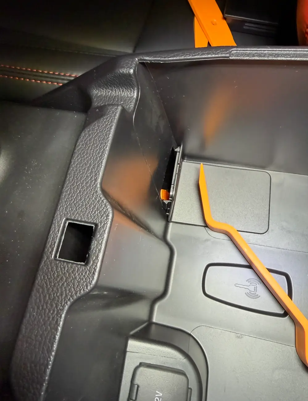

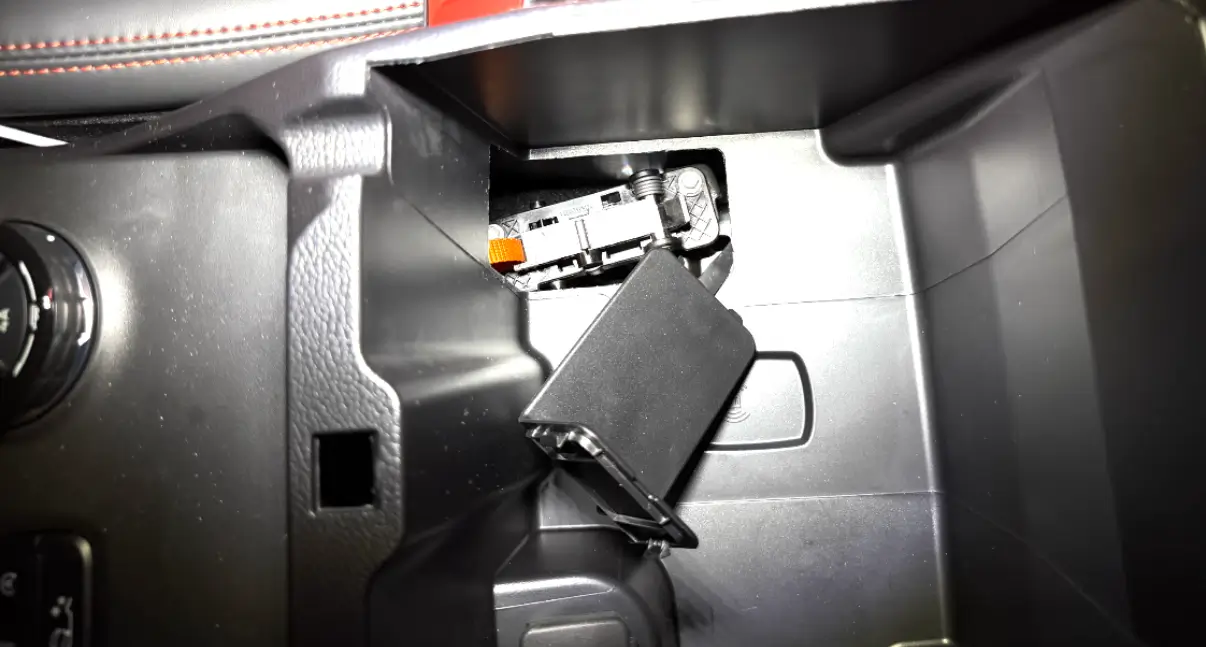

Did you try the canvas latch in the center console? Only way to put in neutral without battery power I think.
I removed the cover, and pulled the latch while I was reading the manual.
Ford Ranger '26 RR - How Do I Shift From Park To Neutral With The Engine Off? IMG_3039
Ford Ranger '26 RR - How Do I Shift From Park To Neutral With The Engine Off? IMG_3040
Ford Ranger '26 RR - How Do I Shift From Park To Neutral With The Engine Off? IMG_3041
After performing some other tasks, the manual then instructed me to unhook the battery terminals, etc to put back to stock. It’s at that point that I stopped.
Why? Because all I want to do is push the truck two feet in my garage without starting it.
I’m not going through all that. There has to be an easier way.
What if: Say I thought I had an engine problem. I shut the truck off and didn't want to harm the engine any more. A flatbed tow truck came. How are they going to get it on the flatbed? Do you know these procedures?
Yup I was sucking oil from the dipstick, regular oil change. I went too far and the plastic tube got stuck deep in the engine.
I put the truck in acc mode to remove electronic parking brake.
I unhooked the negative (almost always 10mm...) and put a wood block on the wheel while waiting for the tow truck.
I put it in neutral with that latch.
Then with a screw driver, you pull on the locked latch to remove tension and push on the pin. You re-engage Park by doing so.
That's how you tow the truck as well with another truck in the wild...
But when you plug the battery back the truck will auto flip in park.
Super easy to unhook the negative terminal. I do it often for electrical work (aux, audio, etc...)
